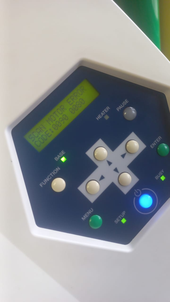

Good day kindly assisst me, I have Roland sp540i, it has stopped working and showing error code scan motor error 0090 and 0080 what could be the problem
damonCA21
Normally a failed or failing scan motor. The only real option is to replace it. Try and get an OEM motor though, not the generic cheap chinese ones
Joe House
Sign Equipment Technician
When I see scan motor errors, I always try cleaning the encoder strip first. Use an alcohol wipe or a lint free cloth with isopropyl alcohol. Costs nothing and more often than not solves the problem, especially if it errors out in the same area every time.
Good luck
damonCA21
Good luck
Scan motor errors on startup generally aren't caused by a bad strip. A bad strip will throw up other errors or give cuts in the wrong position.
