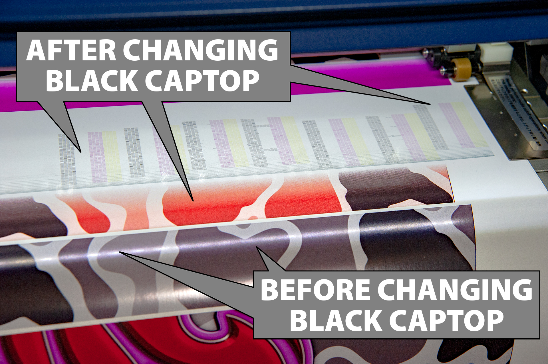

After changing my CYAN damper I am not getting any CYAN to print.
I have checked the two print head fuses with a multimeter and they are both good, and I have been told because the BLACK is printing which shares the same fuse, is another indicator the fuse is good.
I can draw CYAN ink from the bottom of the damper with a syringe.
I have changed the second from the left printhead ribbon cable (thinking it is the CYAN cable)?
I have done many cleaning and still, no CYAN is printing.
