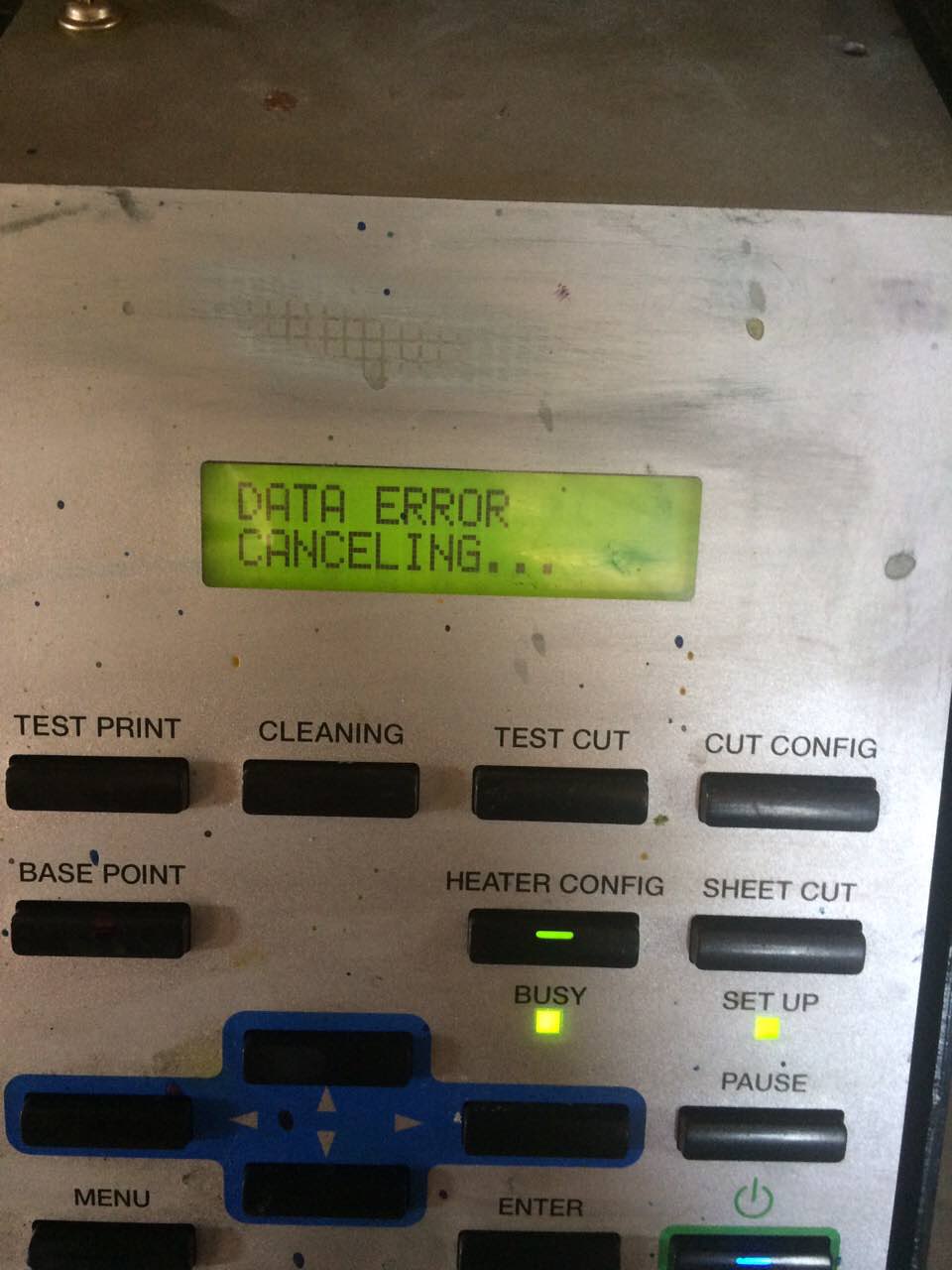

When i placed mainboard sp300v in sp 540v , All settings I did it ,
But When i sending something to print the printer view (DATA ERROR CANCELING)
I think I should change the (SYSTEM SWITCH)
When you first plug the cable into a sp300v and then put it in SP540V the versaworks veiw
The printer is incorrect but i can print

Hey muhanad,
Based on your description, it's strongly suggested that you call your authorized Roland dealer to have the main board flashed, so it can become compatible with the SP-540v. Just taking the main board from the SP-300v and putting directly into the SP-540v (without flashing) it produce the date error you're receiving. The dealer will take the lead and help you.
Take care,
Roland Technical Support
Roland DGA Corp.
