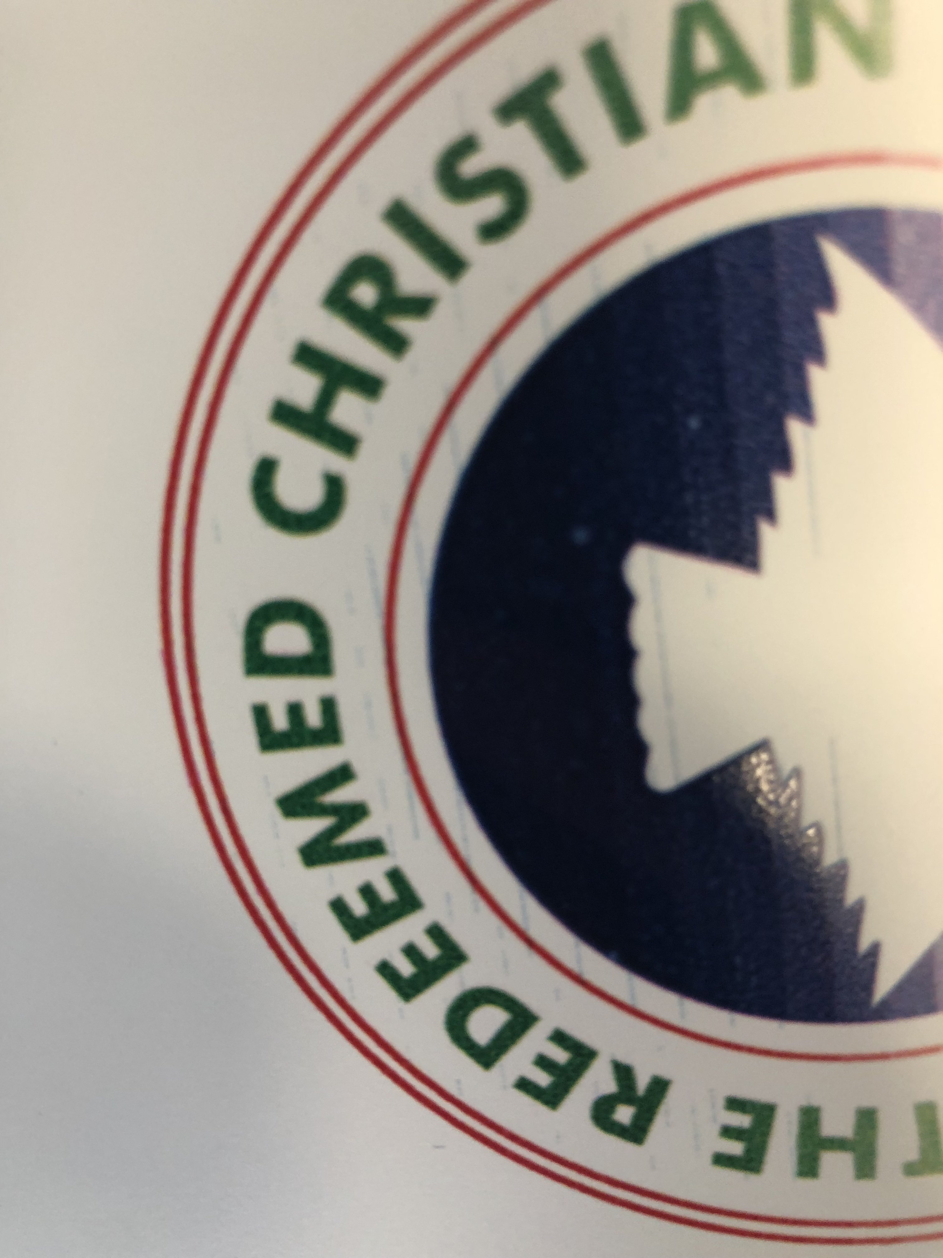

Can somebody help me . When I print Will print some blue lines around。

Looks like it's dragging a hair or some fuzz on the head. Clean it up with some cleaning solution and a non lint swab. Or it could be the material is buckling up and lightly hitting the head.
