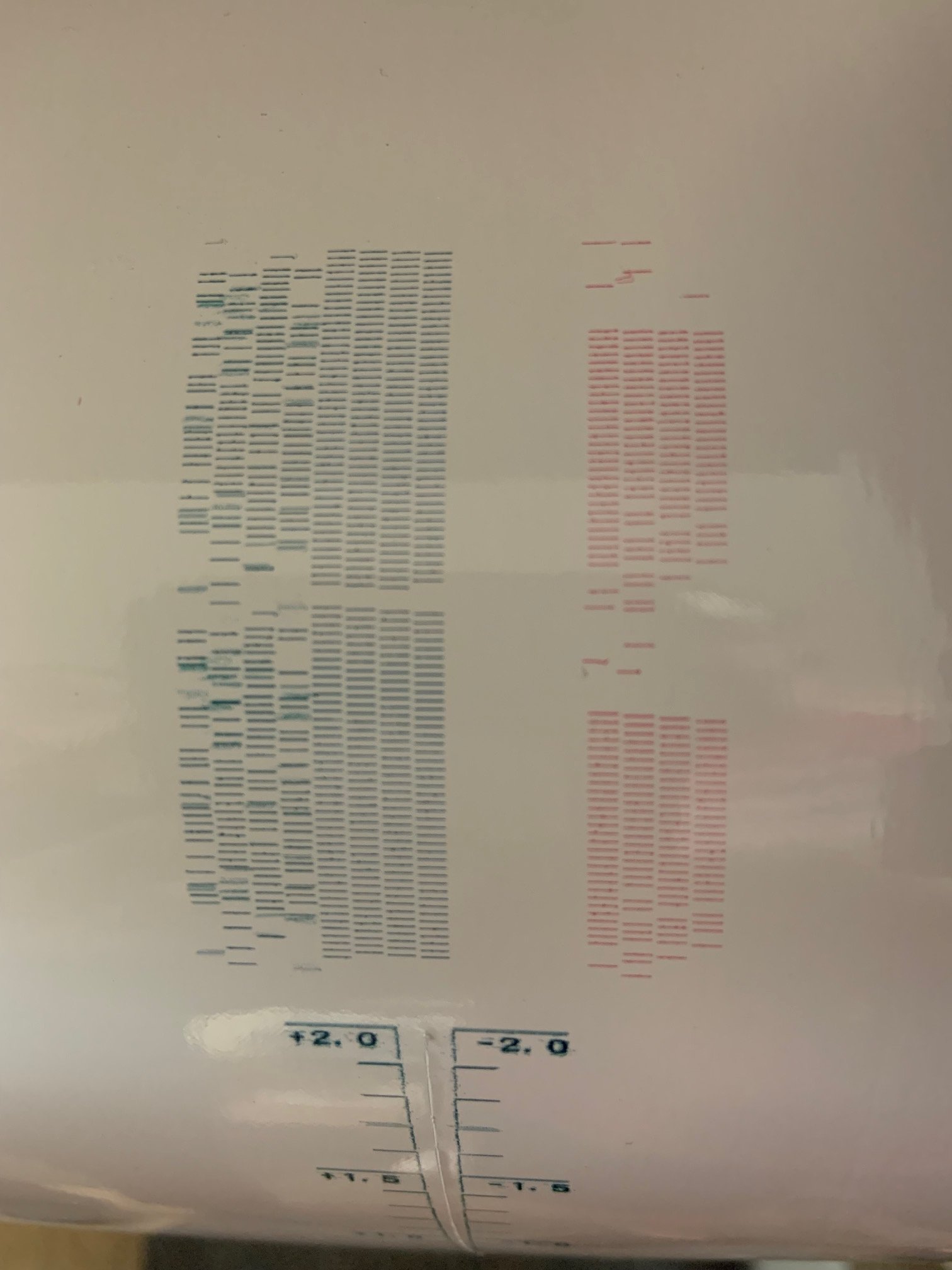

Here's a test print before I start disconnecting any hoses. Can you tell by this what might be the problem?

Terry01
The heads require a longer soak before you attempt to pull any more ink through. Those heads need
to be wet for a good 12 hours if you want to have any chance of recovering them.

Is that test print is before soaking or after? Cose, looks like capps are 100% for replacing and maybe dampers when you servicing all. Watch out not to shortcut head above with splashing ink. Then you gonna burn motherboard, to be precise, fuse and several transistors. Do a test print after cleaning with syringe under caps. I have one Sp working more than 10y with same heads :)
