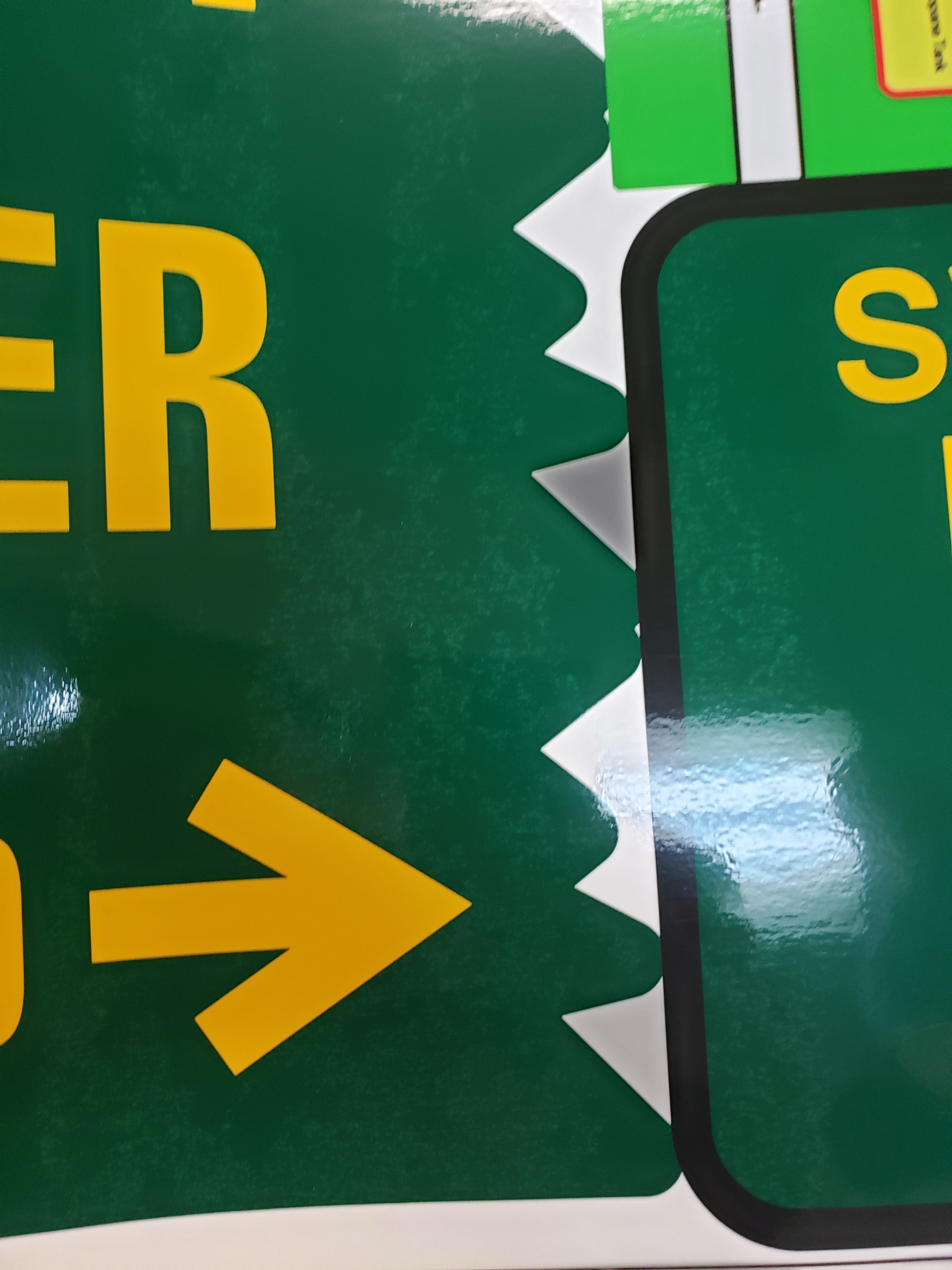

I am having issues printing on Avery MPI SC-1105 using the Roland TrueVis VG2-640. We have had this printer for almost 2 years now and so far the issue that we have is with the 1105 material. The darker colors seem to not be drying by the time the material is rolled up. The image that I have provided shows and example of what happens. I have the heater and the dryer on the printer at max, the head speed is at 1016, and the room temp is at a constant 68 degrees. I have it on a 10 pass, I did change it to a 9 pass at one time and that created another issue where in solid colors there would be a light banding. We have another Roland Printer that is older and we never had this issue with the 1105 material.
I did ask the person who services our Roland what it could possibly be and his response was "I've never heard of any issues with 1105 before. Turn the dryer to max." With the profile that I have all the inks are at 100% and when I go to Roland profiles, all the profiles that I can find for the material has the same percentage.
I am at a lost and would like any advice that you can give me. the Ink that is being used is TR2 ink for the Roland TrueVis printers.

I'm going through the same exact issue and have tried bumping up the heat as well with no luck. Tried many different profiles and also reduced the ink levels. This is also happening on other materials and not just Avery. I tried Arlon SLX+ material with slide technology and it did not work. Vinyl was very tacky at initial install.
Right now we print a wrap and wait a couple of days before laminating. Once laminated the vinyl is still tacky while trying to install. Wraps take much longer than they used to. Thankfully my distributor is putting on a external dryer to see if that solves the problem.
I'm thinking they must have changed the ink formula because whatever they have done is not working for us. Roland says they aren't aware of any issues which is mind boggling and that I would be the only one with this issue. I'm almost at the point of buying a HP latex printer.

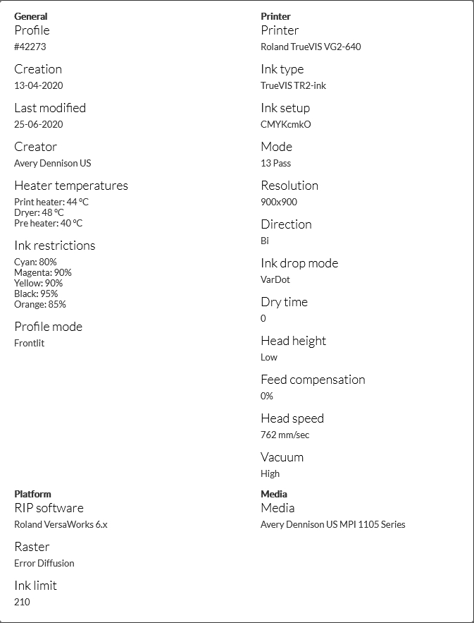

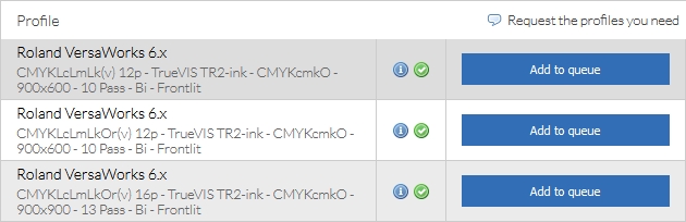

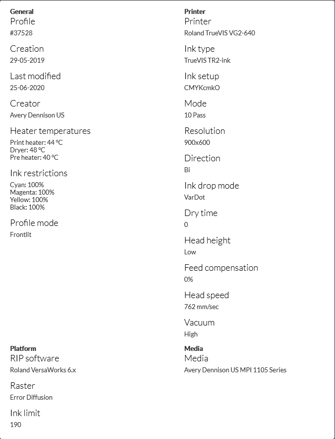

I did end up making my own profile for the 1105 material. I used the the specs from the profiles provided by Roland to help me with it. Since there was 3 profiles available through Roland I compared the three. All three had more passes than the one I made up. One didn't have the option for orange ink, the other had 100 percent for all ink, and all three of them have more passes than the one that I have been using, and the Dryer is as a lower temp.
If I lower the percentages of the ink wouldn't that essentially change the color that is being laid down in the long run? We will be contacting Roland and our sales person to see what we can do.

We already tried lowering ink limits without any success. You have to copy an existing profile and rename it in order to change the ink limits. I think we lowered it by 20% and it was the same as before.

Whatever RIP you(LarryB) use, there are four elements to how ink is laid down:
1. droplet size(usually 3 per channel with epson heads)
2. relationship between light inks(LC/LM/LK) and full tone inks(C/M/K) as to where the light ink stops and the full tone begins
3. per-channel ink limits, meaning for example based on VG2-640 with no white, including orange- CMYKO
4. total ink limit
Your experiment(Billings Sign Pro) was with the total ink limit, which usually is involved only with CMYK, but may
also include extended gamut inks(O) depending on the RIP. It is likely that you would still experience
the excess inking. Changing the total ink limit will definitely affect color- any change to any one of the
four variables I mentioned does require making a new ICC profile.
In the end, someone- whether it is you(LarryB or Billings Sign Pro), Roland, a dealer staff person, or a consultant- is going to need
to make a new media configuration and ICC profile to solve this problem.
