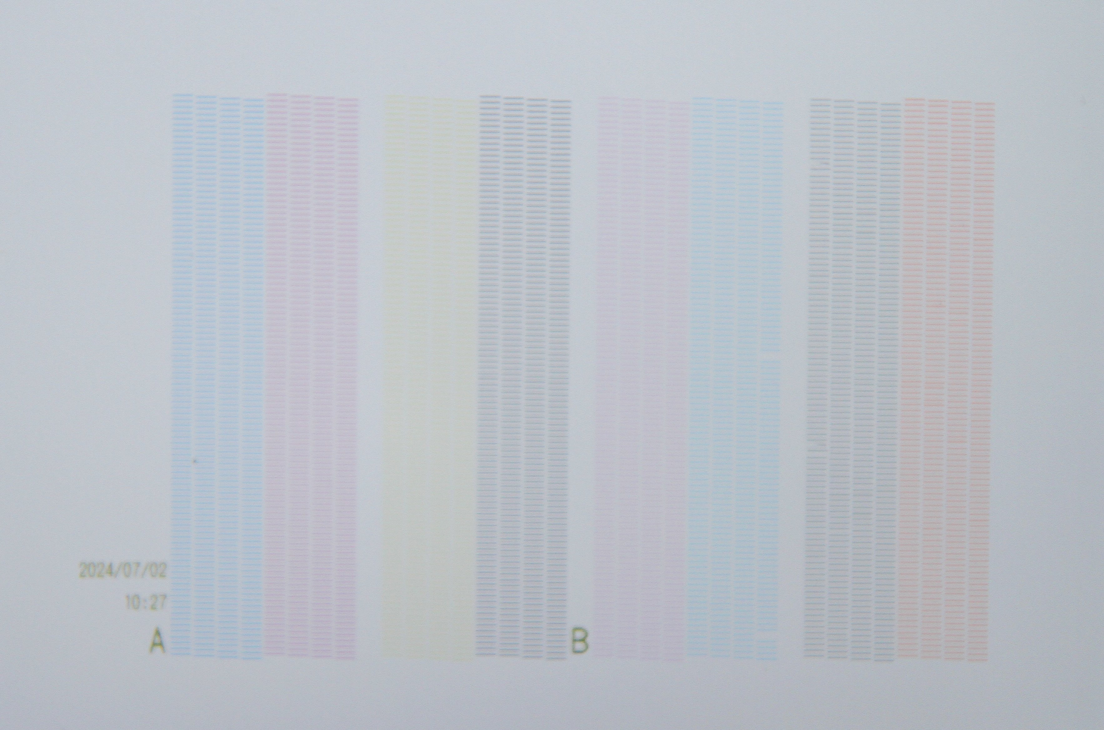

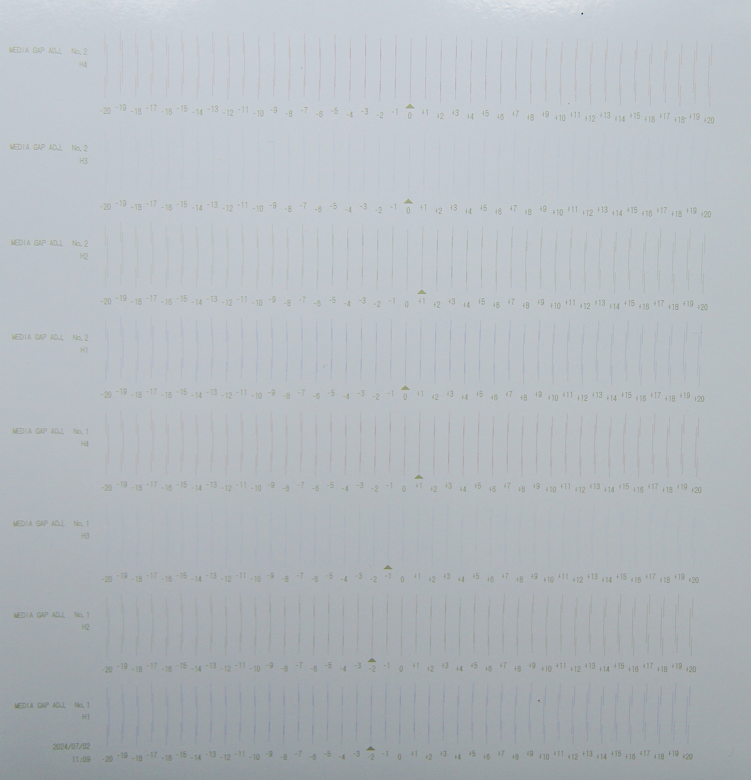

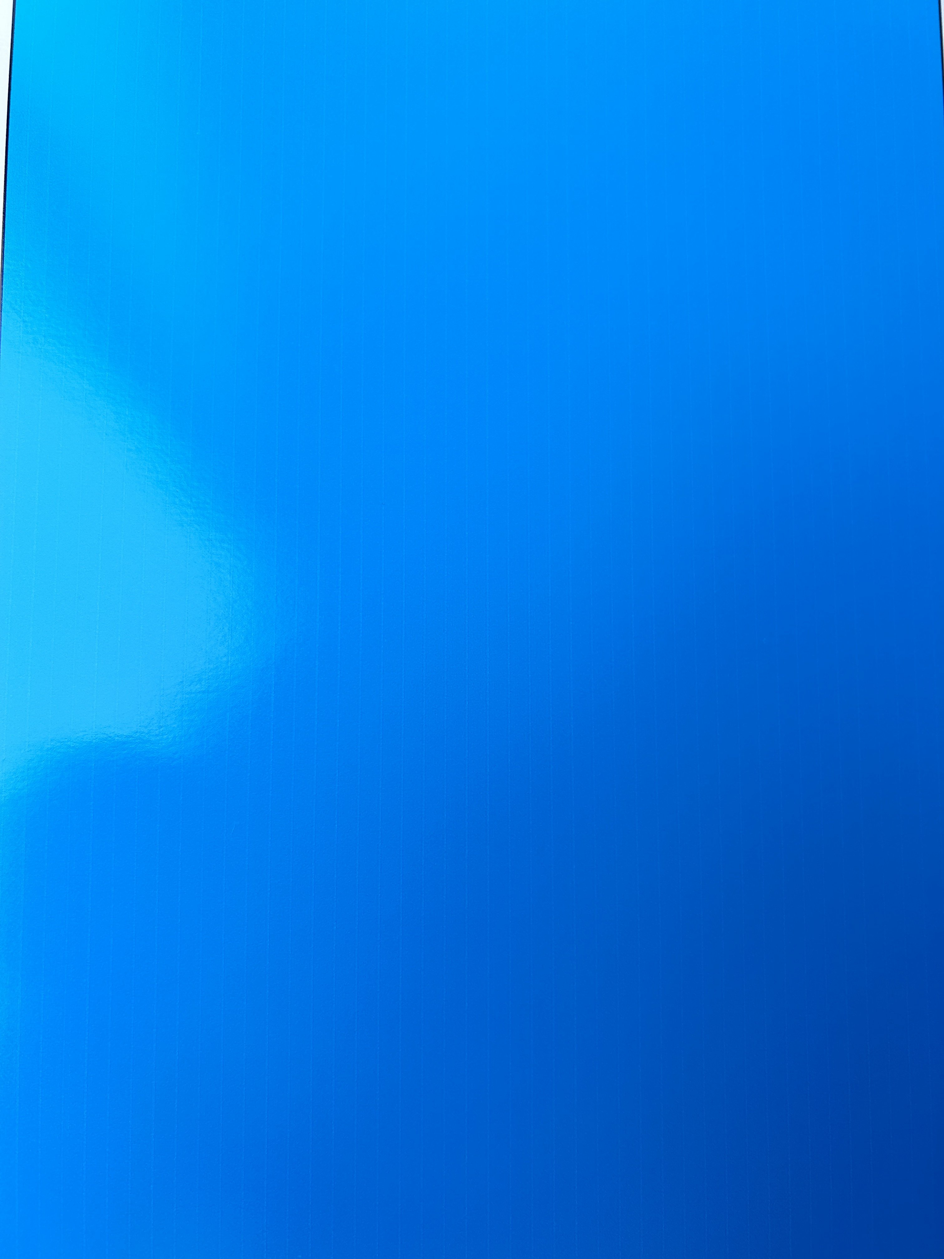

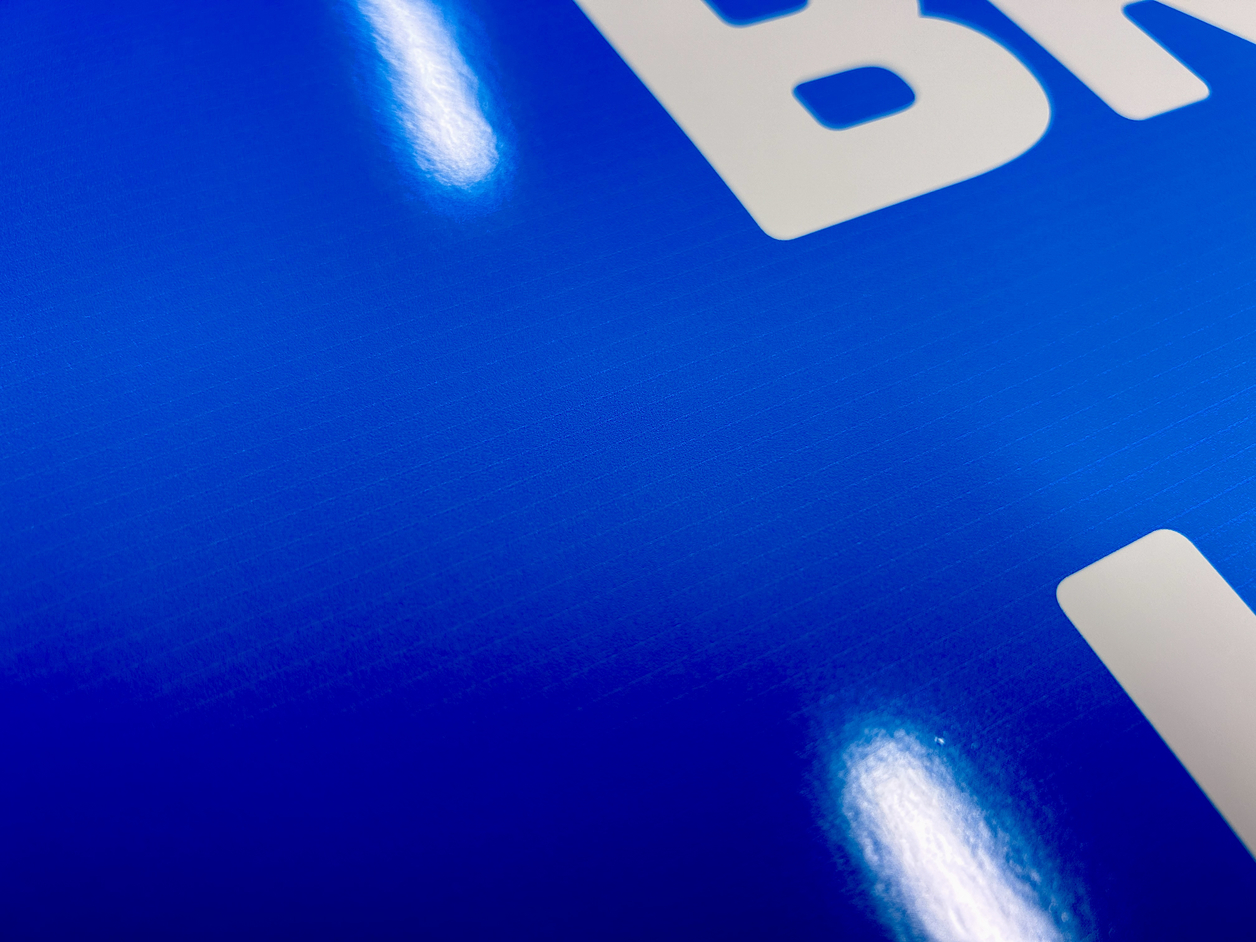

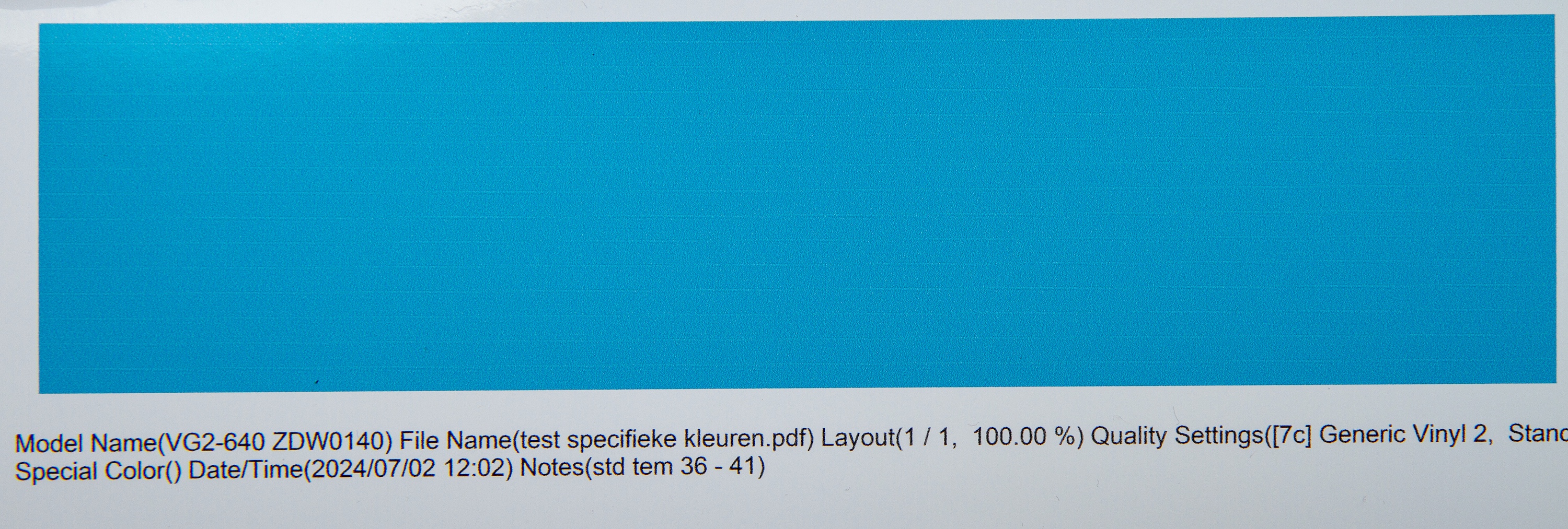

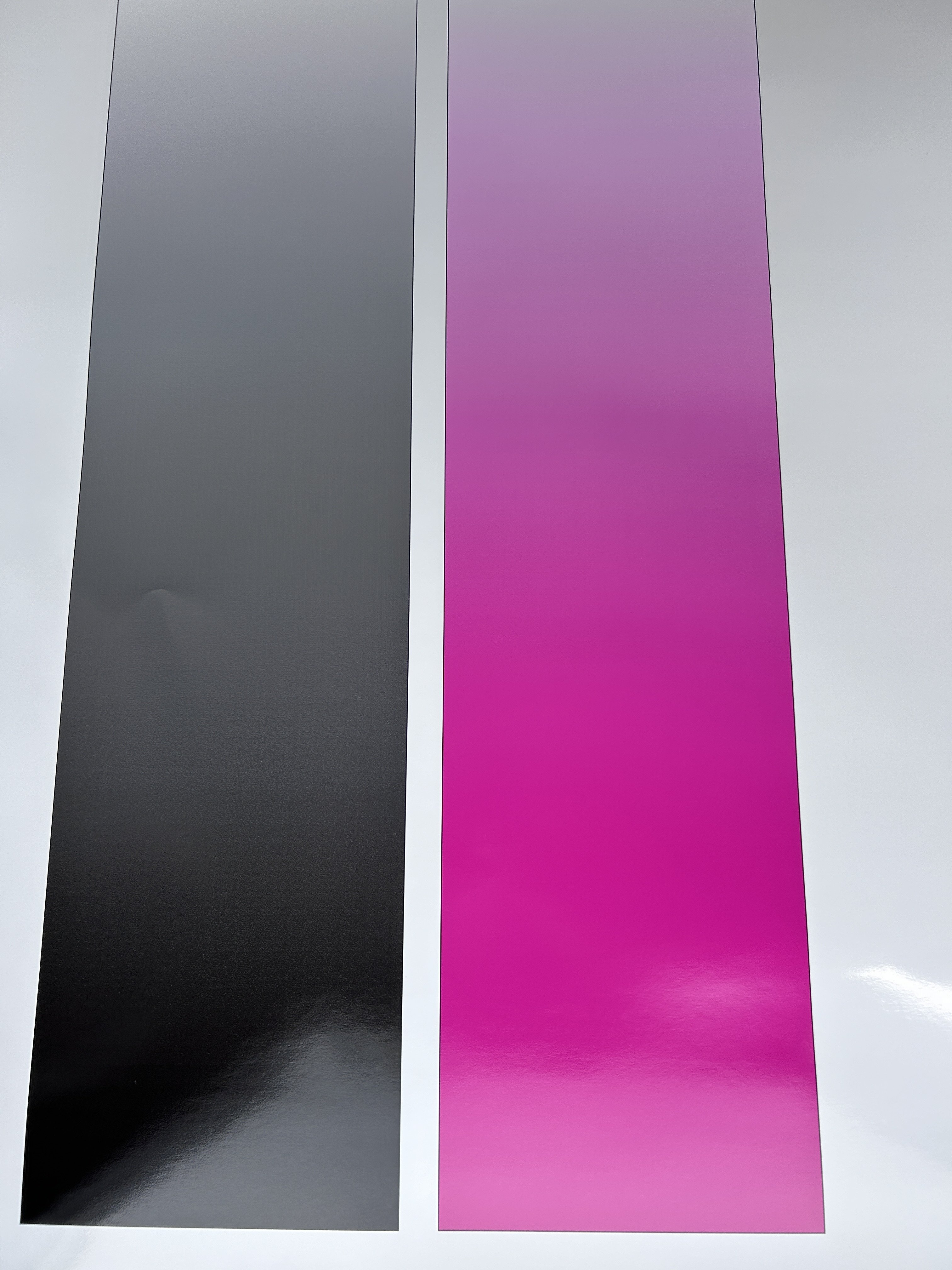

Hi, were having issues with banding on our Roland VG2.
Problem exists in all solid colors and on different media types
See attachments:
- example

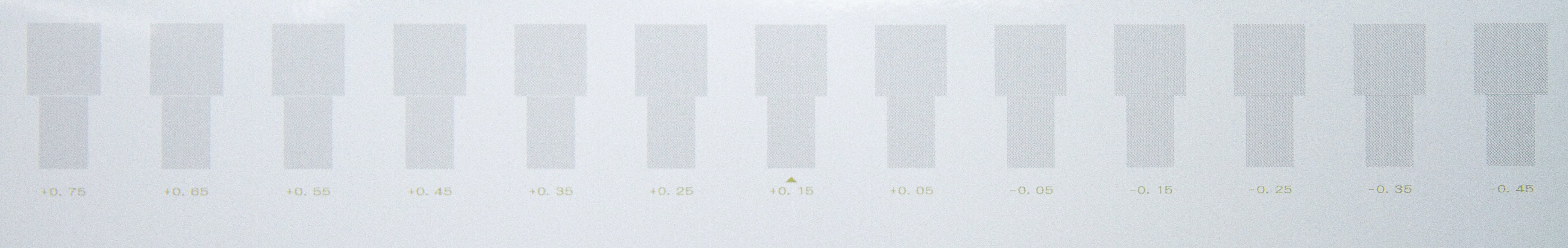

- gap adjustment checked
- calibration checked
- nozzle test checked
What else can we do to resolve this?
Any thoughts?
Thx in advance regards, Jovan

Looking at images you provided I would say it's a feed calibration issue.
It's currently set to +0.15, try changing it to -0.5 and see if that helps?

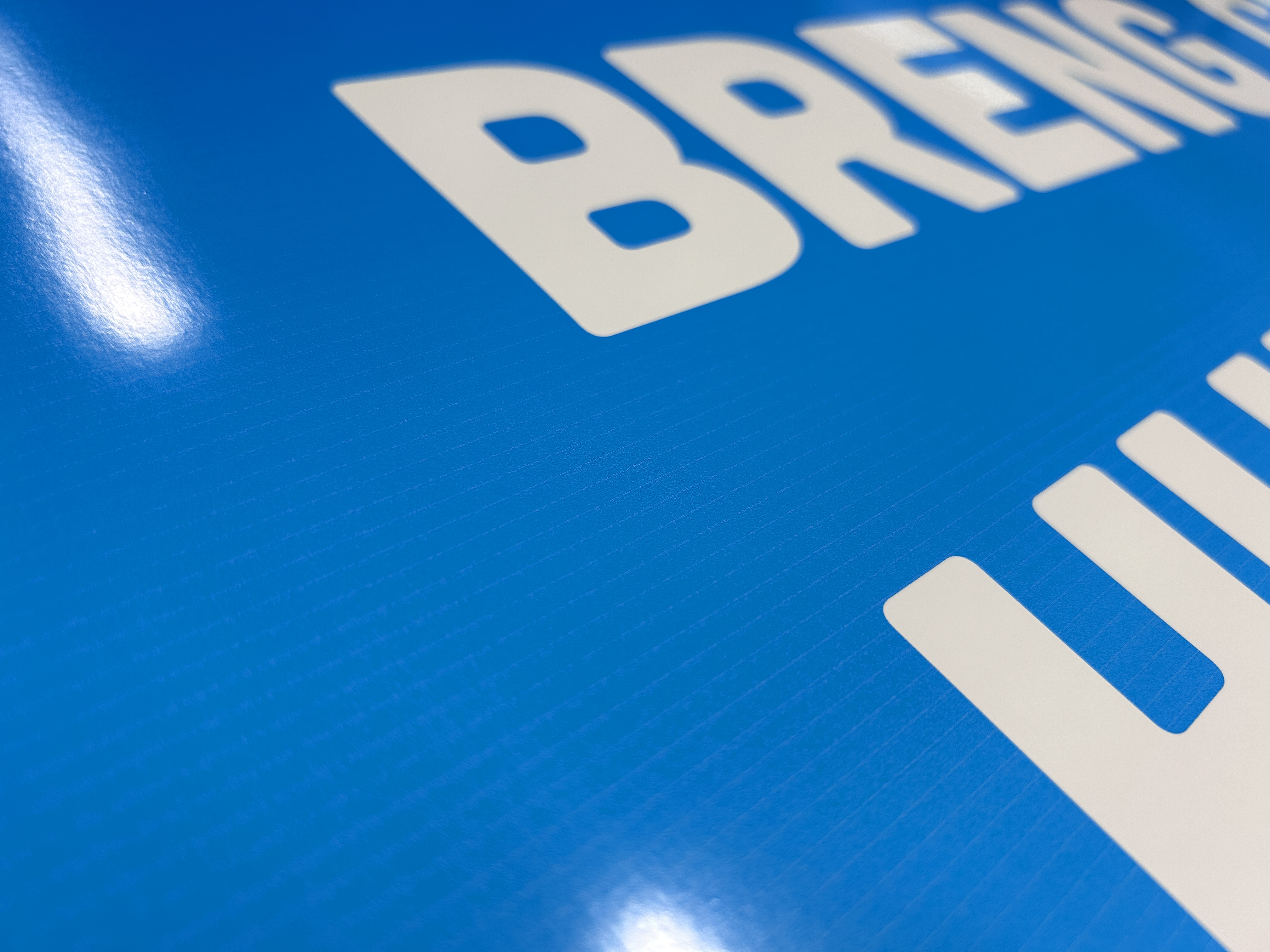

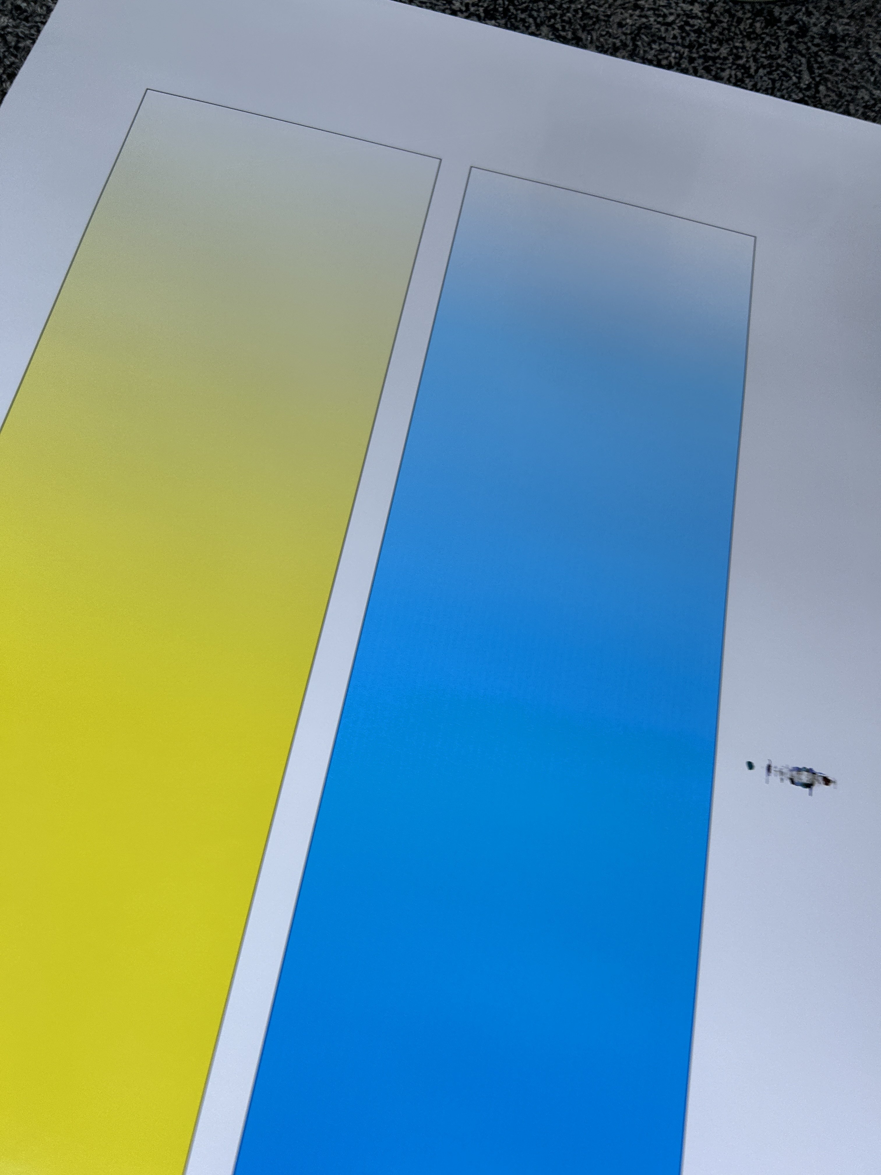

Found and cleande the Encoder strip, no changes. Horizontal banding still the same.
Some more examples attached.

Although the nozzle test doesn't look bad, there are a few deflections and a few missing nozzles, which might be causing trouble. Have you tried doing solid blocks of CMYK with PMS colors and setting them up as Pure 100% of each and seeing if there is 1 color that is worse. From your photos, you're only showing blues, which seems from the nozzle test, one of them with the issues (light Cyan). Do colors without Blues and blacks print okay?

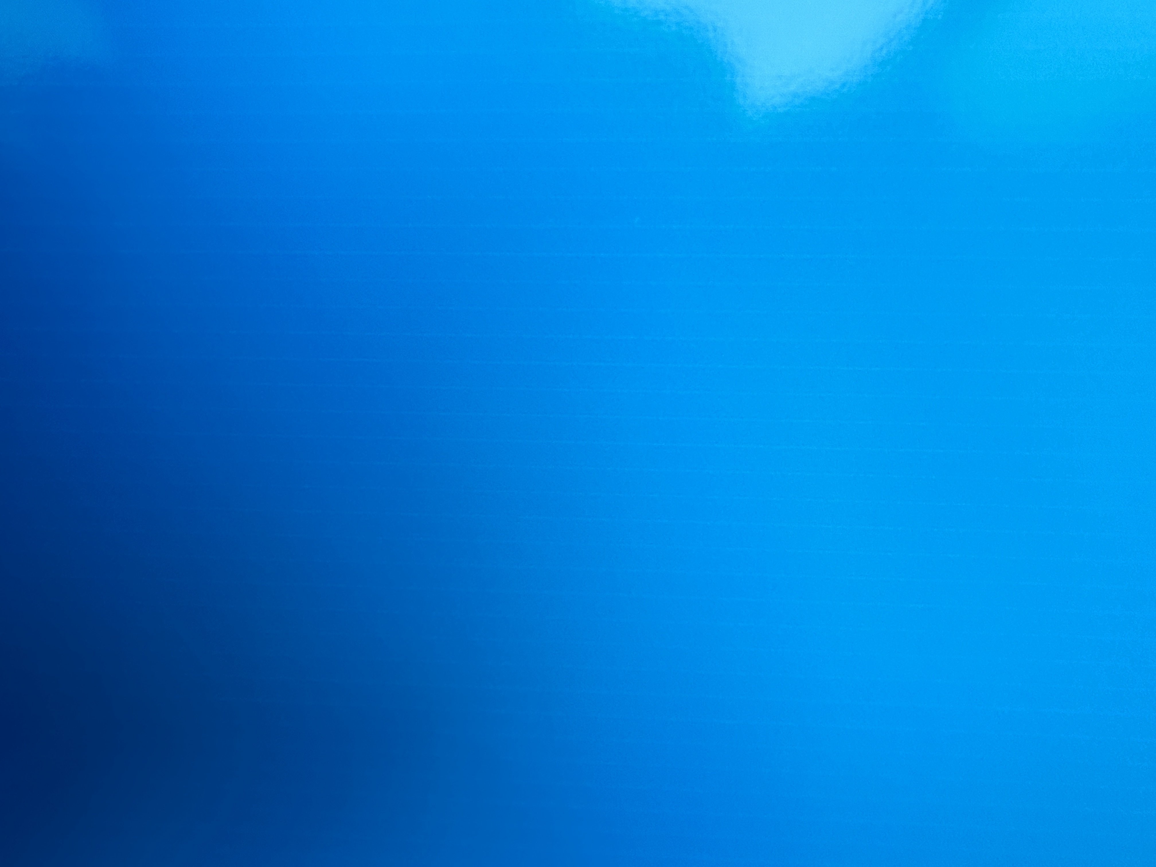

Just tested and indeed it seems only Cyan.
See attachments.
