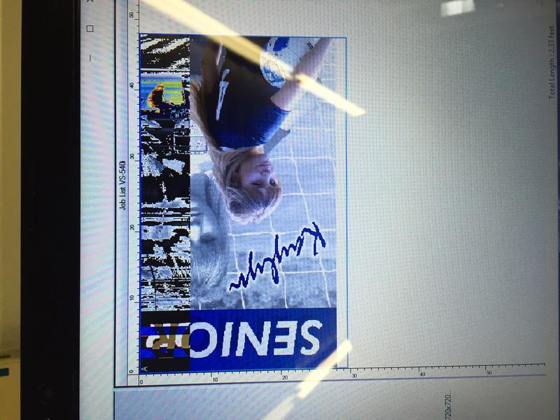

When I import a TIFF file to print - I get a garbled image in the preview as attached. The tiff file shows correct if previewed in any other program. I have re-exported the file a few times and restarted versa works... No Fix. Thanks in advance

I know it will be grainy - I was referring to the garbled area. I restarted Corel and re-exported. Fixed the issue. Thanks for the reply.
