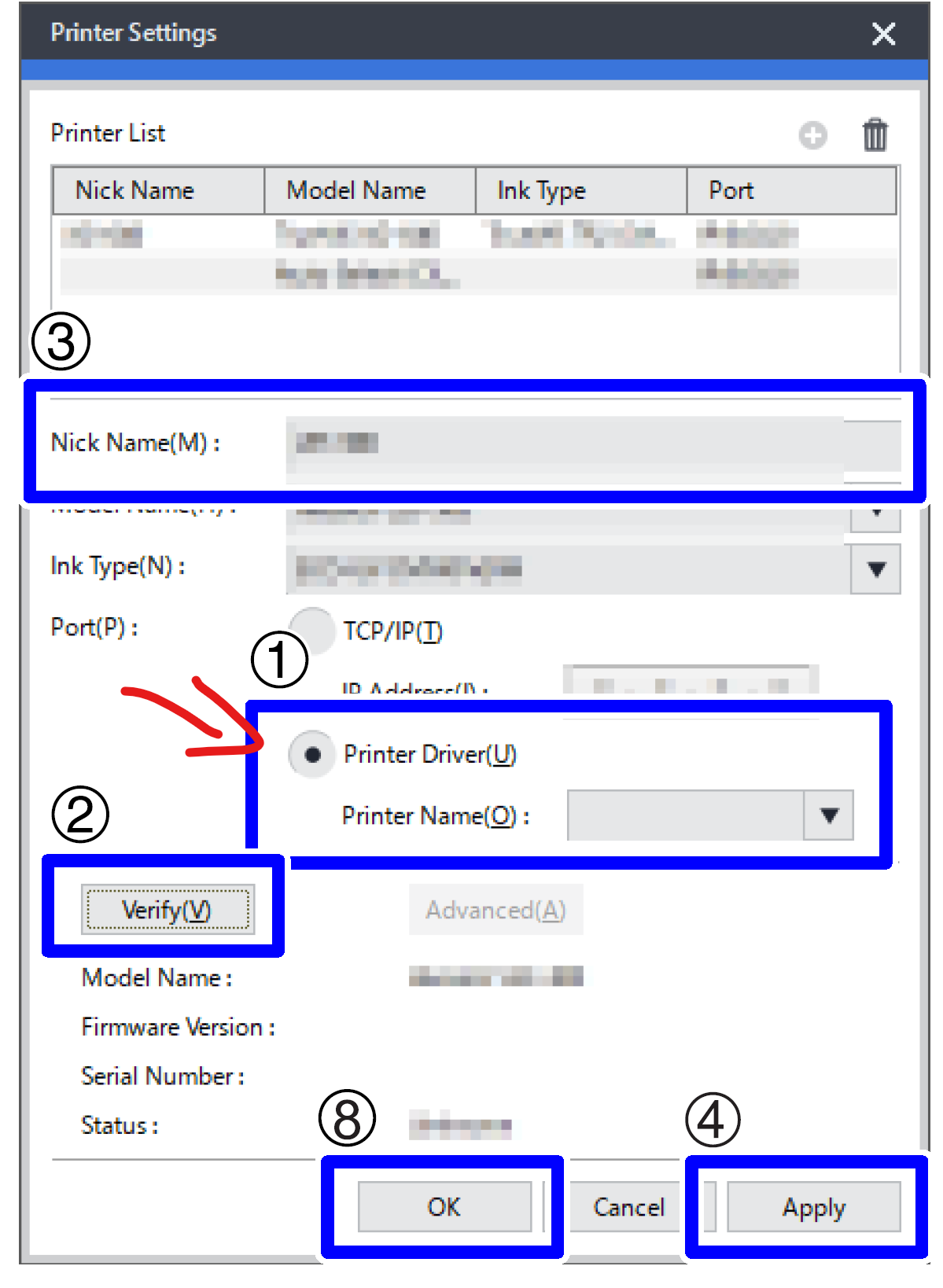

Recently installed VersaWorks 6 and I'm trying to add our cutter but it's not giving me the add by print driver option that is listed in all of the guides - I only have were an IP can be entered but our cutter is not connected through our network. Does anyone know, is there an option or something that needs to be turned on somewhere to allow for the printer driver option, it seems strange when it's in all the guides but not in the actual program by default?
