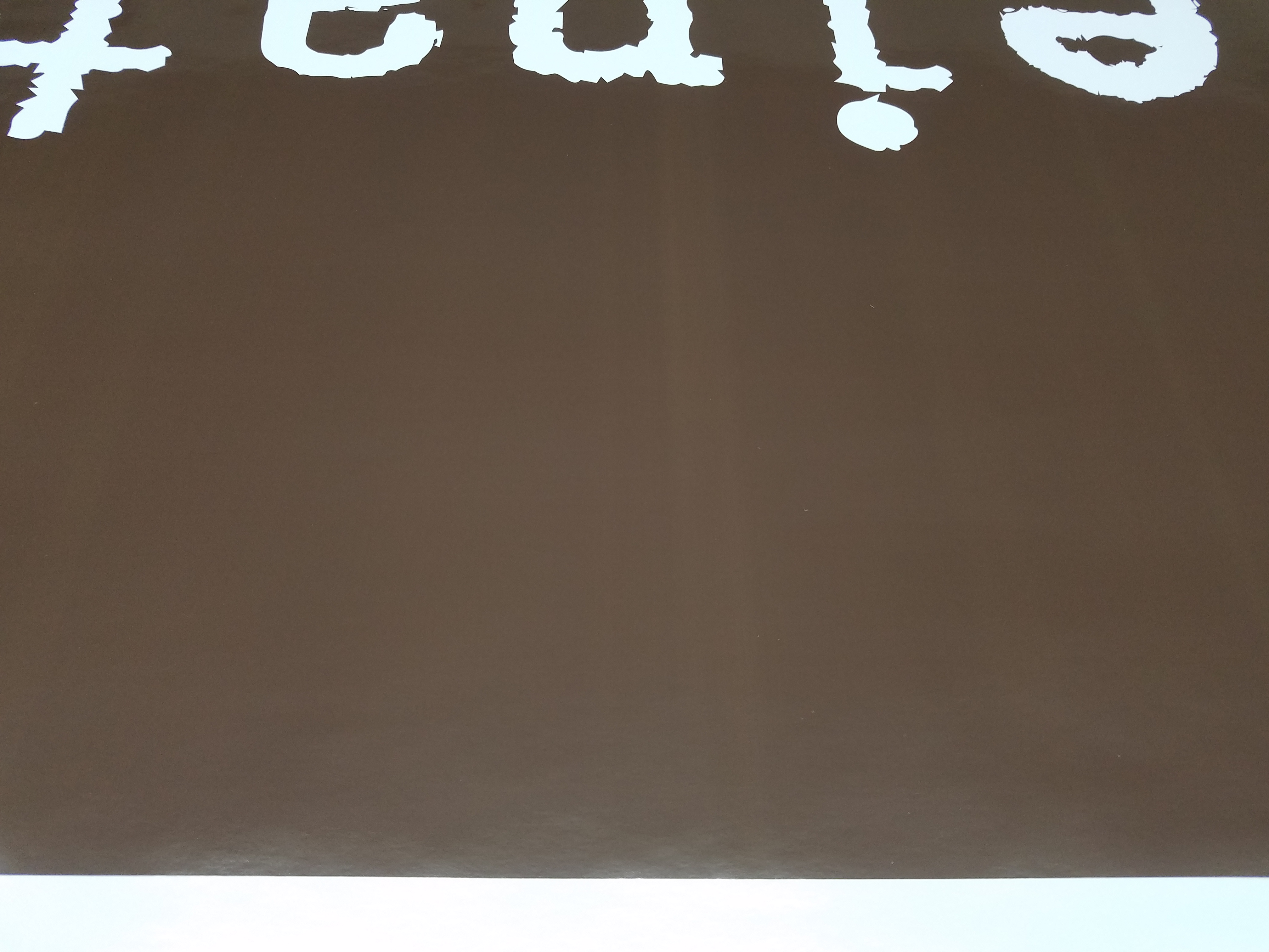

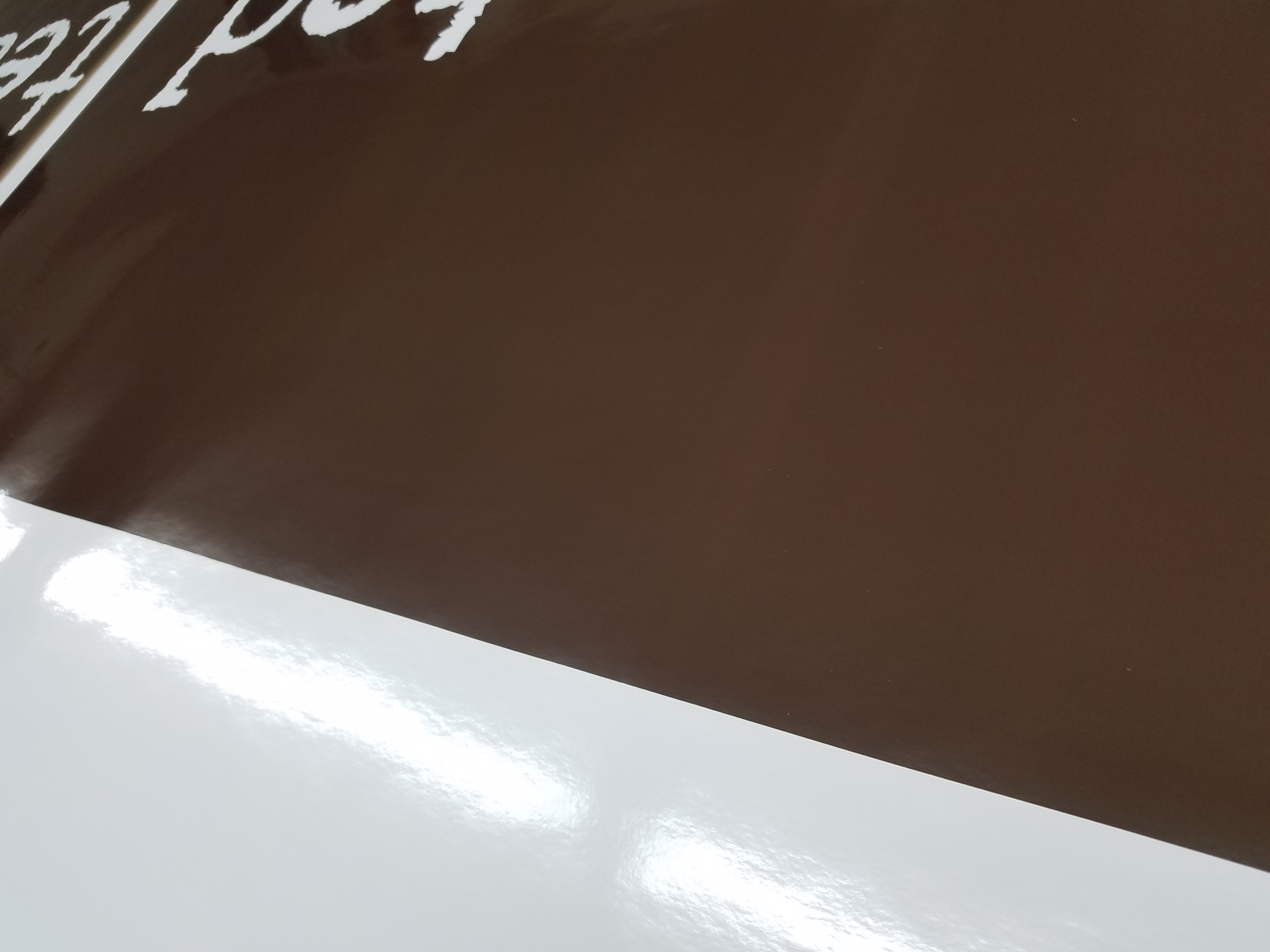

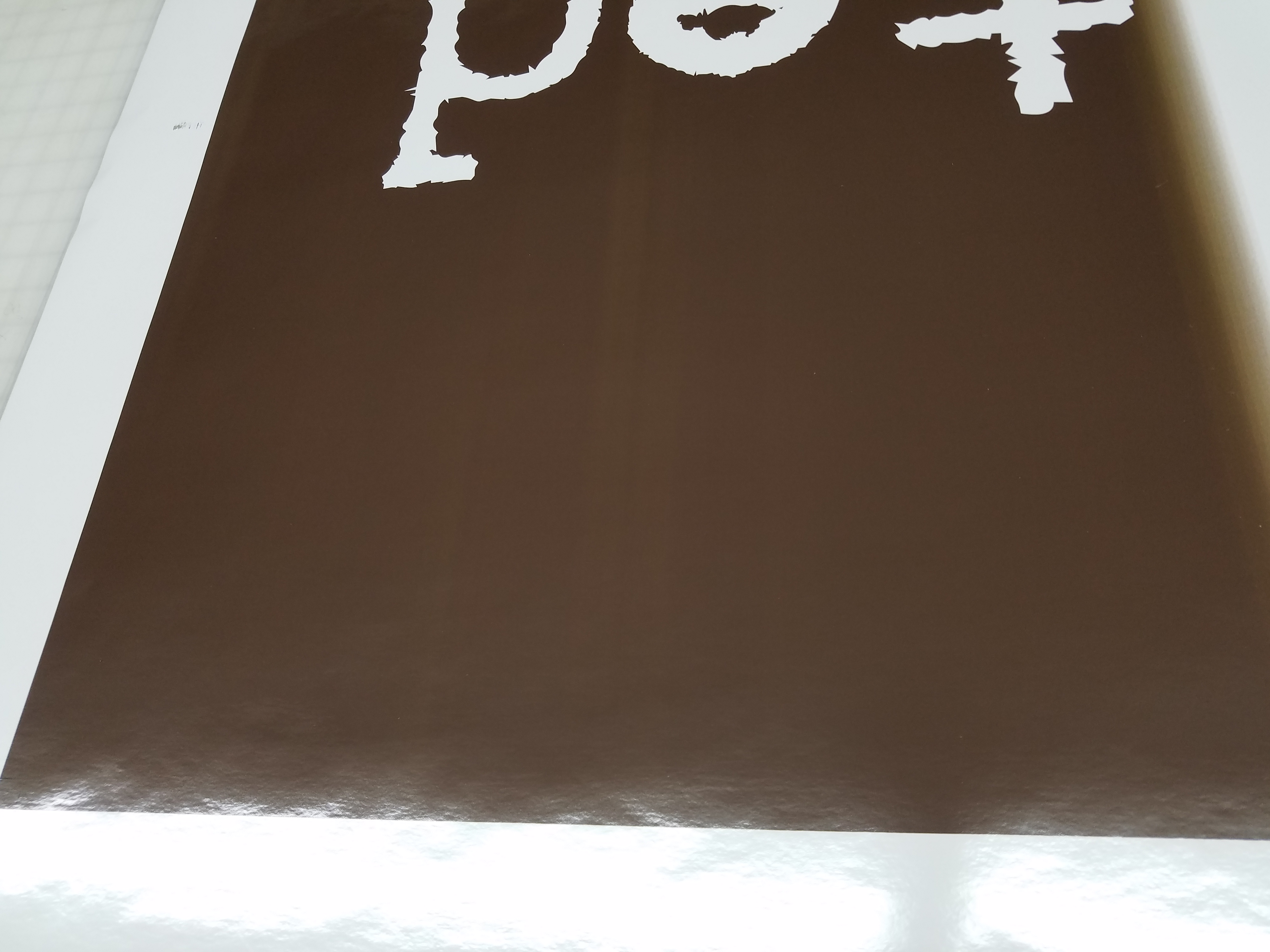

So this issue has cropped up lately with pretty much every large print that has a solid color background, small test prints look fine but when we move to full size we start seeing large faded bands every foot or so. Head test looks fine, cleaning has been done, feed calibration has been done, tried with different heat settings, different materials and profiles, faster speed, slower speed, pretty much every solution for banding or ink starvation I could find on google we have tried short of actually disassembling anything. I've seen some people suggest reverse flushing the lines but we're a little wary about taking anything apart since none of us have experience doing that and the potential for making things worse seems pretty high.
So as a last resort I come here to ask if anyone has any tips? Do we just need to contact our Roland tech at this point?

Are these bands of lighter colour perpendicular or parallel to the printhead travel?
Parallel.

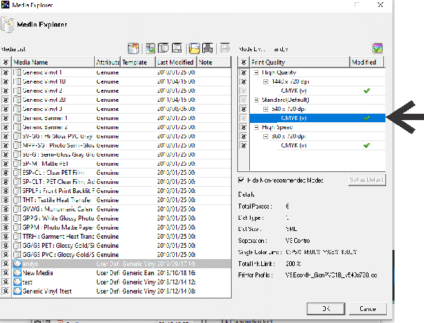

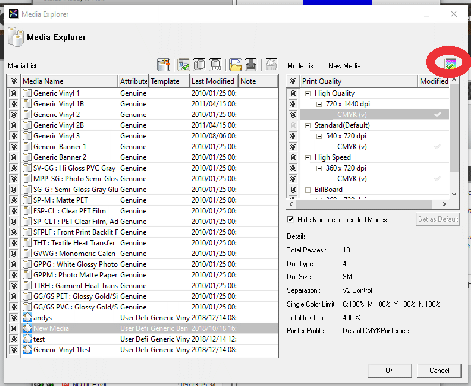

You can test and adjust the ink limit in Versaworks (not sure about Dual) Just:
left click media / media explorer / right click on the profile you're using/ copy media / name it something/ select it / click on top right icon (see below)
You don't need a measurement device, it's all by eye. I think you set "Calibration Settings" and then "total Ink Limit" but I could be wrong.

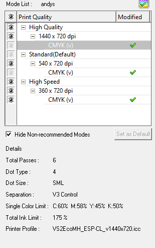

Just curious, below is the ink restriction I set, from what they had set that was close to 100%
What is yours set at?
The default for our profile was set to 200% overall, 100% each channel. I turned it down to 100% and it doesn't appear to have changed anything, the test prints looked mostly the same and my job still has the same banding. Should I try lower than 100%? :/

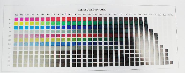

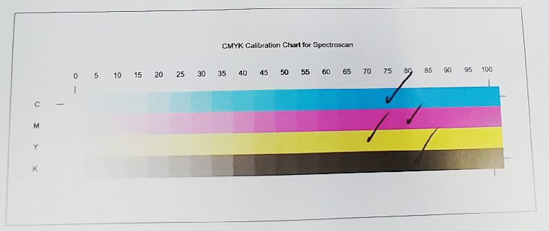

There was a good video that walks you through it but I can't find it.
Going from memory (I'm used to Onyx & only did this in versaworks once)
1. Pick the quality you want to test:
Hit the icon above my arrow above.
print calibration chart test:
find the spot where the color doesn't get any darker, I always go one darker to be safe.
Print the total Ink test, from what I remember this is with all the colors together and you want to pick the place in the chart
where the ink doesn't start to get blotchy and the edges soft:
