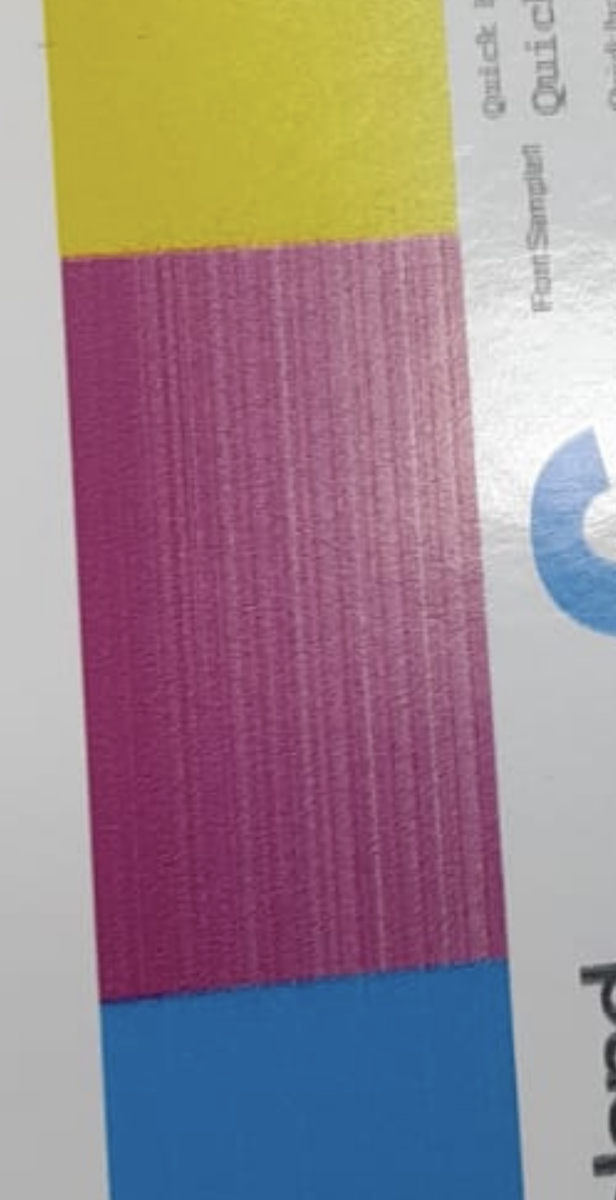

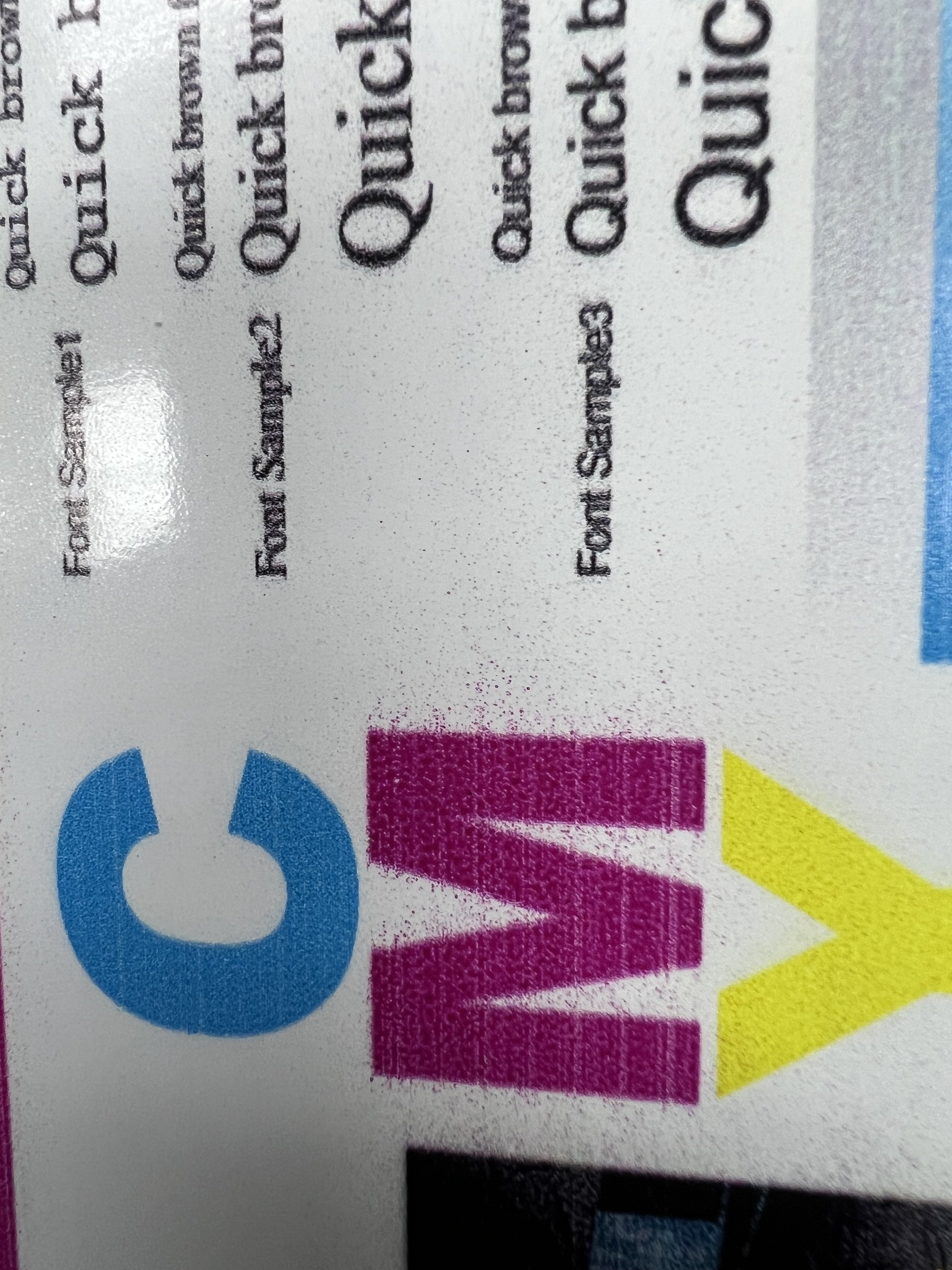

The magenta is acting weird it’s not printing solid and it’s having a misting look on anything with magenta … dispute new printheads change … any ideas?

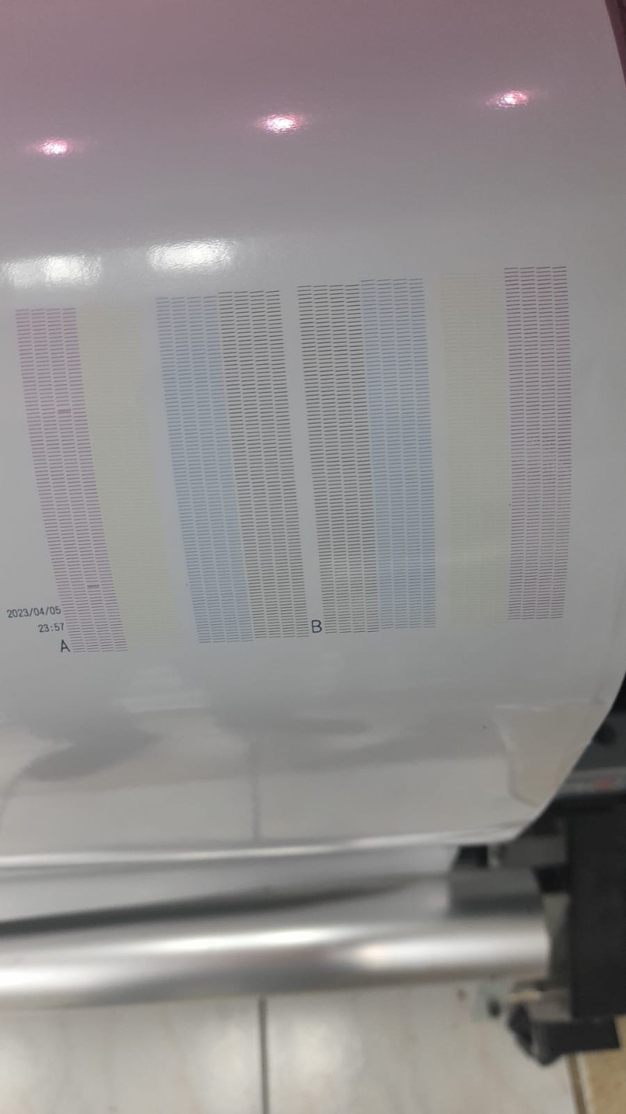

what's your test print look like. what inks are you running in that VG, the newer type 2 inks?

The test print

You've definitely got a deflected nozzle there. Roland should cover a new printhead for 90 days if proper maintenance is being done and you're using Roland inks that haven't expired. Get back to the dealer that installed it and see what they'll do for you.

solved it third party ink tr2 pouch had the wrong ink formulation ..... did a pump up and replace with correct ink and its now working great... thanks all for the brain storming....
