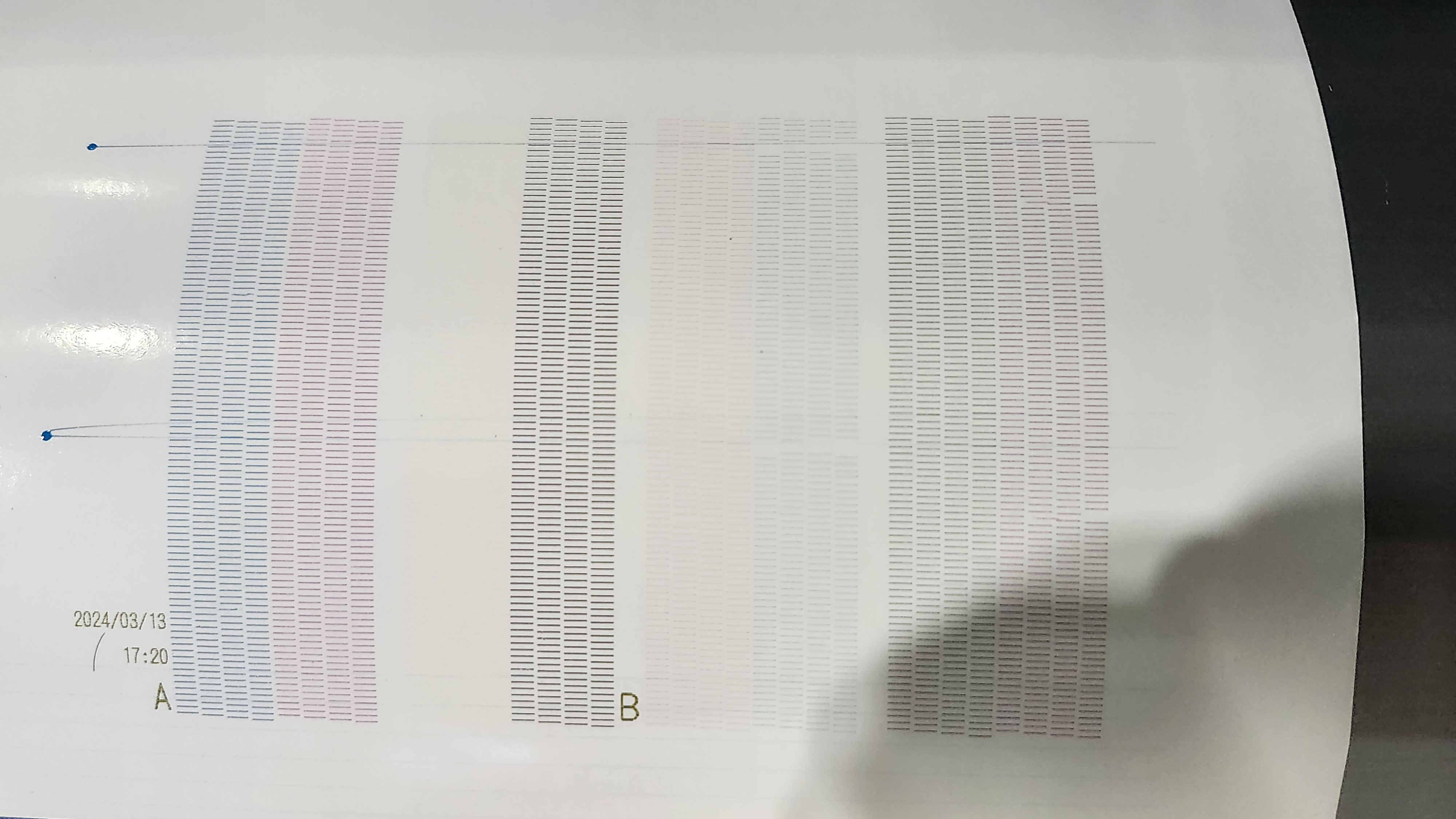

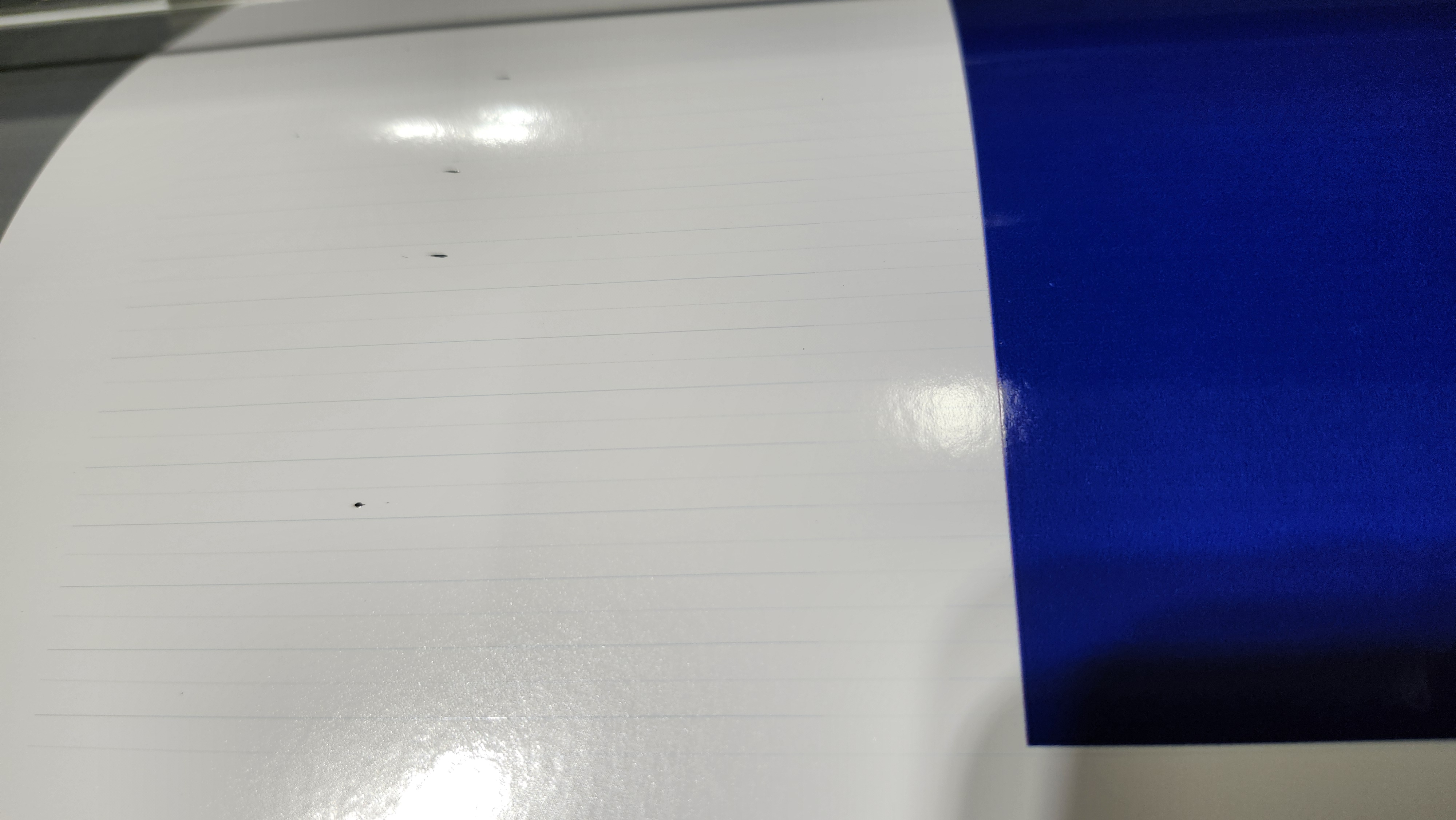

Just occurred this evening, cyan or lt cyan drip on test print same spot each test. The light cyan dropout has been there for a while and think it might be the cyan head. Anyone see this before with the test print little pool of blue being dragged? Captops are in good shape and just changed the encoder strip with sane results. Any Help or advice? Thx! Joe

Blue dots have always meant I needed to clean the head...those dropped out jets might only be partially clogged or deflecting so they pool and drip rather than hitting the material like they are supposed to...the lines through the drip might even be a hair stuck to the head dragging through the ink...
