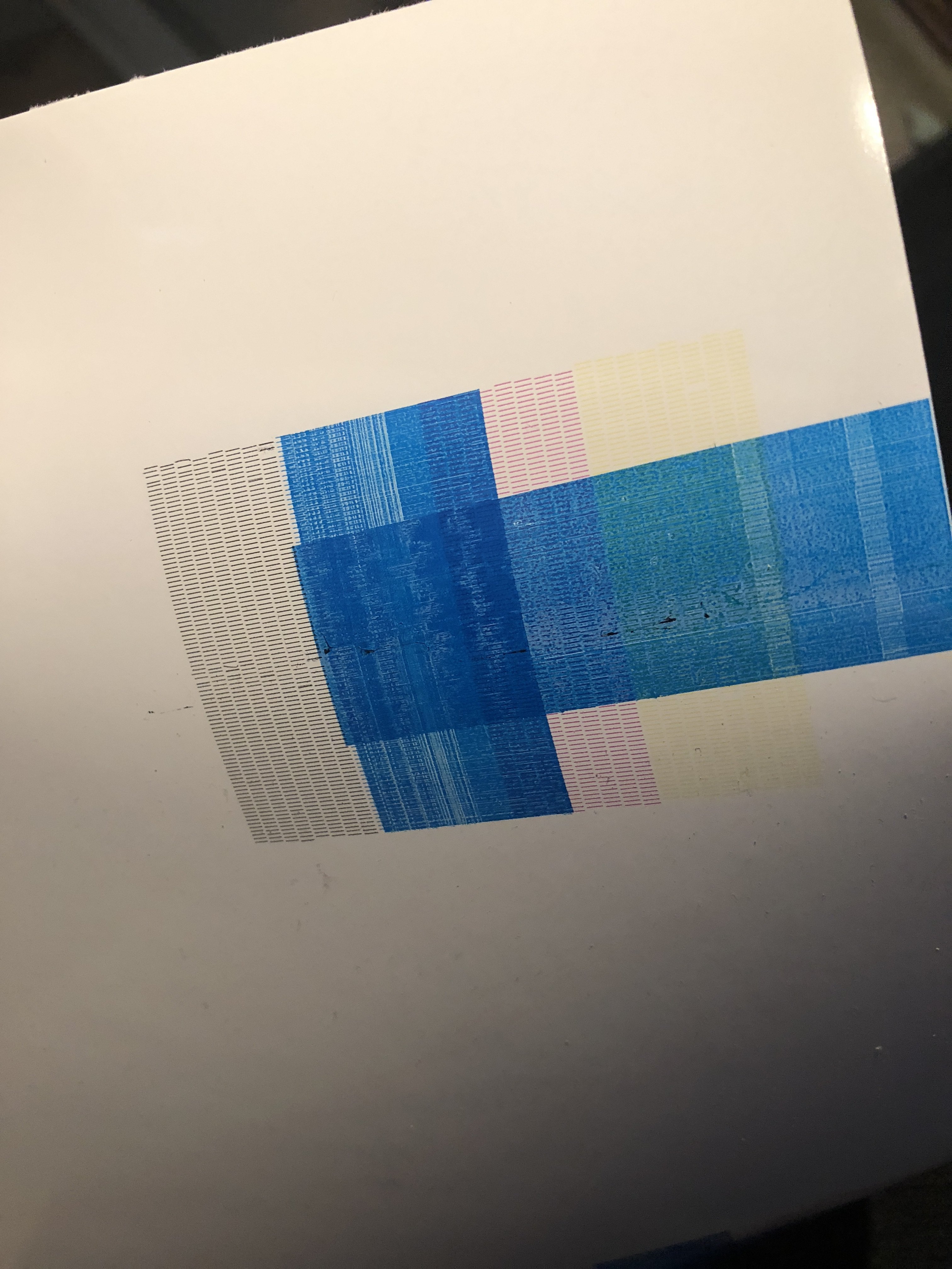

Hello All,
I have a VP 300 that is spraying Cyan ink everywhere on my media. I just recently replaced the servo board and I have done several cleanings to include the encoder. If anyone has any ideas please help thanks in advance.
Steve.

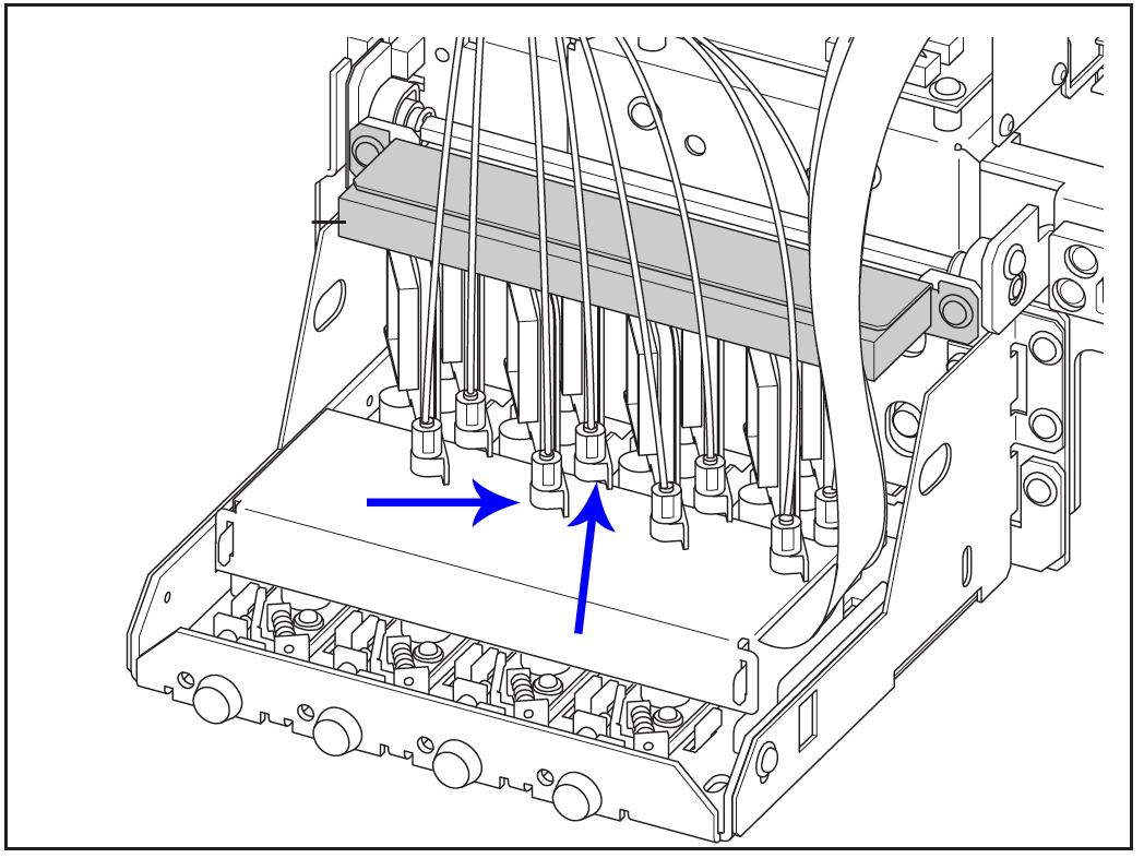

$Rob41god
I will check this out. See image I want to be sure of metal fingers.
Thanks

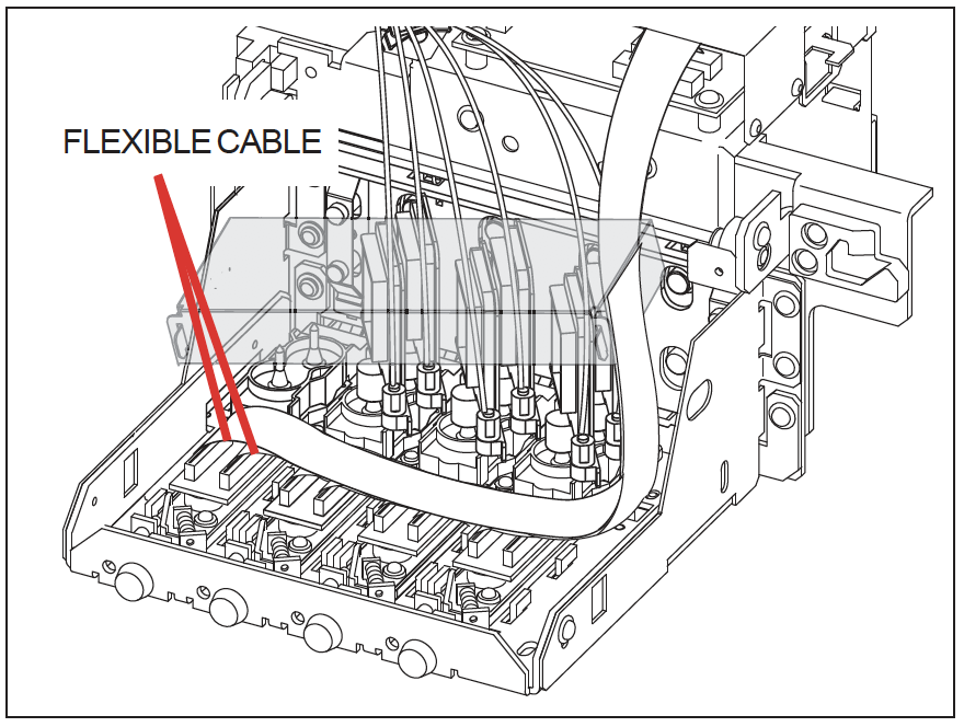

$Rob41god
I think this is what you were talking about. The actual head cable to each color?

C5 Service&Repair
no that issue is the head cable. undo them both from the head and the carriage board. make sure no ink is on them, the metal fingers are all perfectly straight and not damaged and reseat them.
