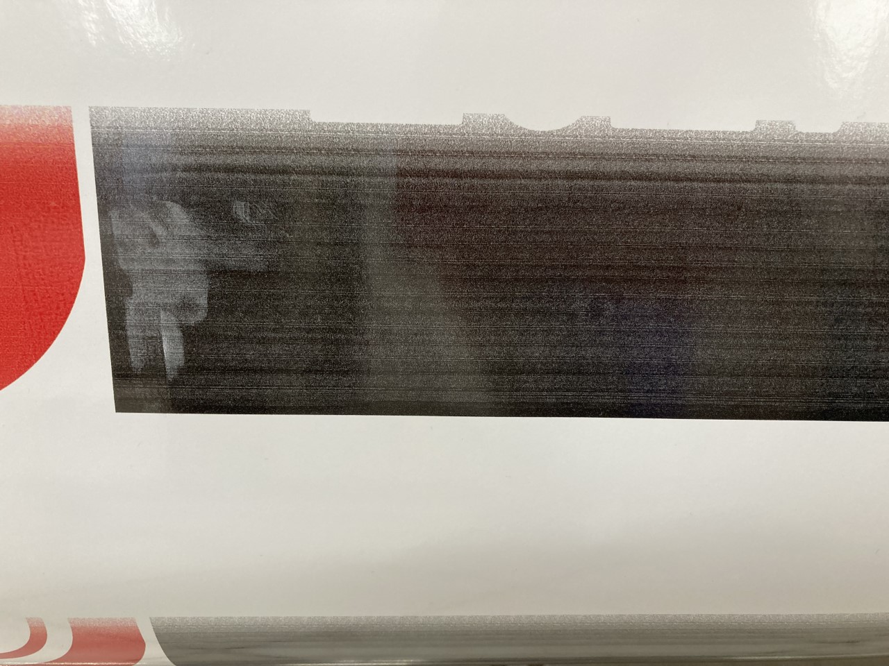

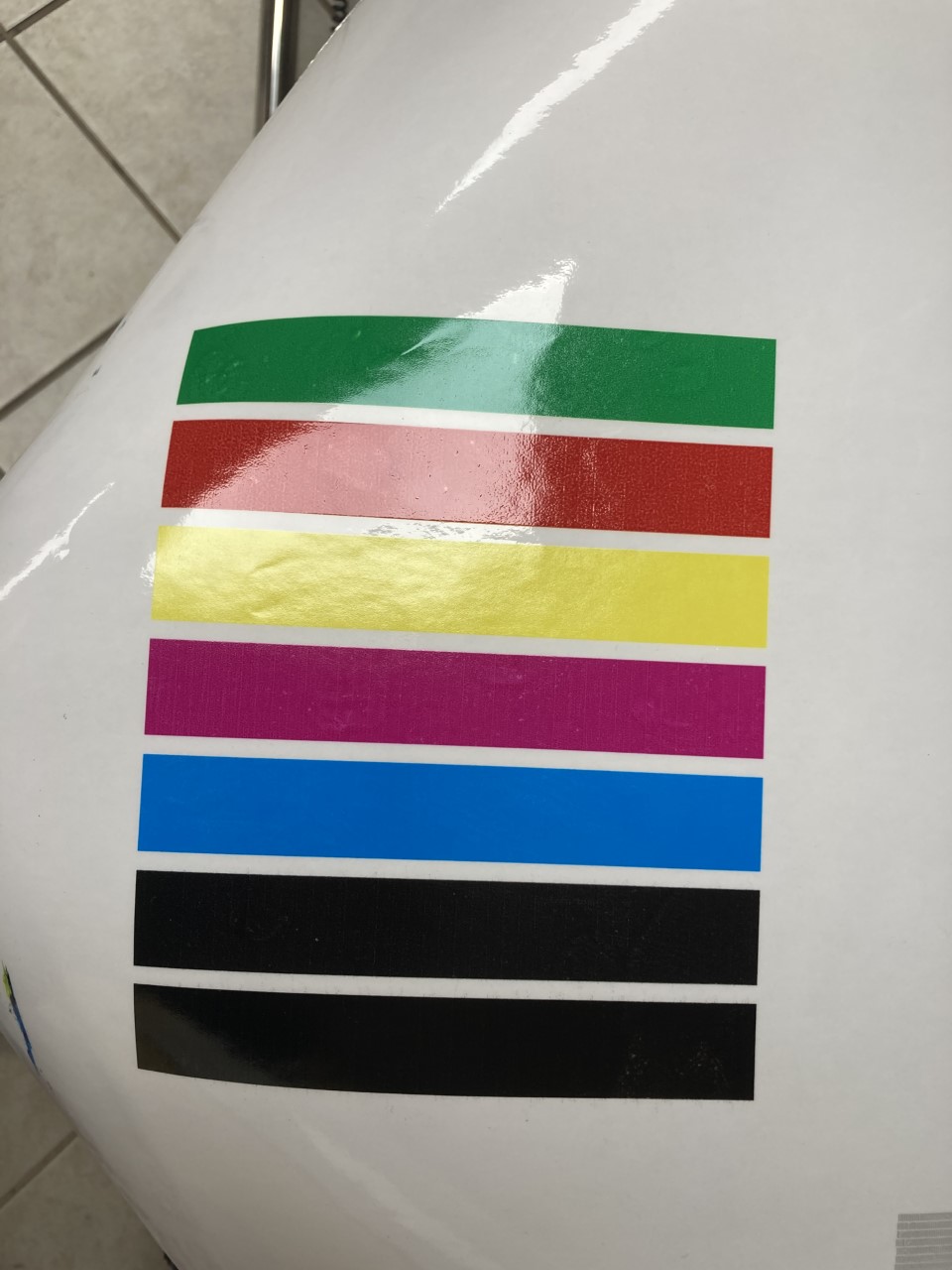

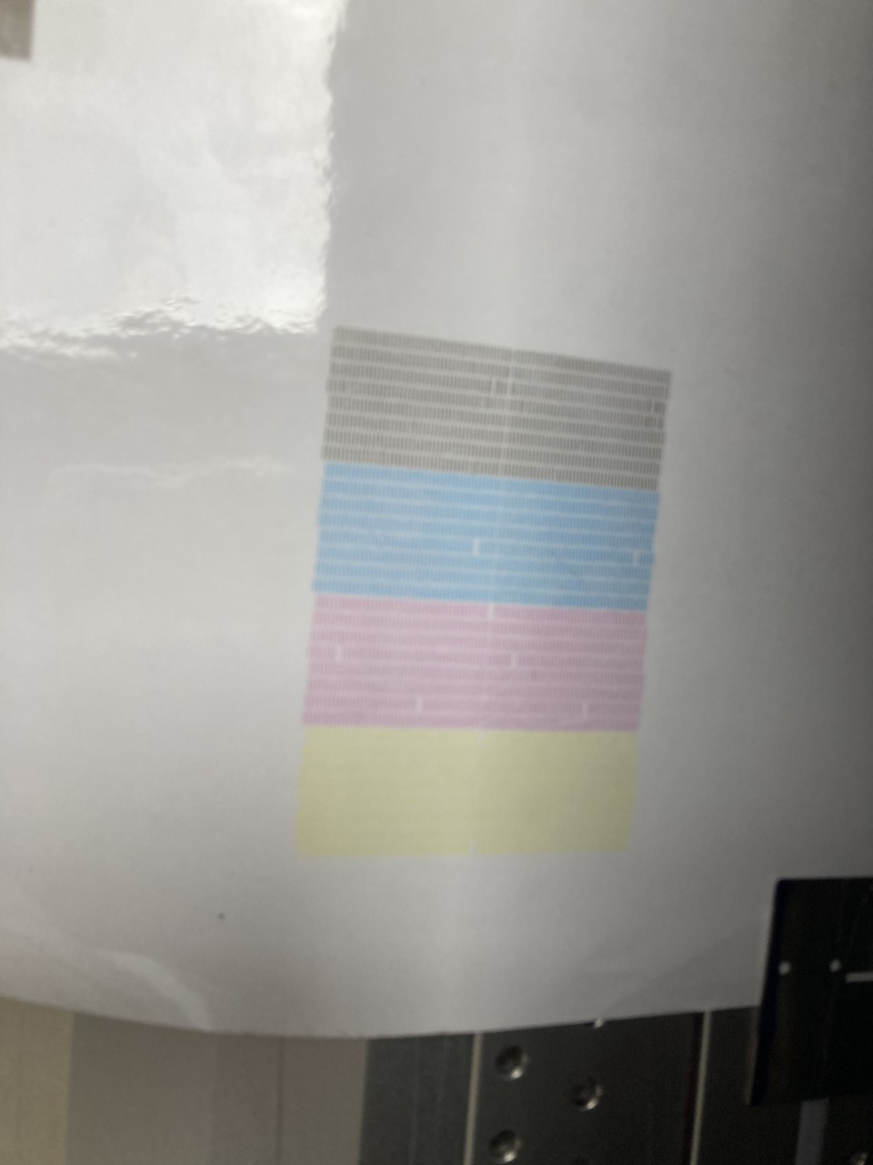

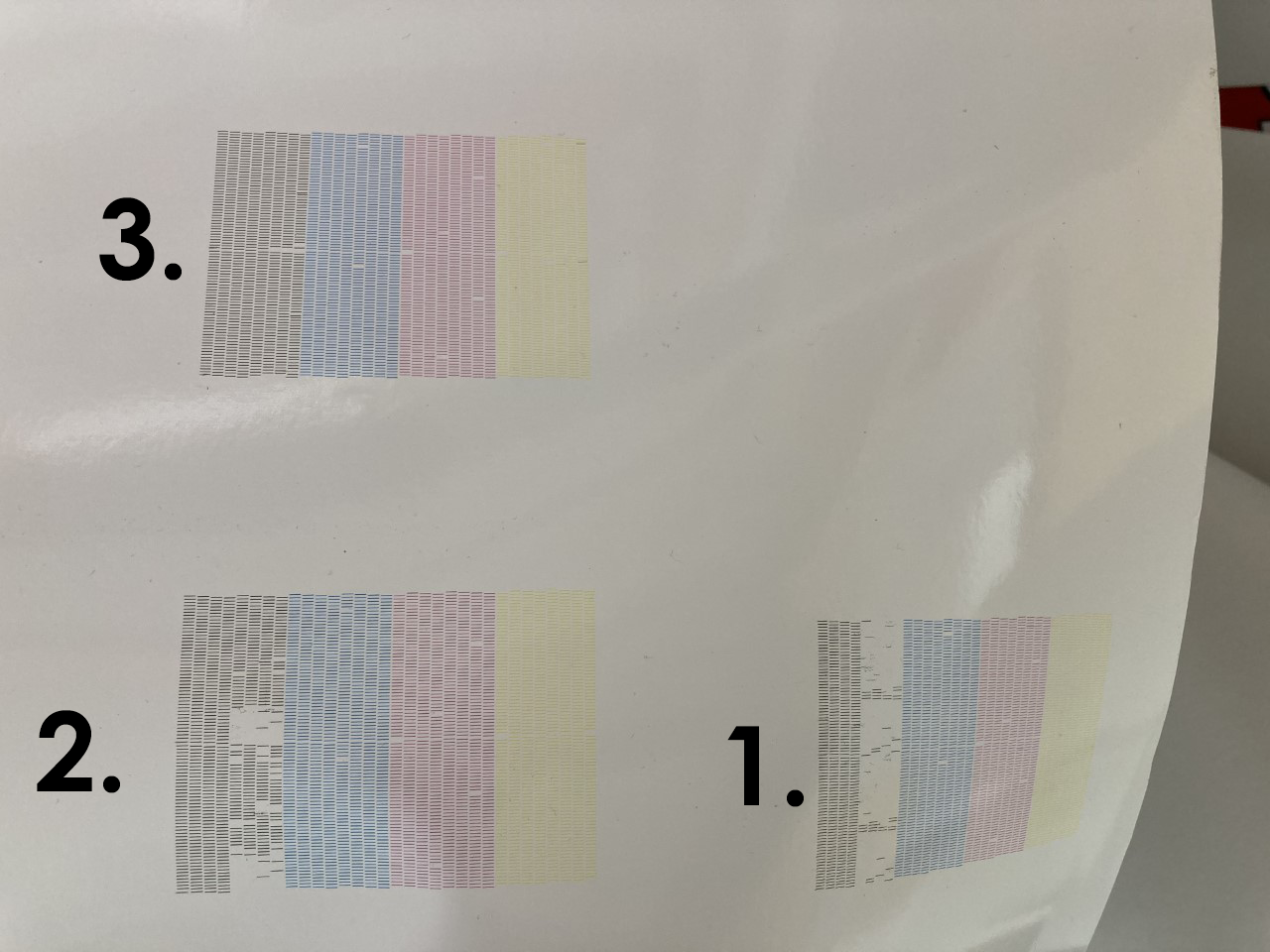

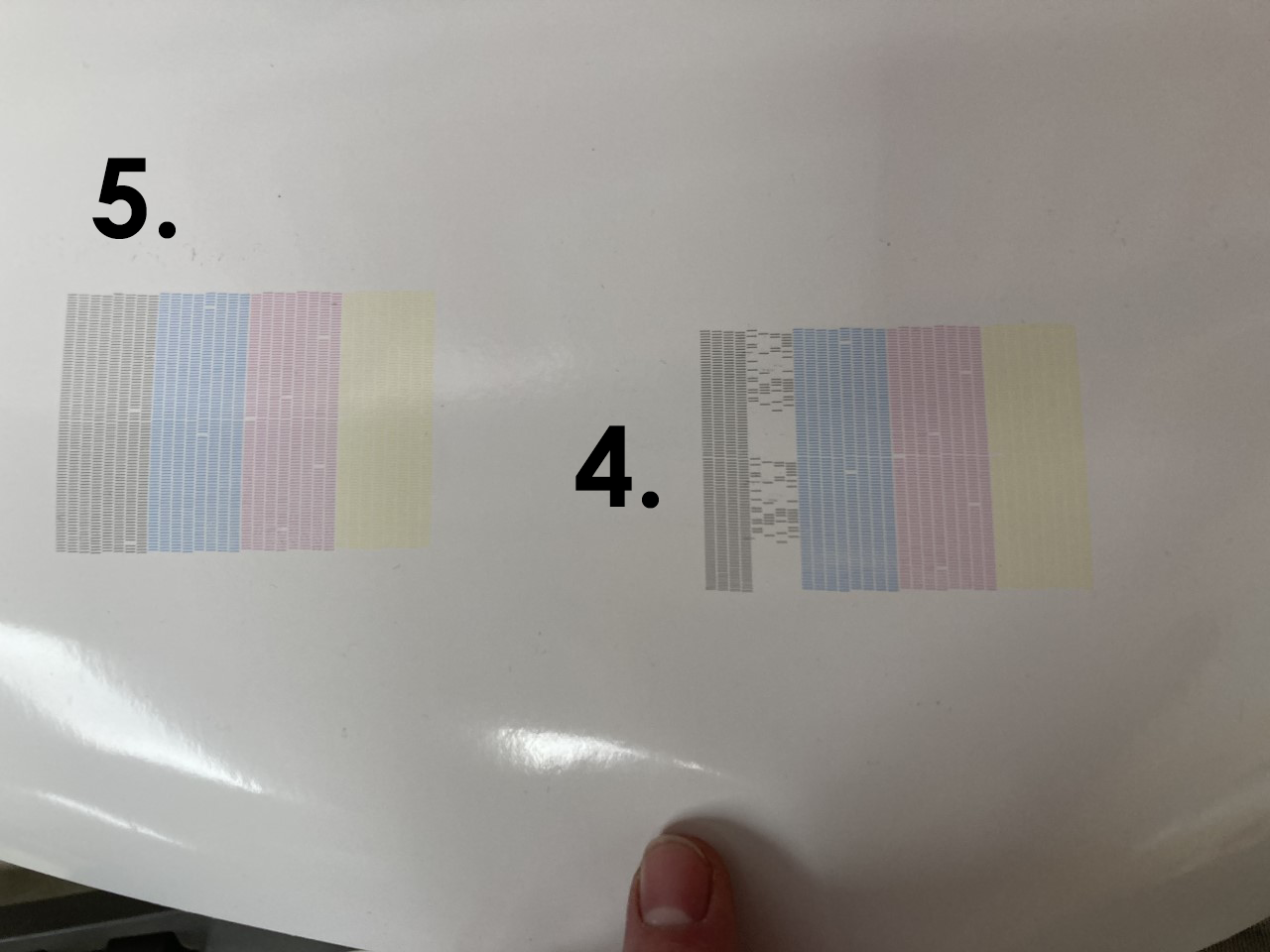

Our Roland VP-540 is failing to print black. Per the attached images, here's the scenario
1. This is the test print immediately after the first sign print failed.
2. This is after a medium clean
3. This is after a manual clean. We tried printing the sign again after this
4. The print failed. and this was the test print immediately after.
5. This is after a powerful clean. We tried printing again after this and it failed.
Any idea what the problem could be? It seems like something during the printing process is making the head dirty. Could it be the ink caps?

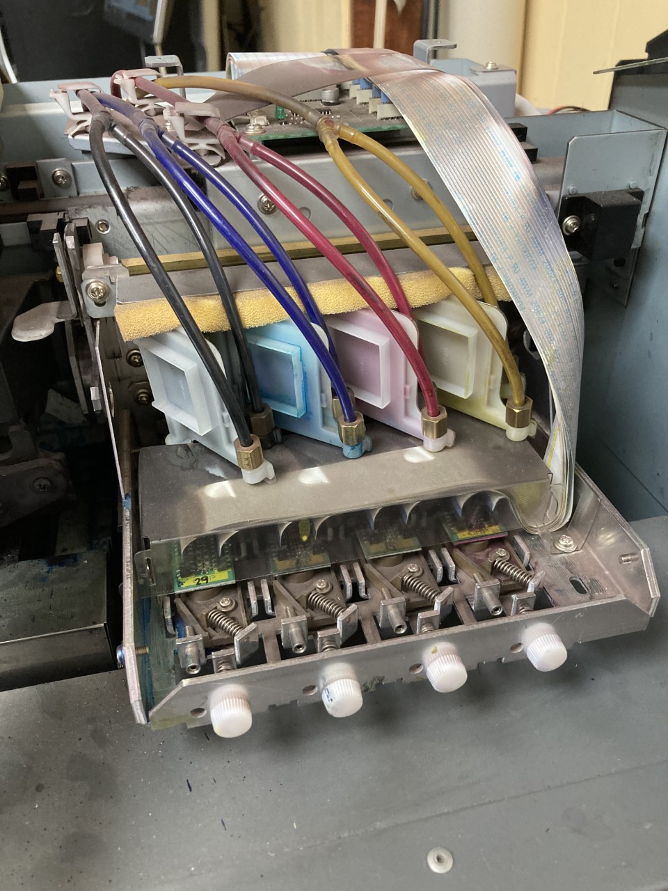

Hey! I took a look at the dampers. How are these looking? I don't have much of a frame of reference. Will be doing a headsoak tonight.

Just following up! Had our tech guy come in Friday and replace all 4 captops and all 8 dampers. He said ink was filling up in the dampers and not getting pushed through appropriately. Here are our test prints as of this morning!
