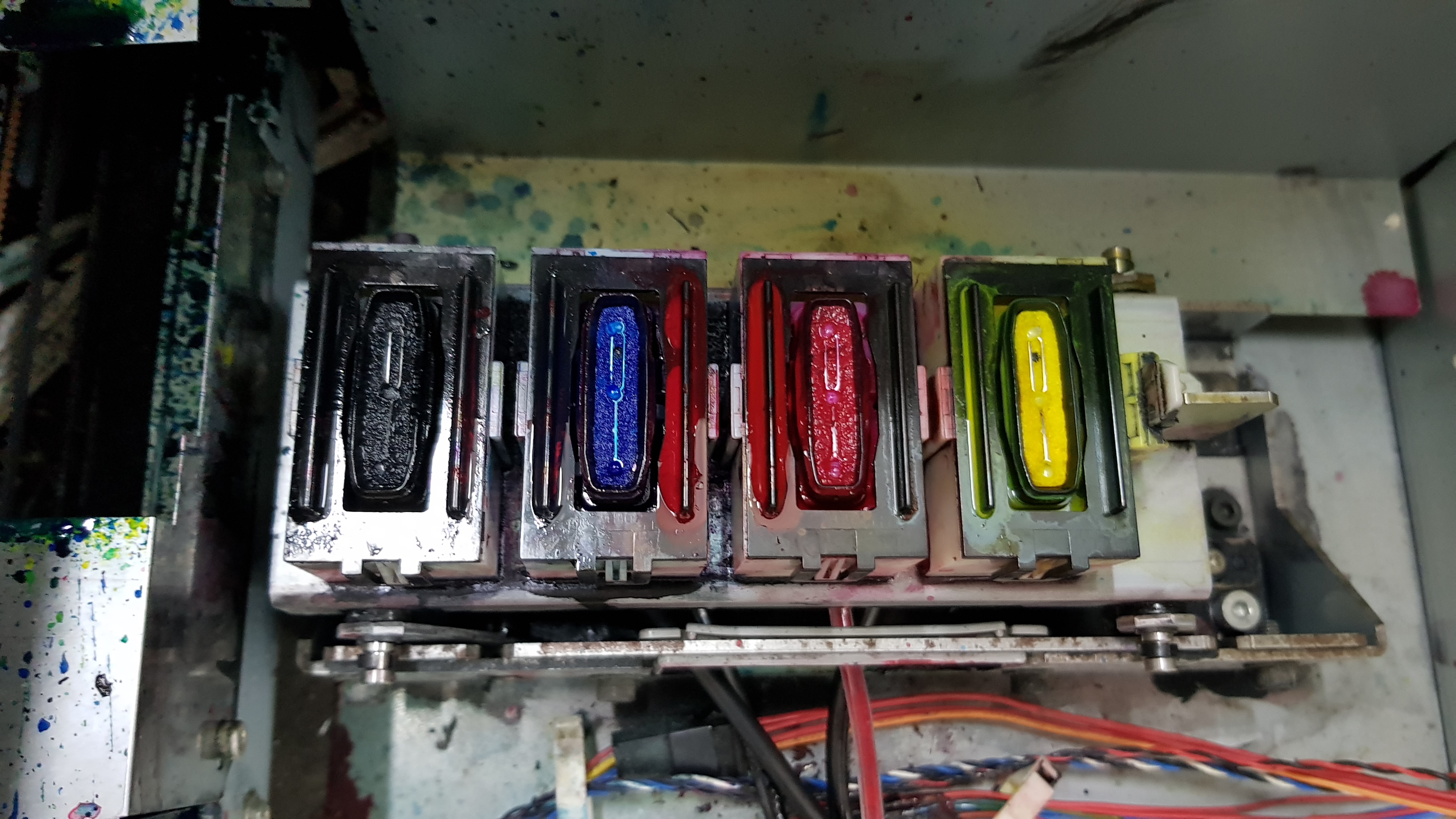

I can tell the magenta cap top is not an OEM one which is probably what is causing your issue with the ink on the floor. I would swap it for an OEM ASAP. Non-Oem cap tops tend to use cheap absorbent materials which swell up and touch the bottom of the head. This creates a wicking effect that sucks all the ink out of the printer.

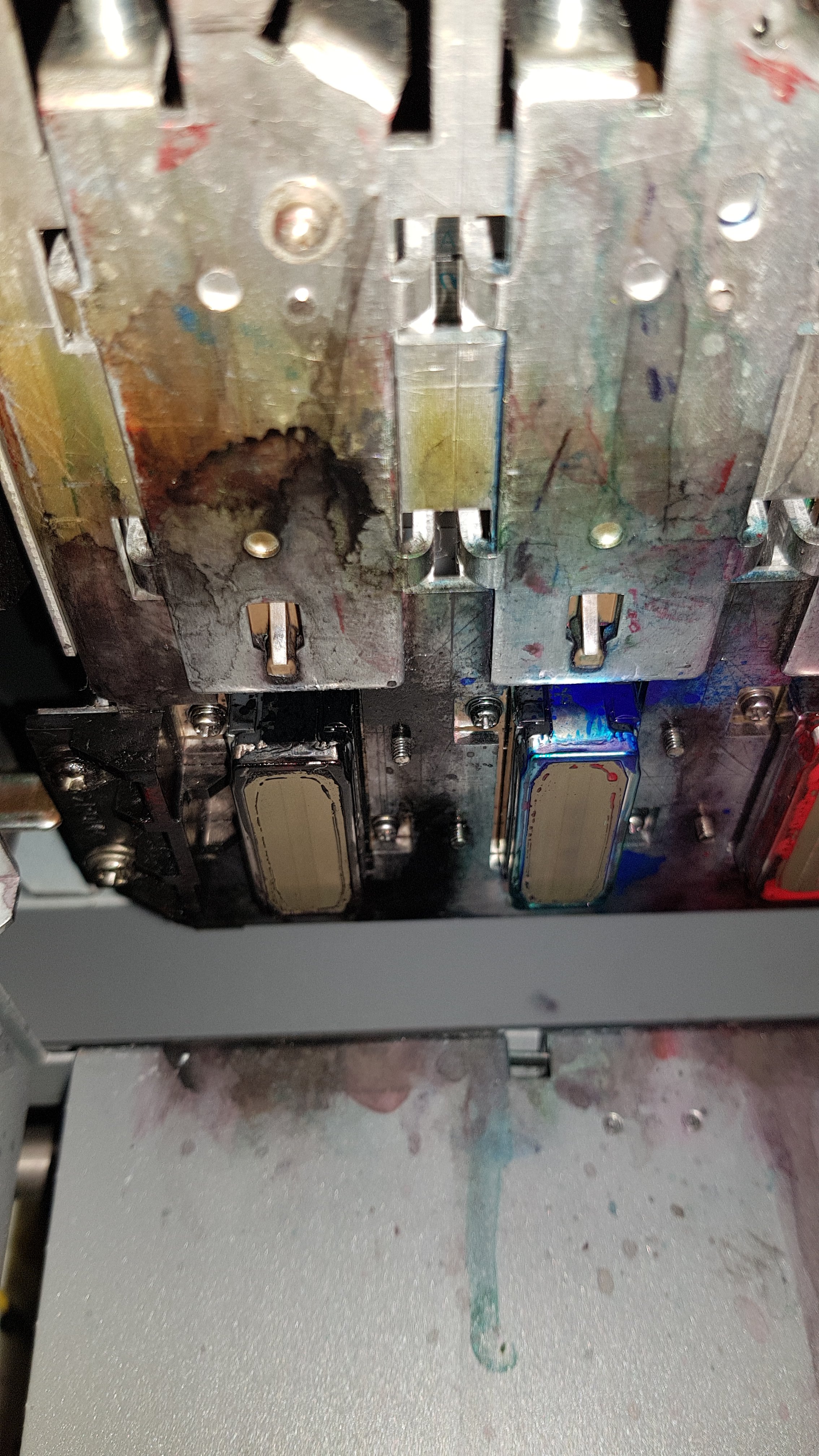

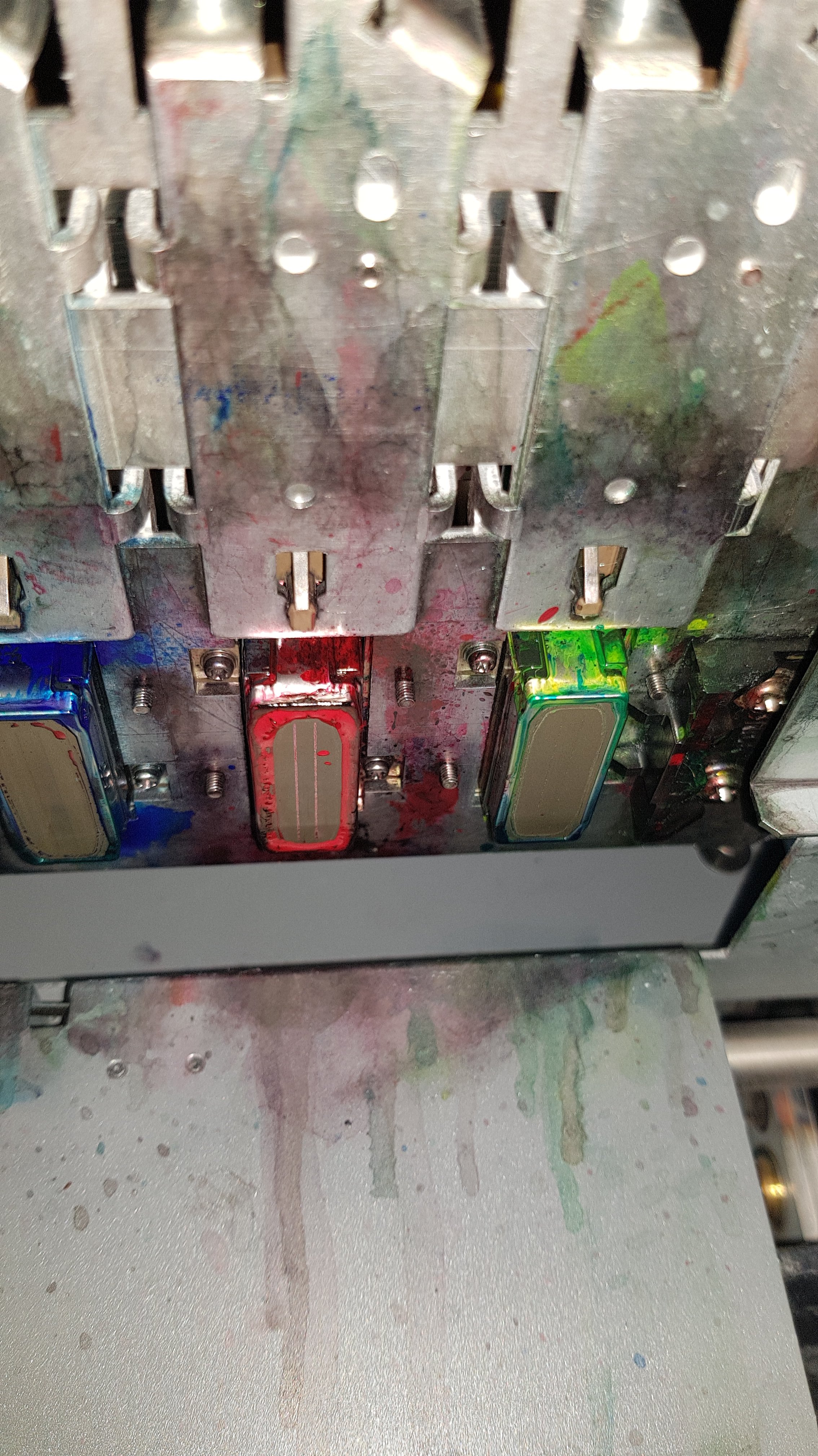

As far as the print quality goes, it looks like the heads are very messy. You need to get in there and clean so that the chrome metal around the bottom of the heads is nice and shinny and there is no ink build up on the bottom of the head. The cap tops are probably having a hard time sealing with the head because of this.
klingsdesigns
Looks like the cyan and magenta are different captops then the other two. Them heads like vanderj said are super messy should look like clean metal. Even around the captops need a good cleaning. I am assuming the wiper and scraper need cleaned if everything else is that dirty.

The reason we know the cap top is not OEM is because the tube is clear. All OEM cap tops have black tubing.

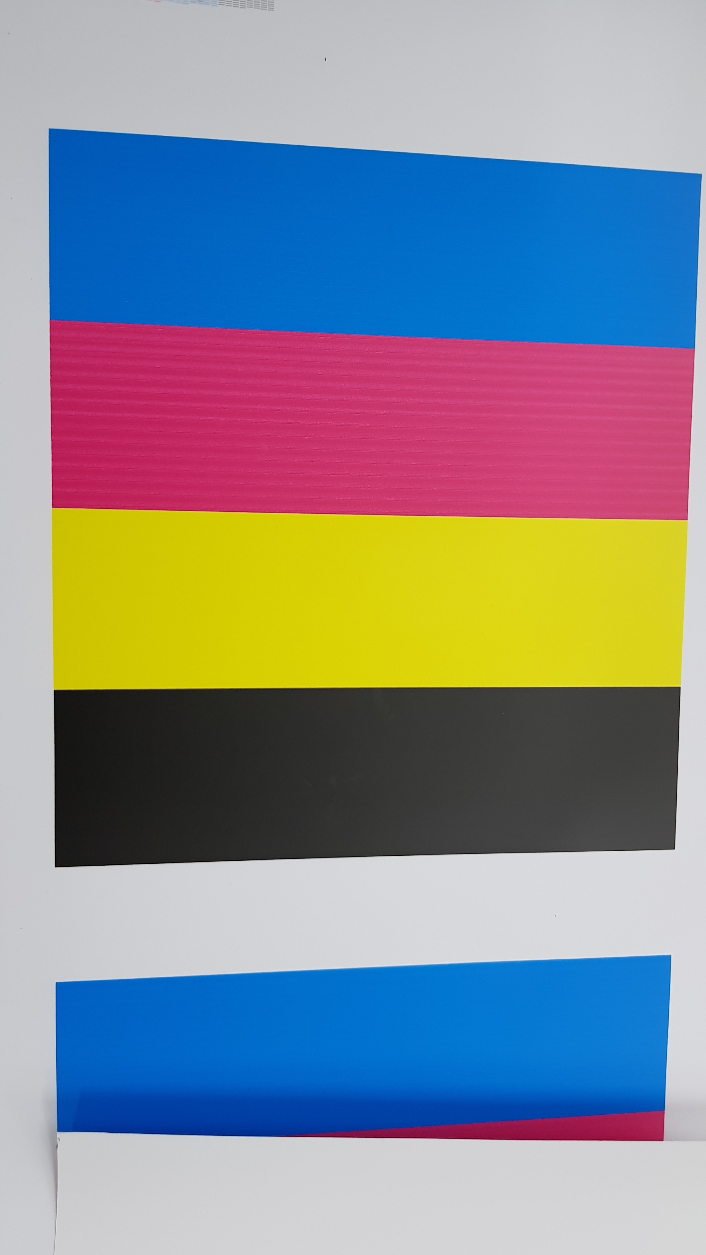

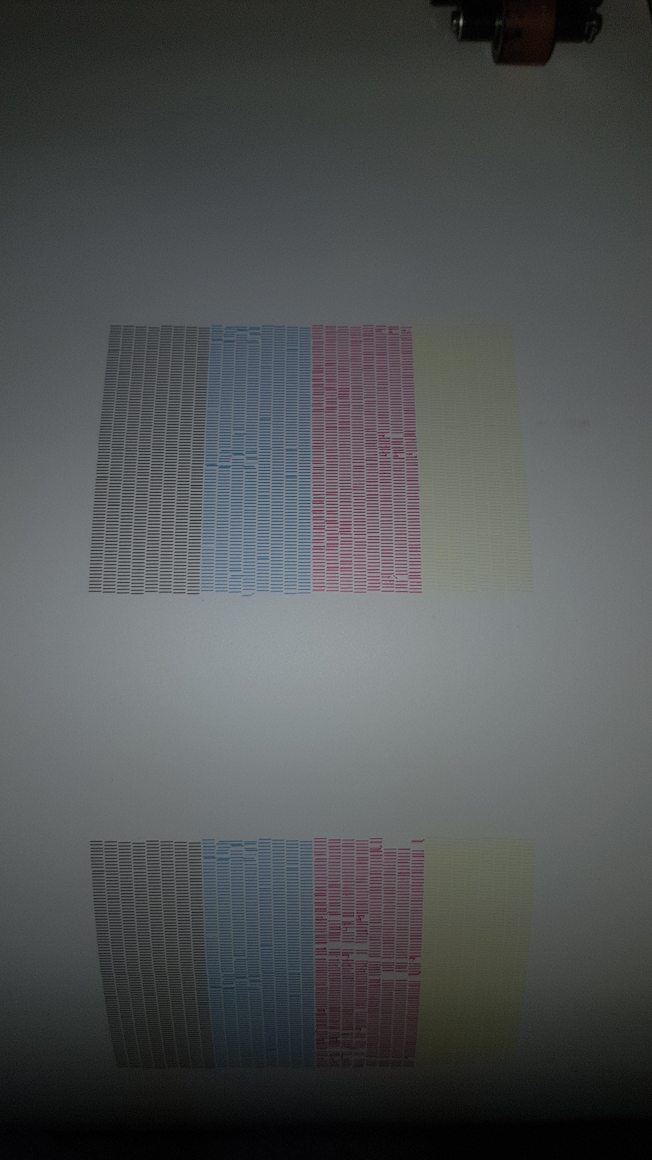

also i have clean the printer head, test print, the magenta still have some banding,
if use high quality / uni direction to increase the quality, it ok.
but when print artwork, the banding come out again.
it like after print few centimeter, the magenta nozzle will have some blocked.

That sounds like a failing damper. Any time ink falls out of the head like that it's a sign that the damper is not able to hold ink properly anymore. Also, when it prints fine for a few centimeters and then drops out again, that is another sign of a failing damper. I would start there.

Who changed the dampers? Dribbling ink could be a cracked manifold. The manifold is the plastic spigot or stem the damper sits on.

i know im a little late to the post (im new here) but i had this issue too. I had replaced my caps and realized that the magenta cap had stuck down (they are spring loaded) so it wasn't sealing properly and leaking ink. As far as the banding issue, i would say by the pictures you loaded up,your machine needs a very thorough cleaning Especially the Heads and caps. My machine will occasionally start to band and when it does i perform a cleaning and it fixes the problem
