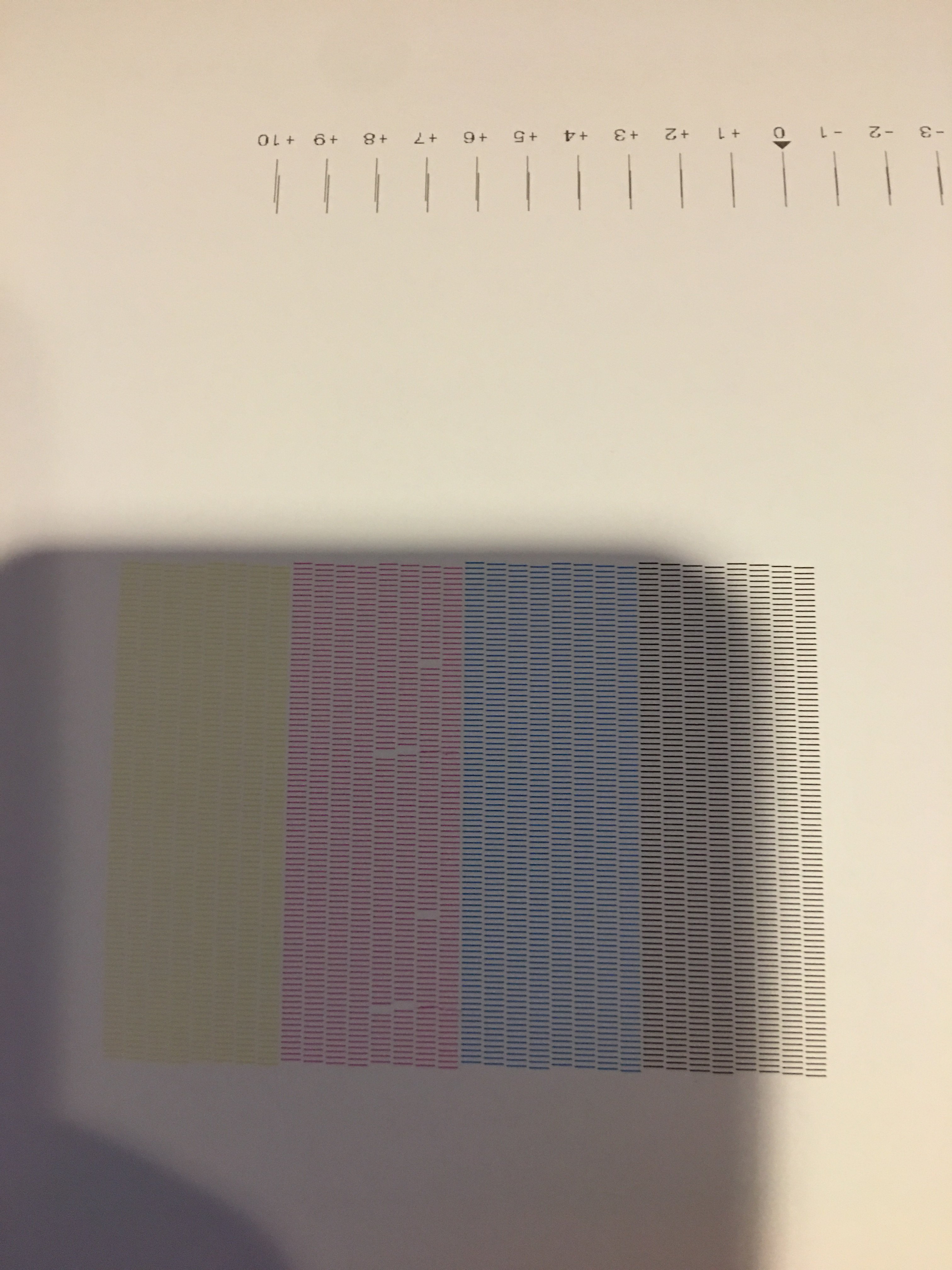

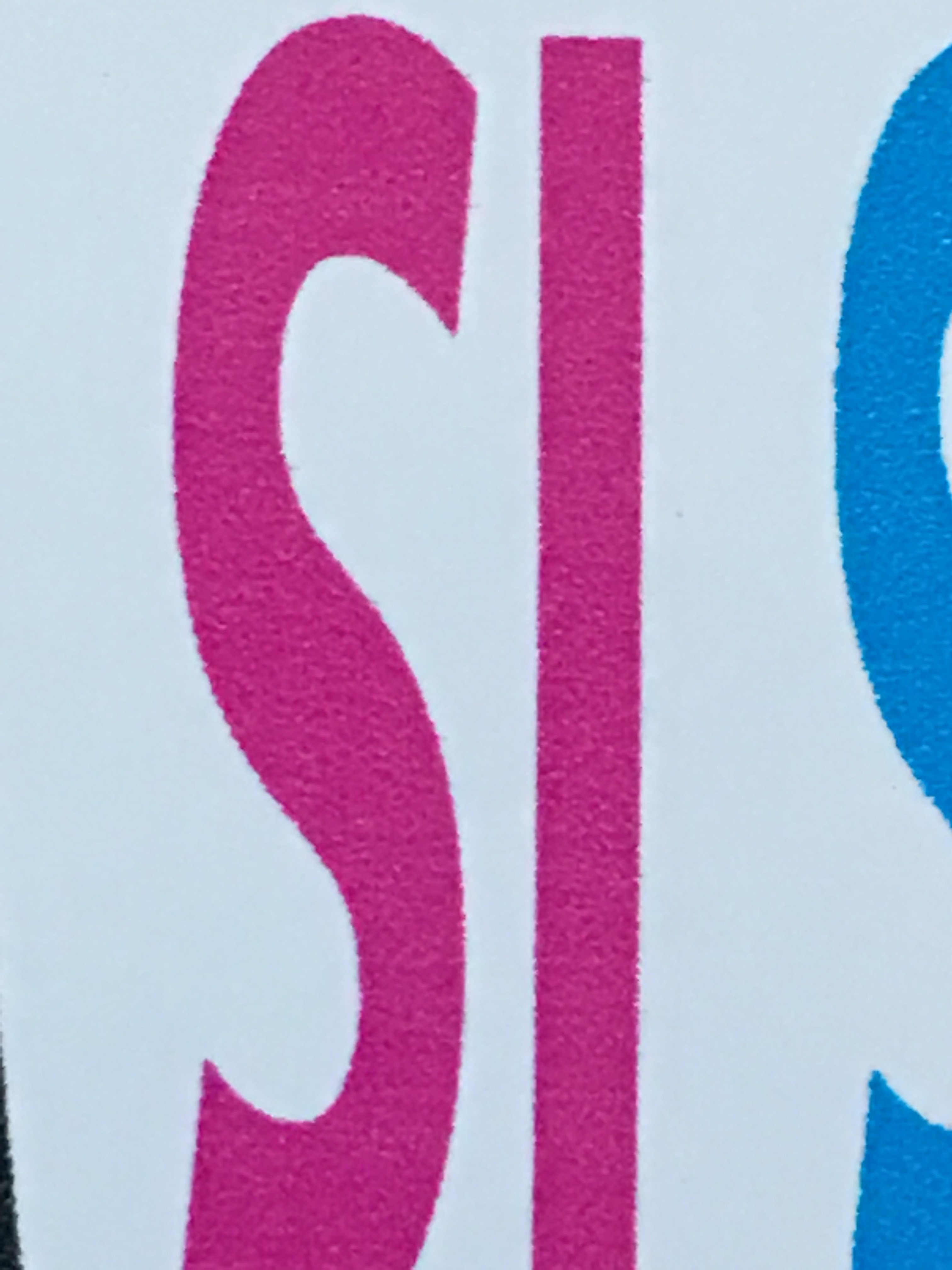

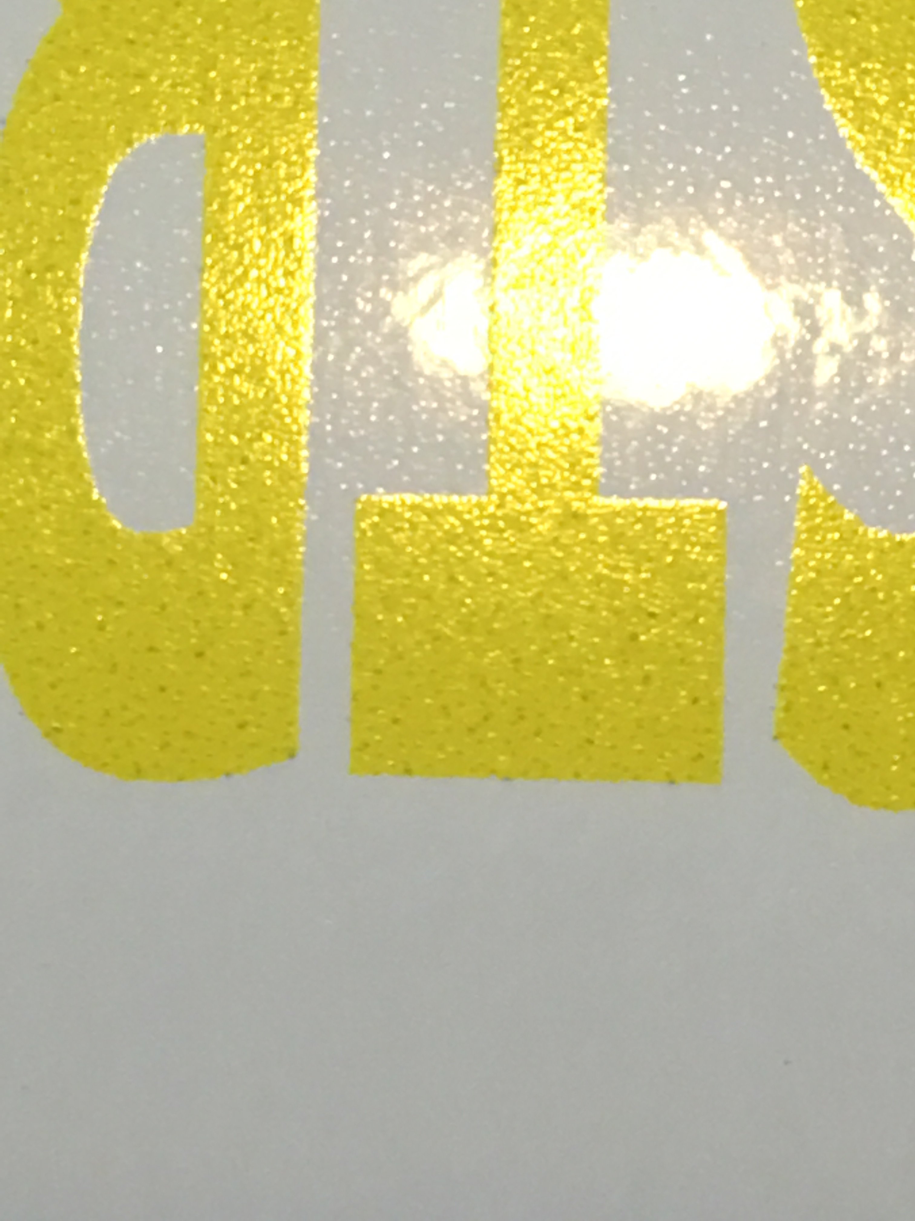

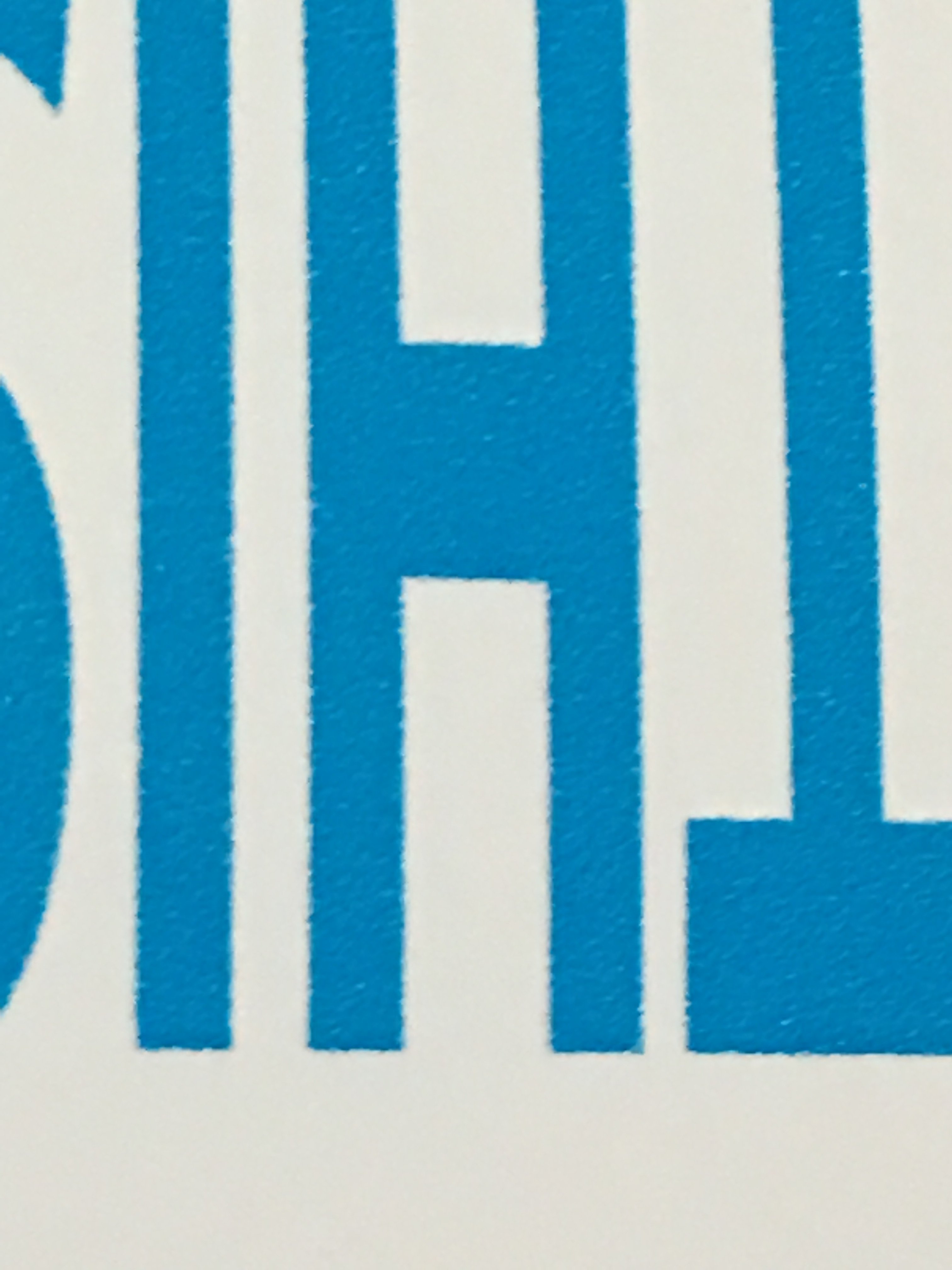

7C897C99-9D6D-403D-BBD0-6165F10B0100.jpeg B21D1FF4-9F99-45C3-92B6-C74599B88FEF.jpeg D452AF5D-BF1A-4BD3-B718-B84CD0B3E6A7.jpeg 7C897C99-9D6D-403D-BBD0-6165F10B0100.jpeg B21D1FF4-9F99-45C3-92B6-C74599B88FEF.jpeg Hi My name is James, newbie here of course. I’m from Maine. I recently purchased a used VP540 from a dealer in Mass. I’m having some problems with what I would call color overspray?? Actually not even over spray. In the picture you see slight banding which was way worse I did all the calibrations that I could without being in service mode and did a powerful clean and manual cleaning to get the banding this good. What bothers me the most is inside the yellow on this particular image ( shows on all colors ) there are lots of cyan and magenta specks making it grainy. Head test prints look fine. This is driving me nuts!! Also good to meet you all. I find all of your comments very informative an I thank you for that.

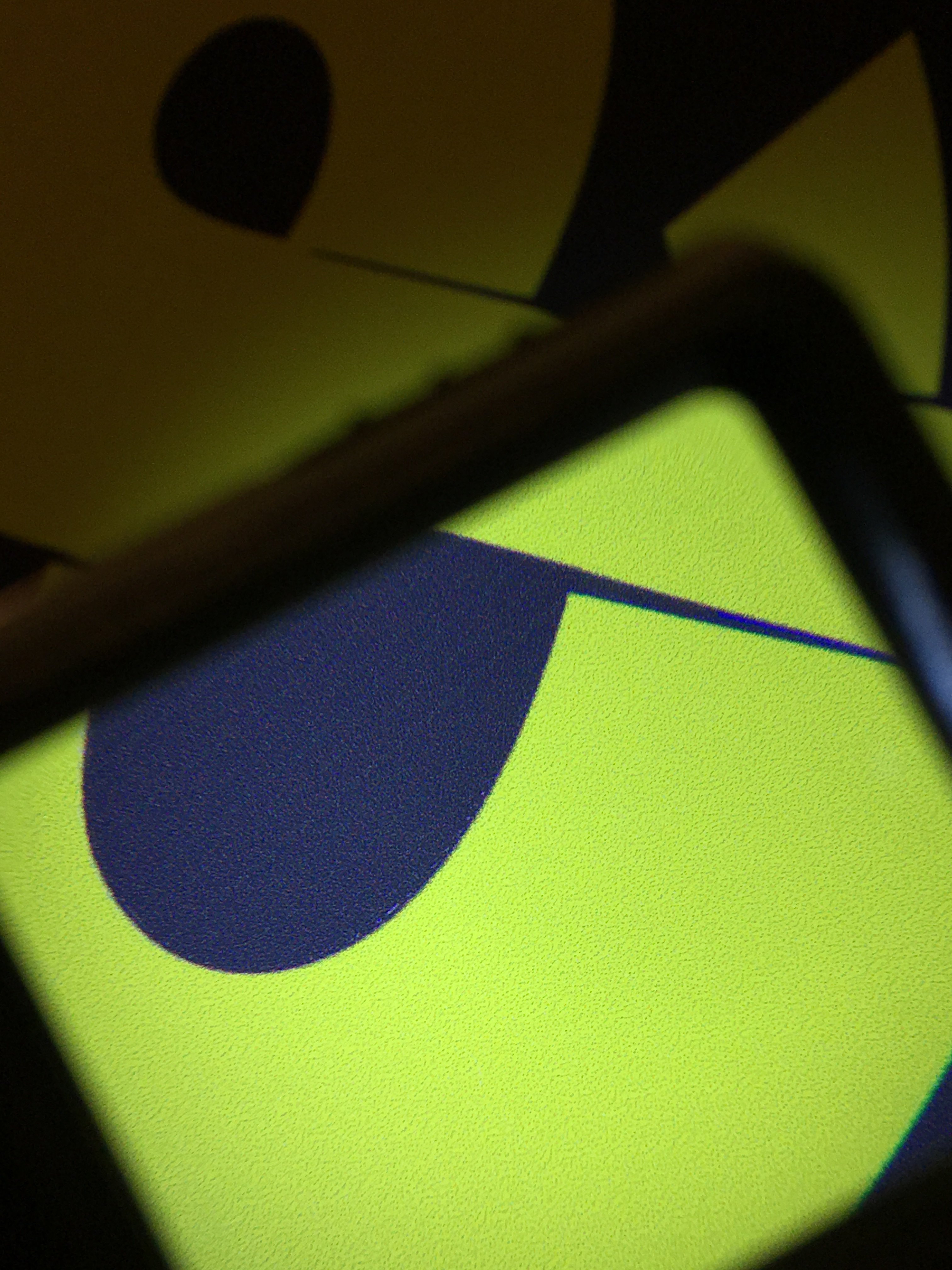

Your magenta is missing some bars in the test print. That can cause some quality issues. Cannot see the yellow if it is missing any. If it is, it will be a little worse again. A blue light (led keychain for example) will allow you to easily see the yellow test print.
Jamie0075
I ran the print test the magenta had 5 nozzles messed up upon inspection during a manual cleaning I found 2 cat hairs on the head. (Stupid cat ) after manual clean I did a ten minute head soak and got it back with only 2 nozzles not firing. Did a test print of a 100% yellow and it still has othe specks of color in it. What could it be? I have tried everything even in the software on the box that says to preserve original colors.. wife is ready to kill me because I’m spending all my time trying to dial this in.. HELP!! Lol
