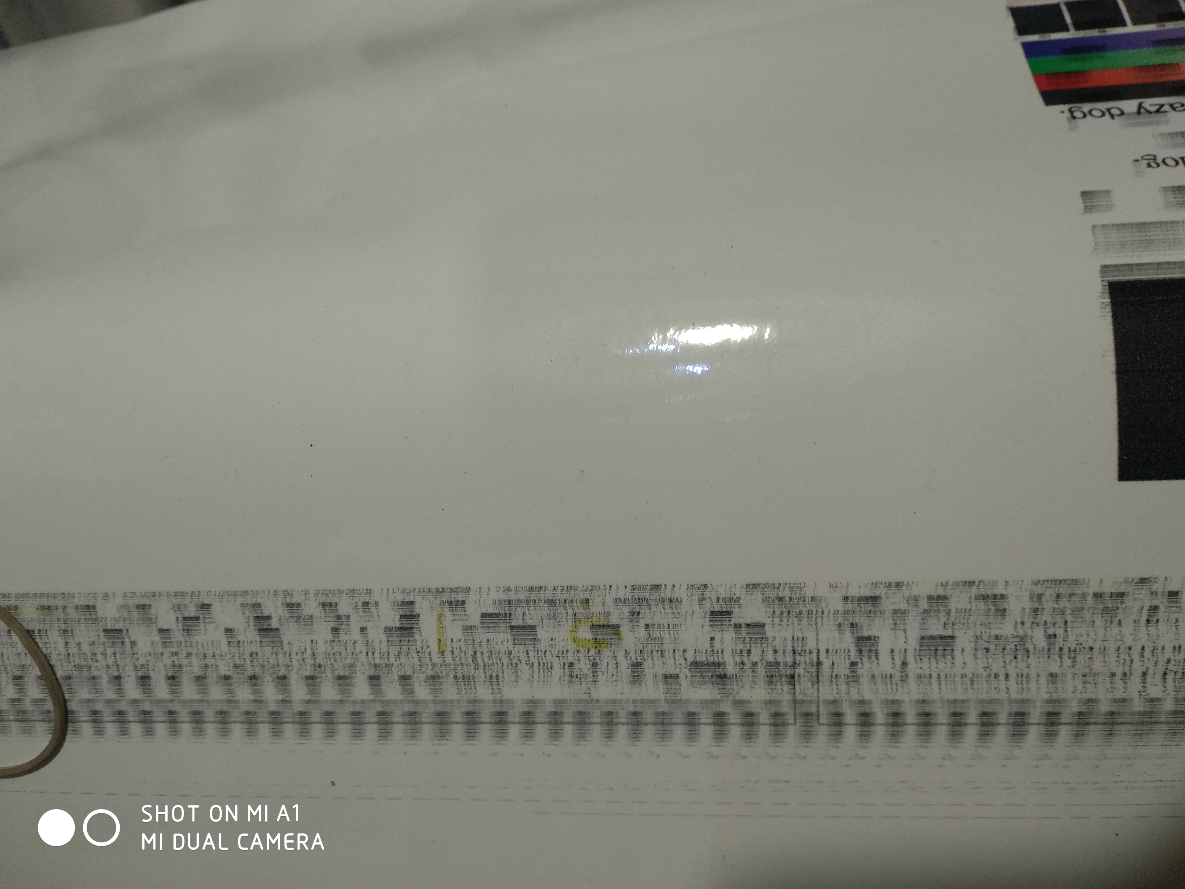

Hi, i have a problem with my print ROLAND 540i.
When I am printing a file always printing that black lines accros the print, this is done on all prints except when I do a test print.
Could you suggest me something? is there anyone who has faced a similar problem? a member had suggested to change the encoder strip I change but nothing changed when I put the new one.
Thanks

Hey, I am currently looking for A solution for the exact same issue.
Did you get issue resolved if yes what was solution?
Thanks

Looks like interference, check all the head cables to make sure everything is good and there isn't a bunch or ink or bent connectors.
