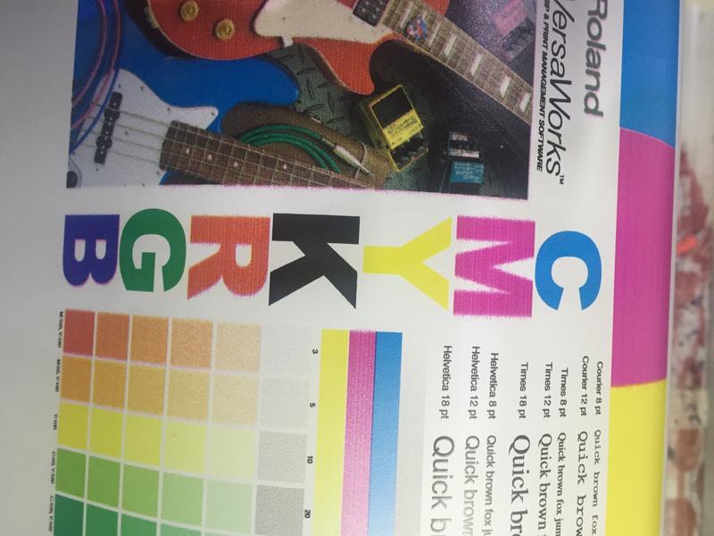

Hi have a problem with magenta on the roland VP540i, I am getting this blur or overspray .. I have changed the data cableswith new ones but still the same issue...
has anybody had this problem?
thanks

You need to clean your magenta head(from the little I can see on the test print on the bottom of your picture)

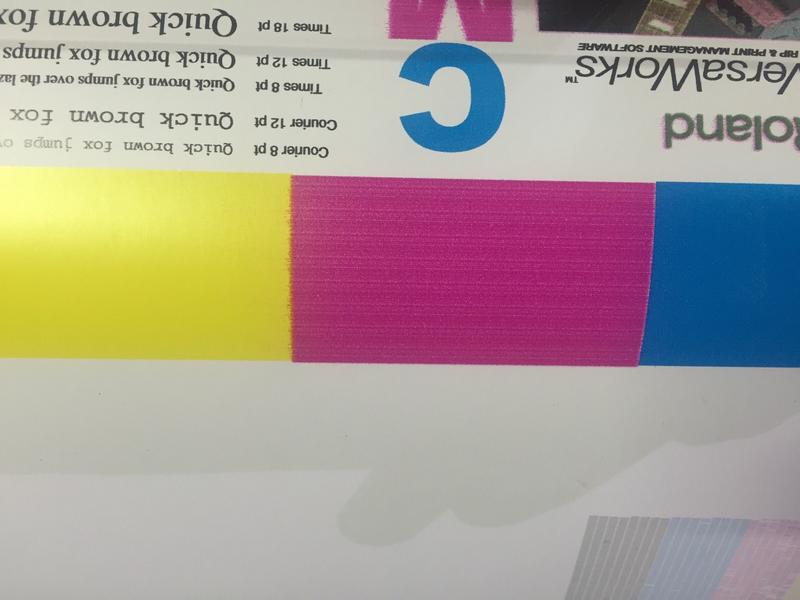

vance
I will post a print test shortly.. here is another picture... its looks like there is serious deviation. Is there any solution I could try, or is the head gone?!

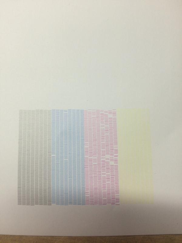

vance
here is the print test. I have also changed the manifold by the way, could this be a calibration error?
I have also done a manual head cleaning, with very little preassure not to brake anything inside... I could see the spray deviated.

player
You're not supposed to touch the heads. Is that how you clean them?
vance
yes I know, this is always last resort before buying a new head.
Could it be the head height? I have also changed the datacables and print head fuses.
Anybody has some information on how to calibrate the head height.
