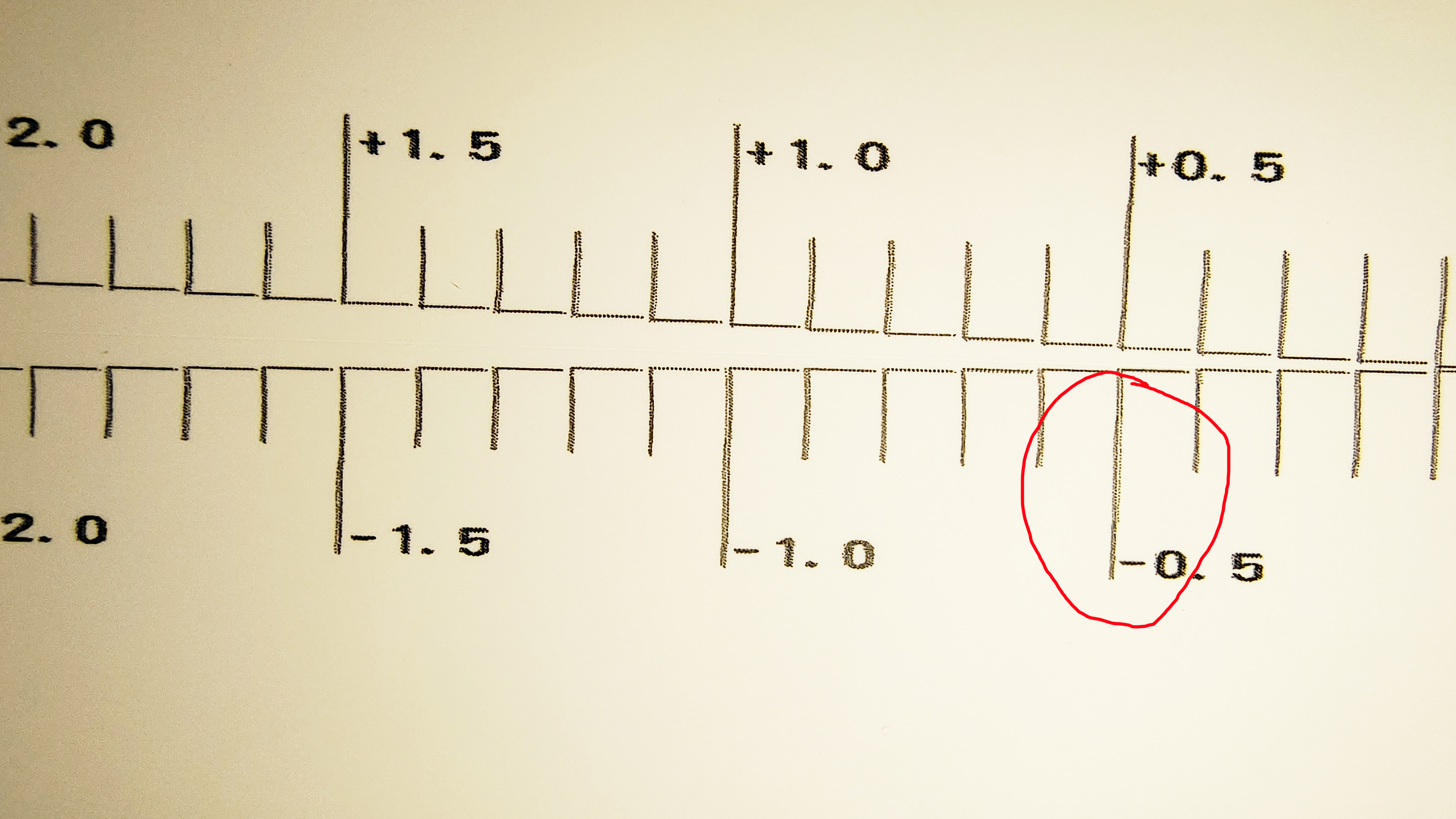

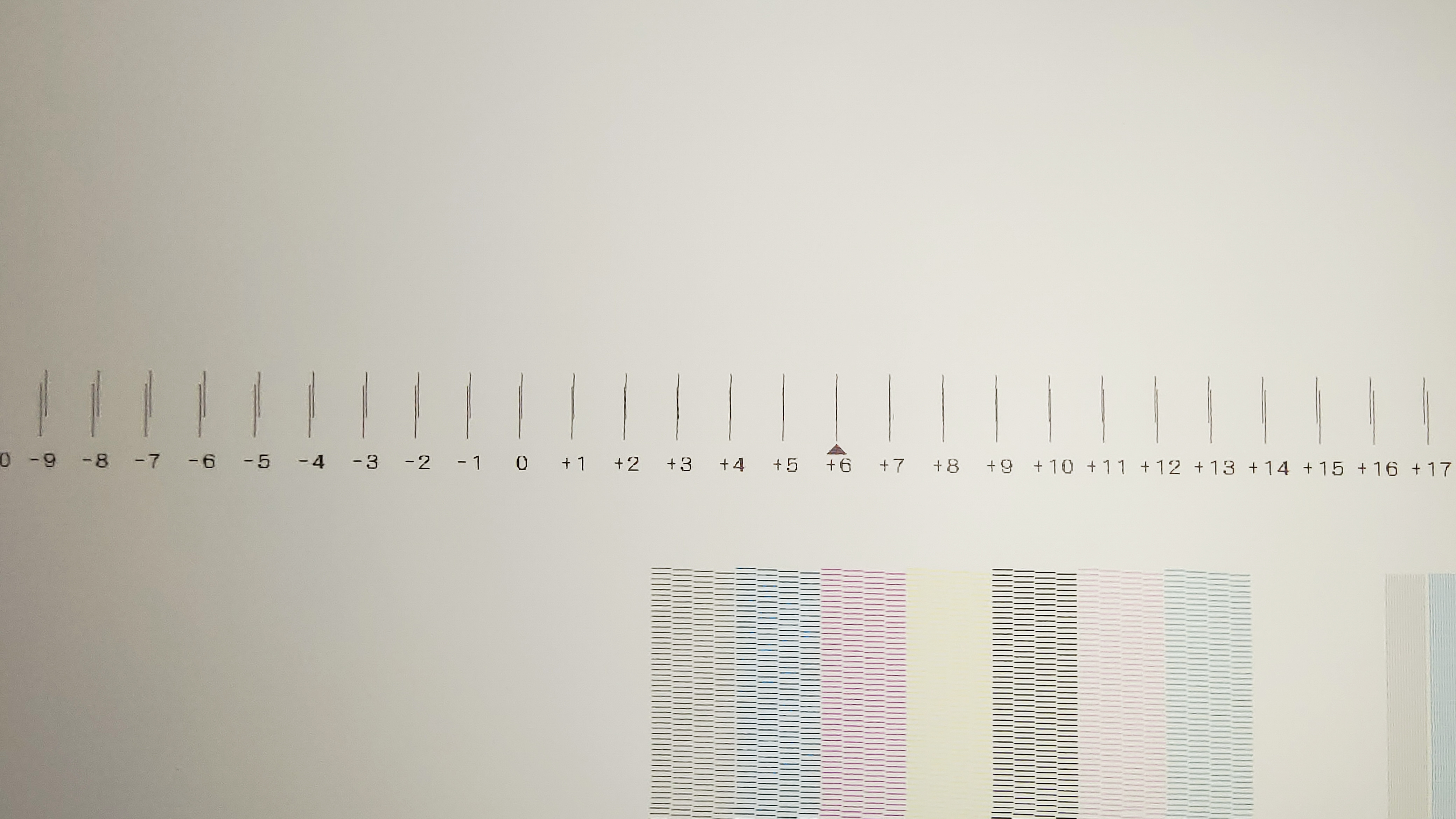

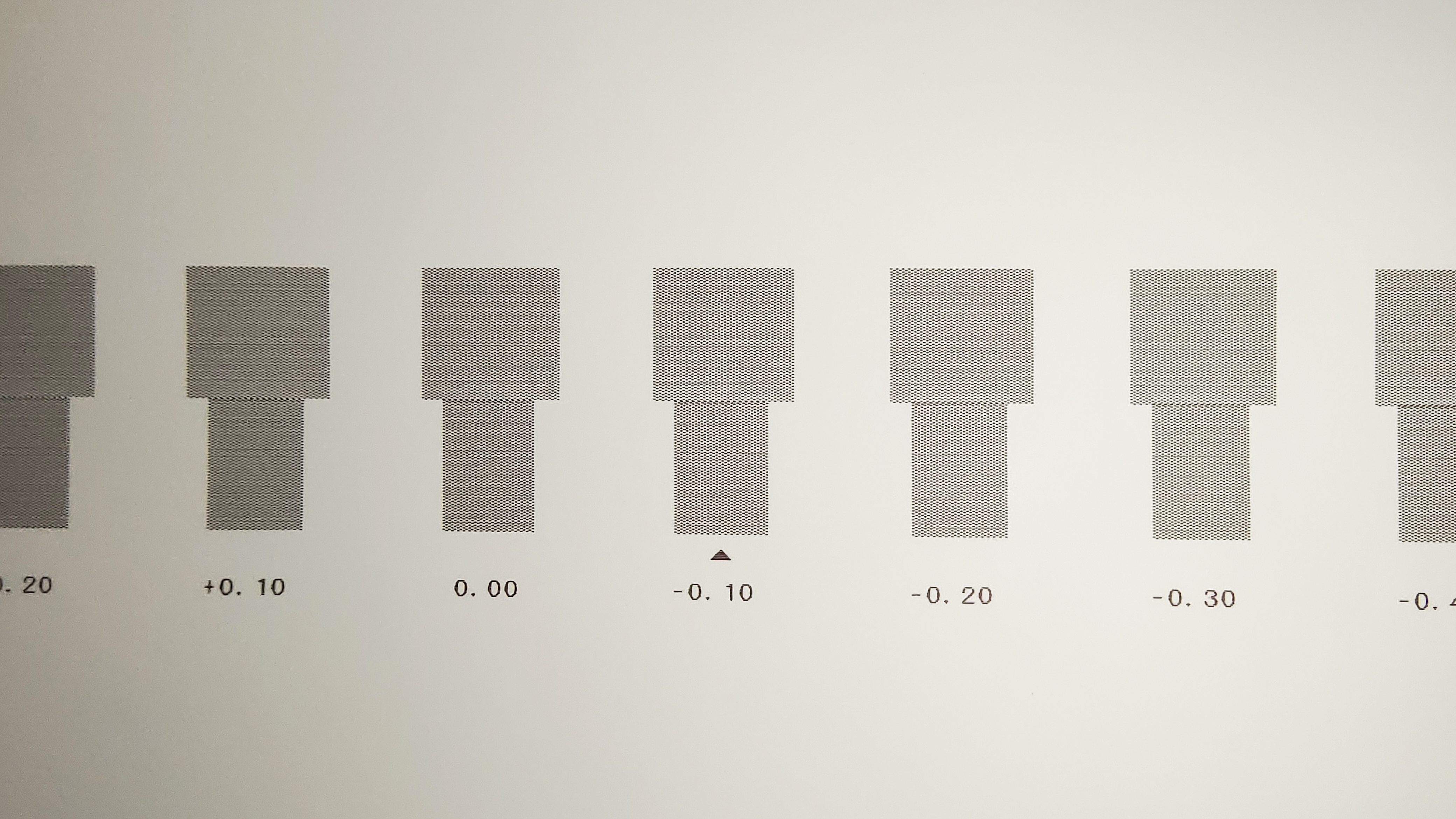

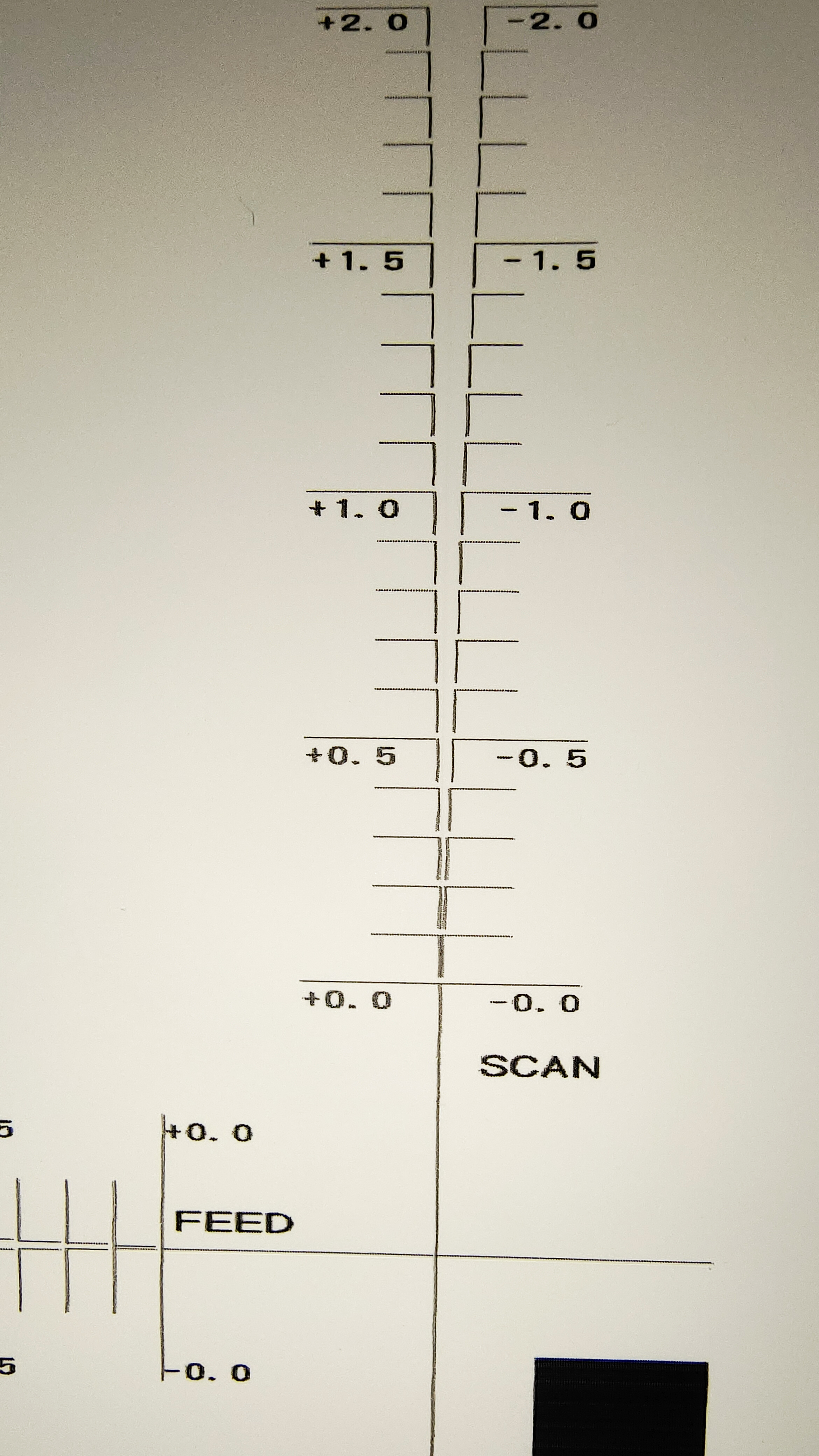

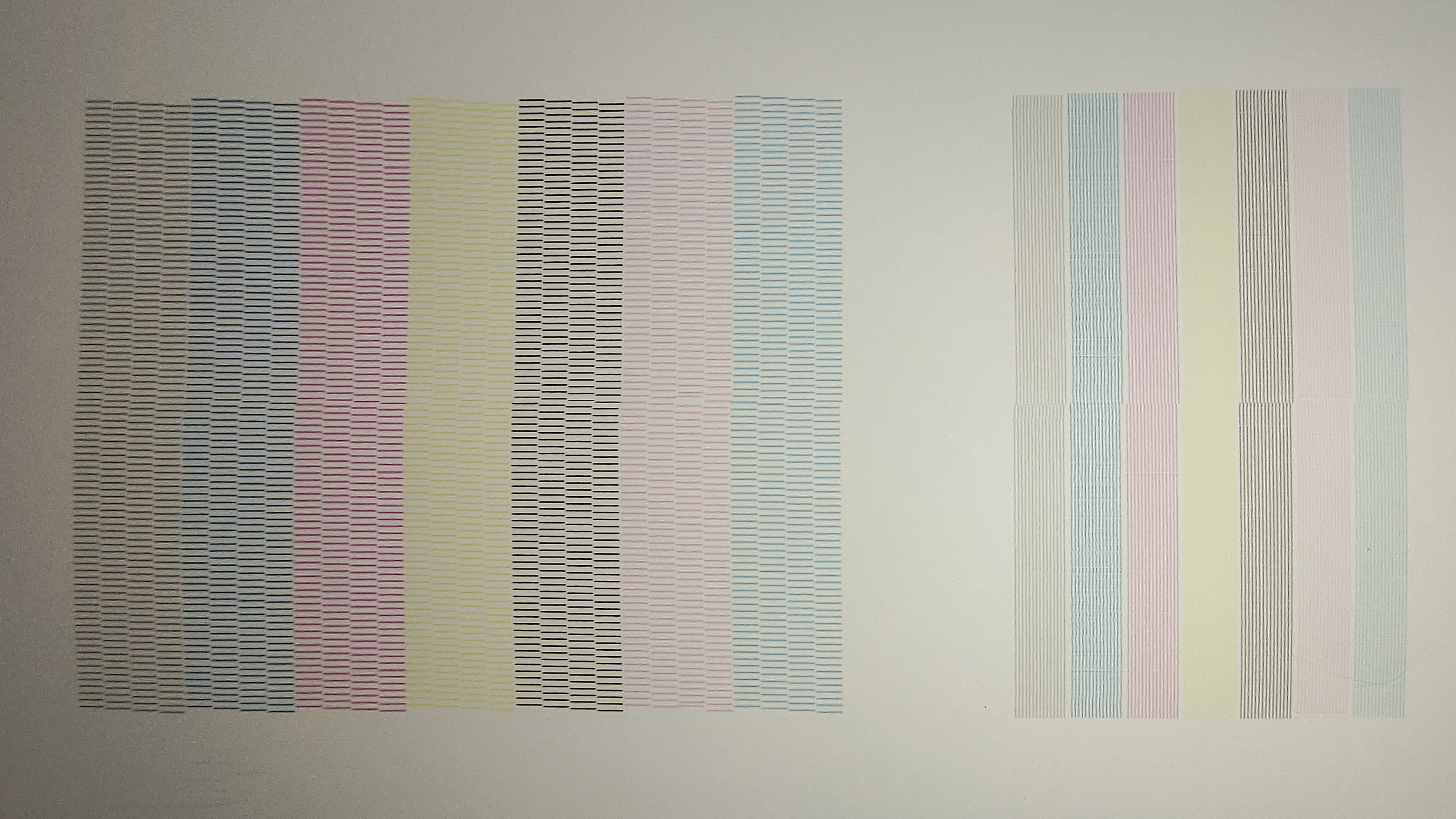

Hi, My VS300i did not find that the printing effect was not good and was affected when printing large pictures at ordinary times, but problems were found when printing fine lines. The print head was calibrated and aligned, but the lines printed in Scan direction would be offset, and the feed direction was printed well (attached figure). May I know how to calibrate the printing effect in Scan direction,
Thank you!

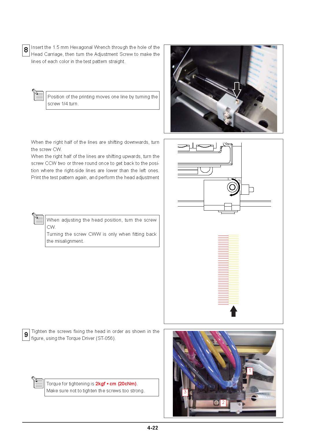

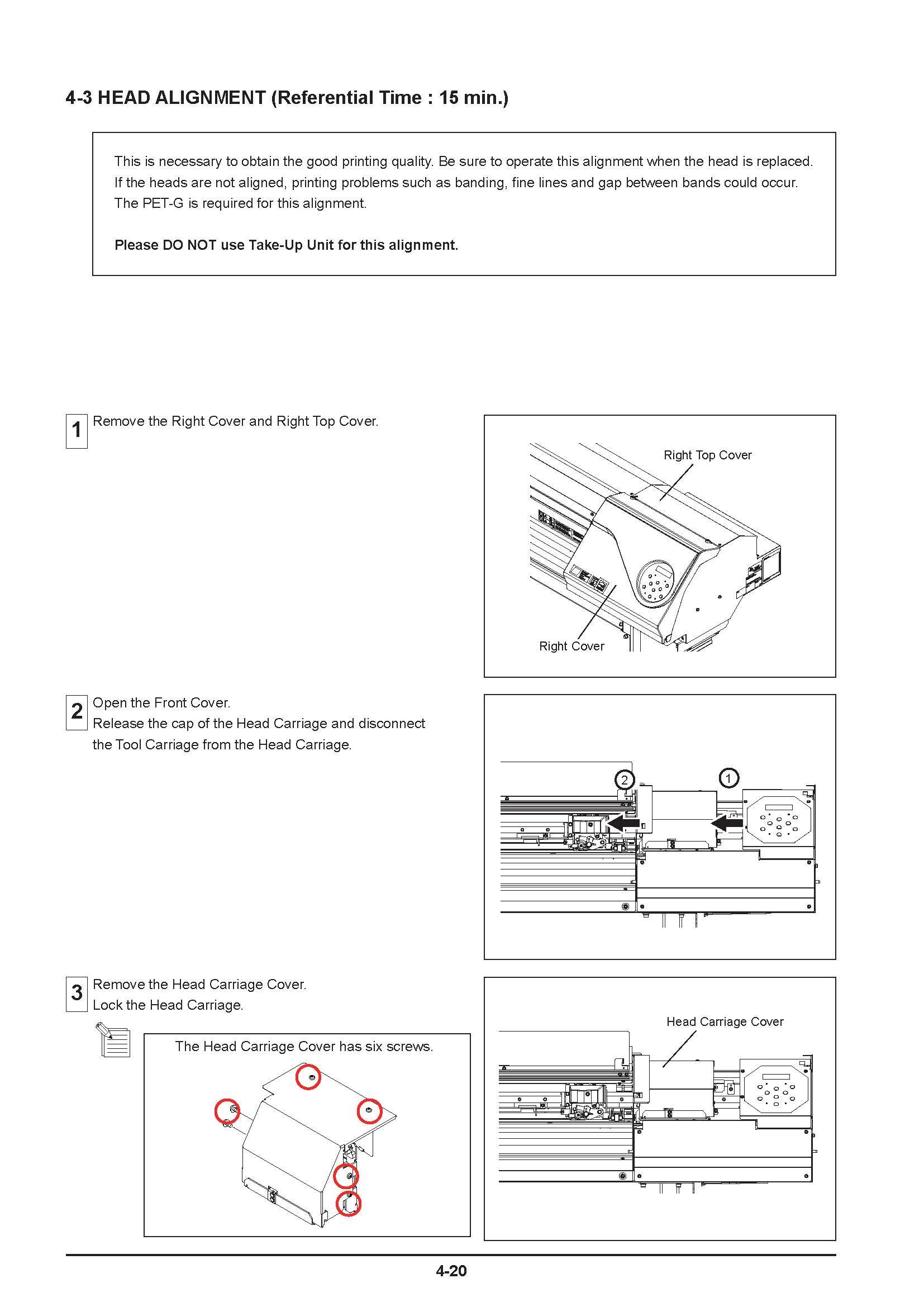

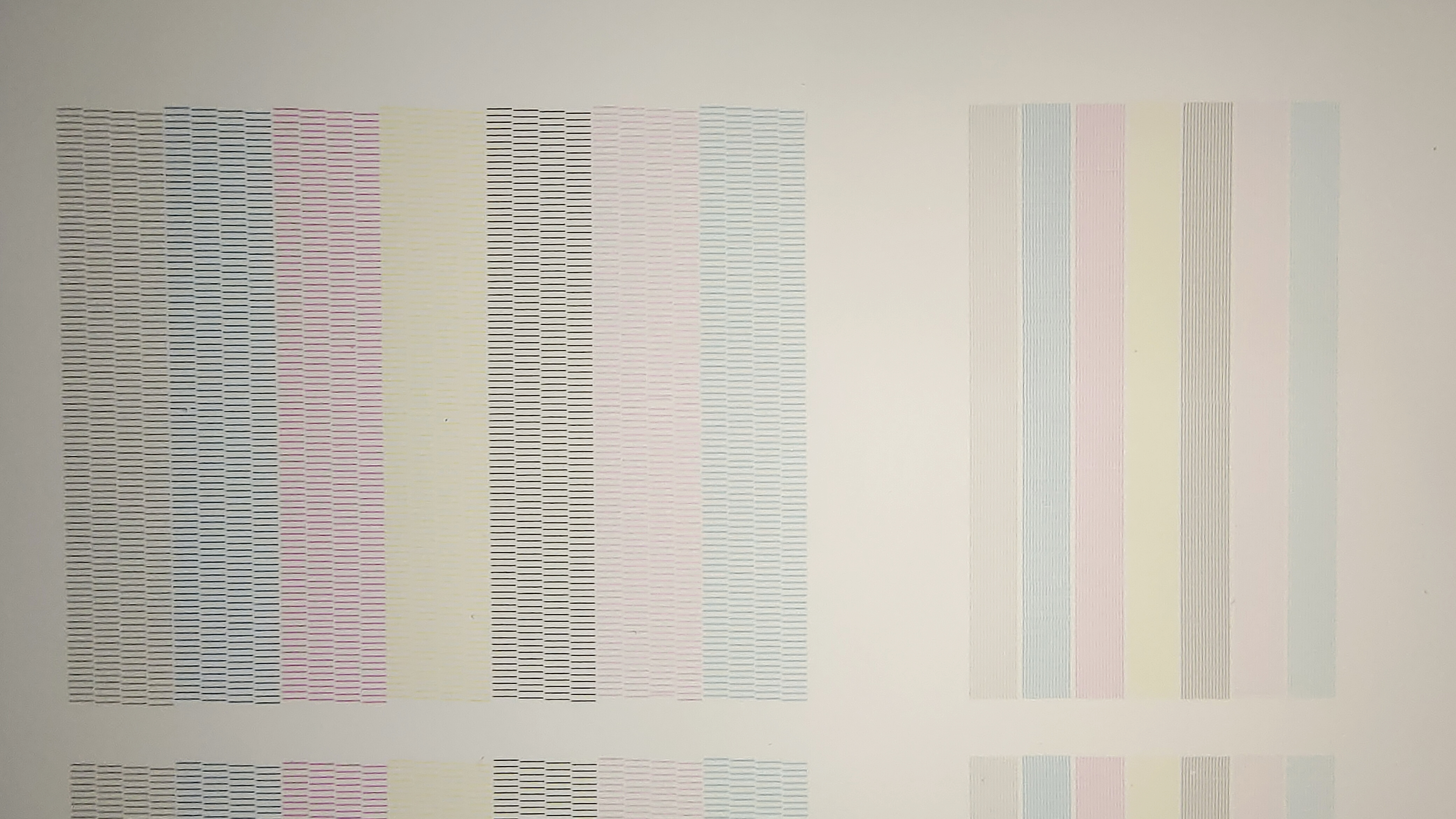

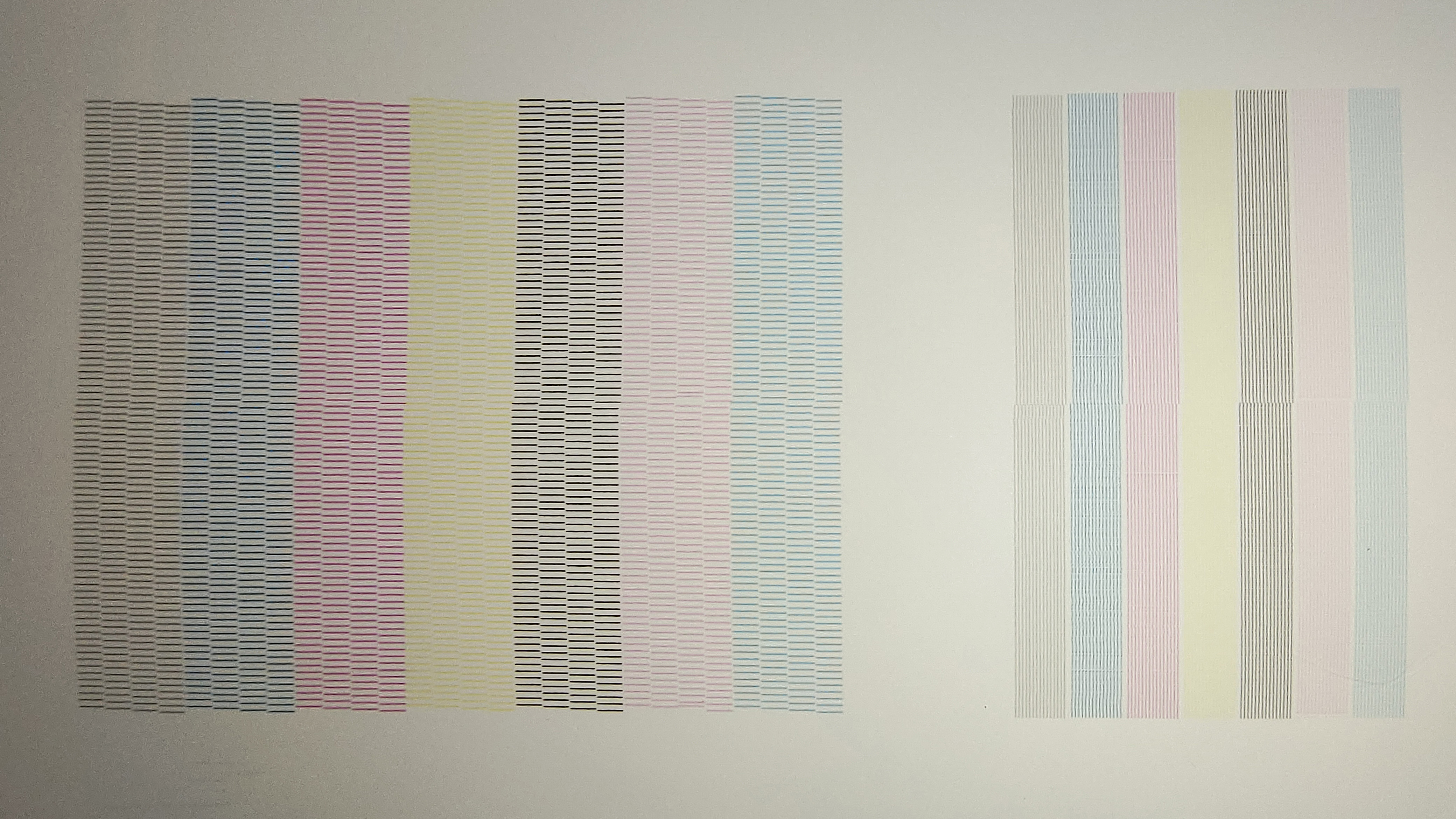

After head alignment, the printing effect is greatly improved, which is satisfactory. Print head calibration requires patience and multiple attempts to achieve the best results. The method is as follows.
