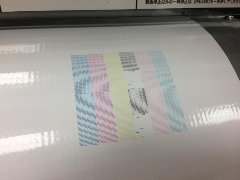

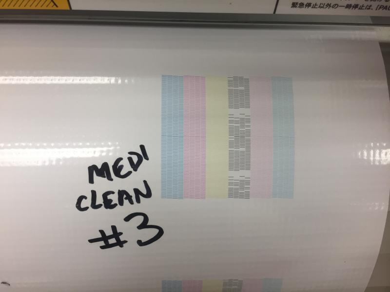

as of a couple of days ago, I started having this issue. The black is going from printing nicely to approx 50% injection after about 20" of printing. Powerful cleaning get the print test back to 98% on black, all other color stay at 100% with beautiful print test.
Print head - all dampers - cap station - replaced 01/2016 by tech.
In the am at start up this is the result -

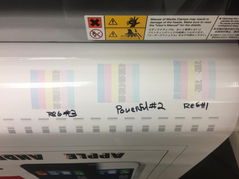

After 3 cleanings -
1st - reg
2nd powerful
3rd reg

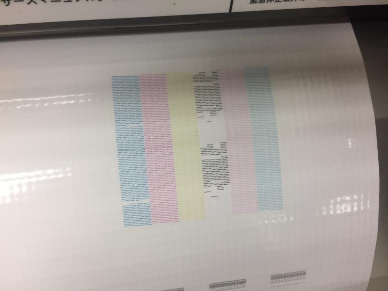

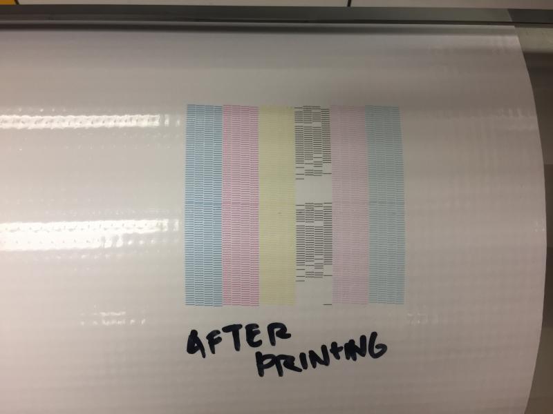

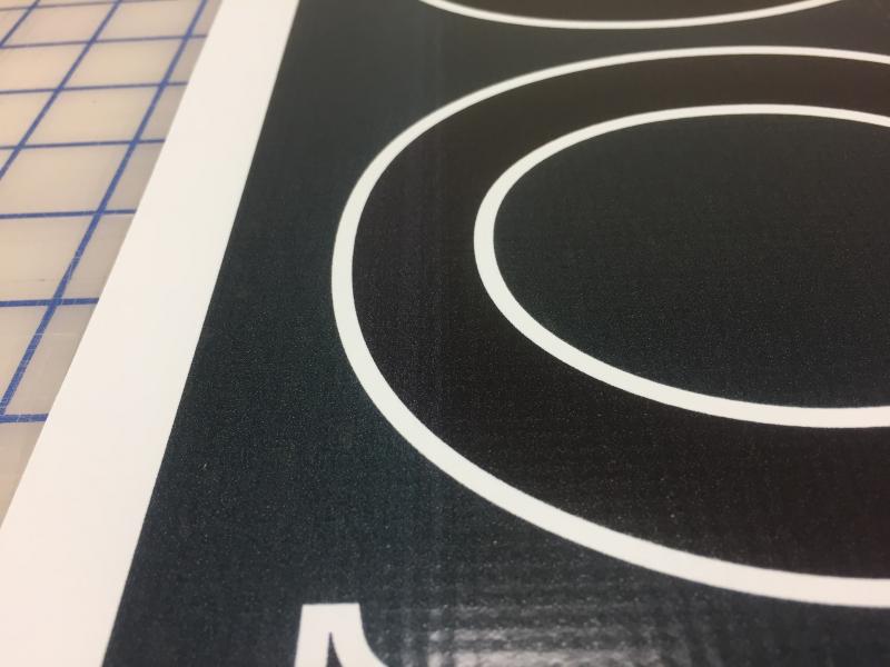

Continue with printing - After approx 20" of printing, notice the instant nozzle blockage creating color shift and banding.
Nozzle check post printing

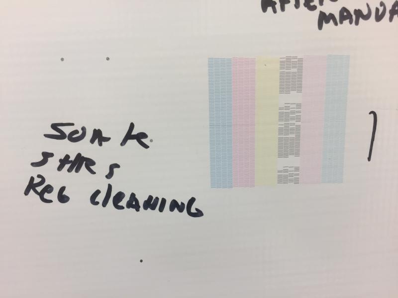

I soaked the head in the capping station for approx 5 hours.

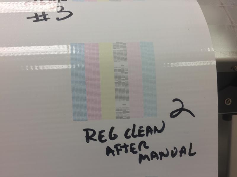

after regular cleaning -

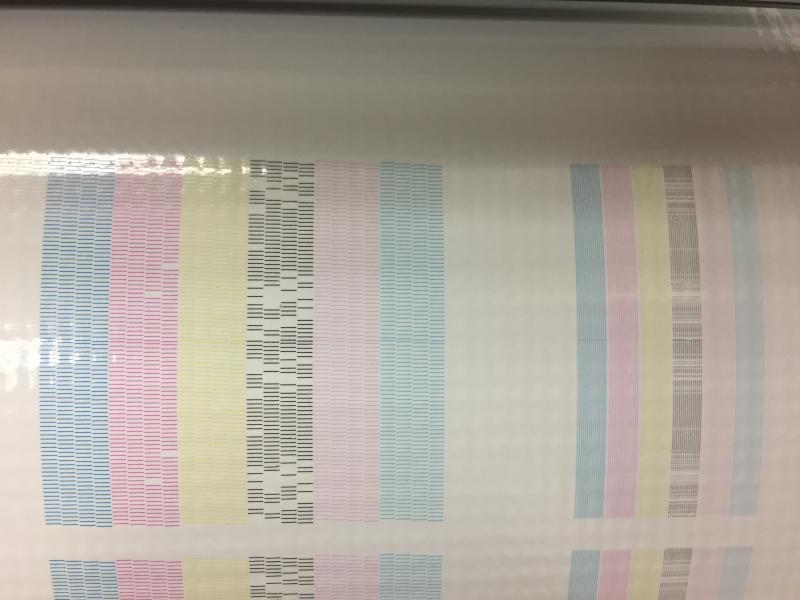

regular cleaning and manual cleaning

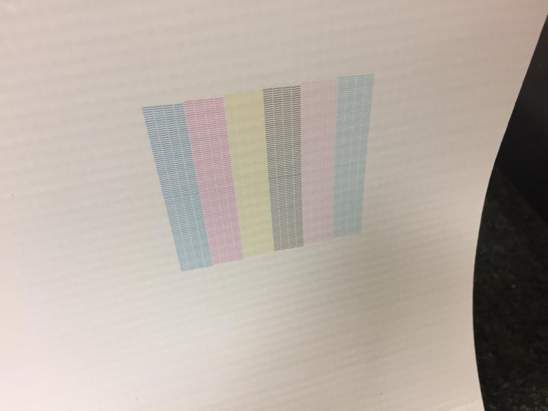

Medium cleaning
I have the following parts on the way, damper and cap station.
Any help and advice would be greatly appreciated.
