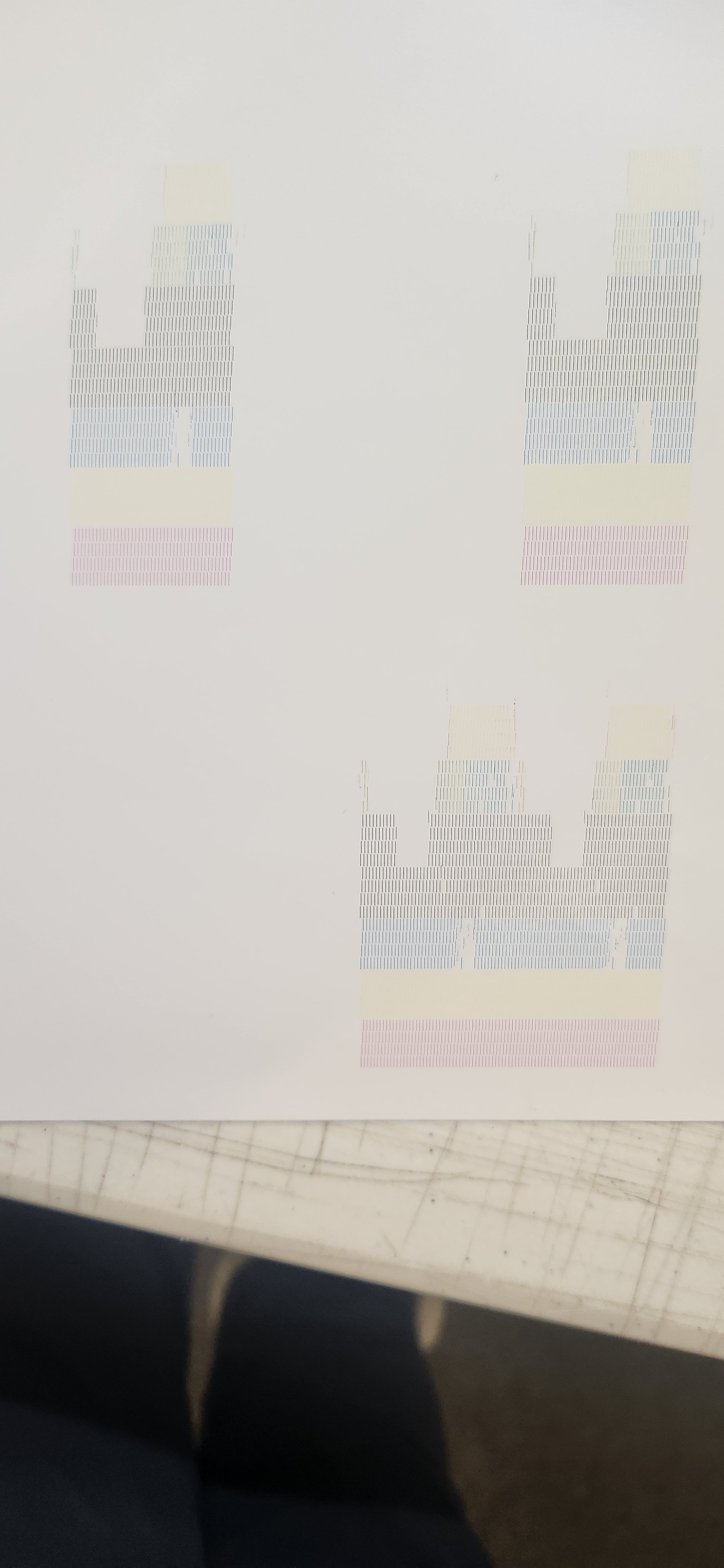

Printer not printing correct color. I did a head soak, still test prints come out poorly. Tried to change the cap top and snapped a nipple on the ink pump. Changed the ink pump but forgot to put the top back on the black and while I have cleaned it pretty well the printer now will not do a test print. Every time I try to set up a print it over feeds itself backwards when trying to do a setup and rolls off of the back. What can I do?

The bottom right was the first one post-ink pump change, then the 2nd it split and that's when I knew something was wrong
