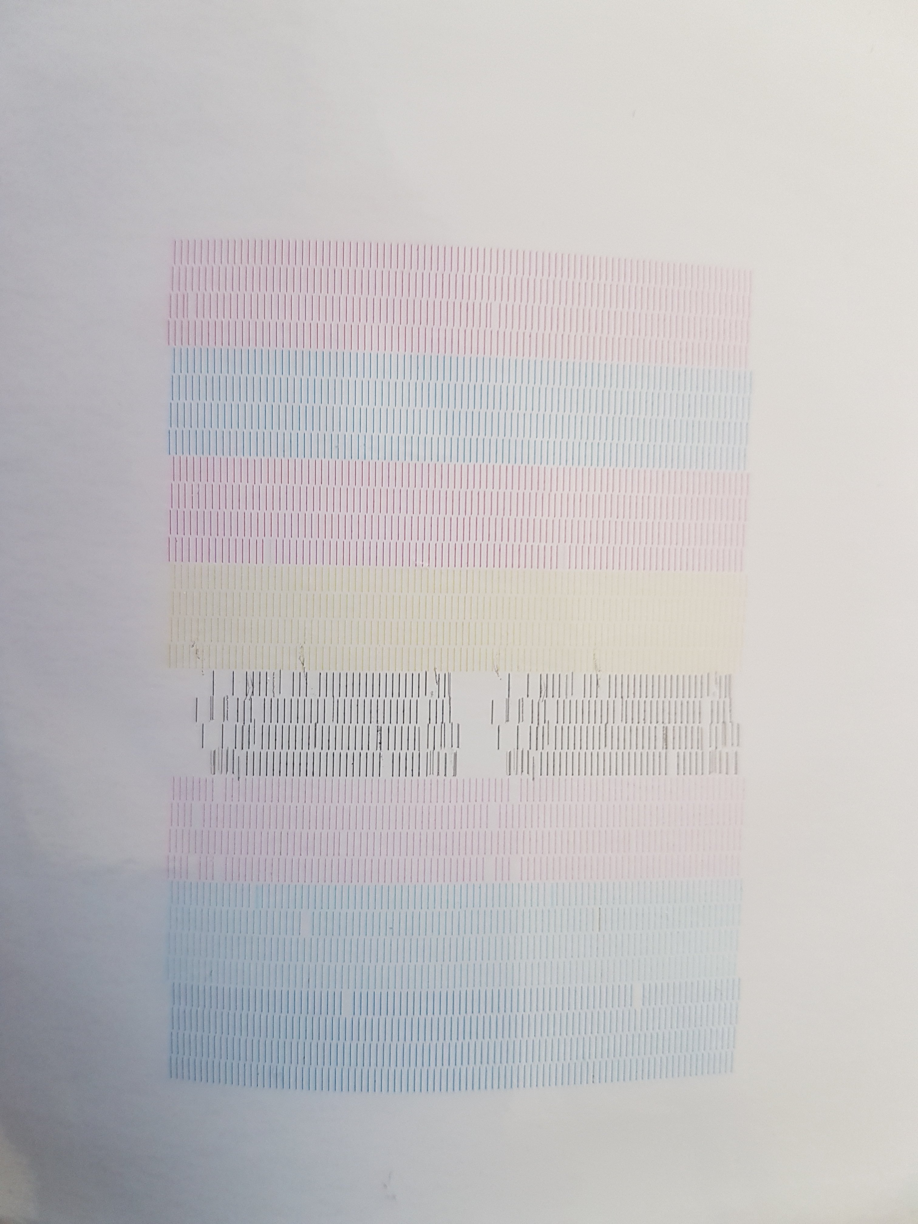

Can anyone point me in the right direction to get my black printing properly? All new Dampers fitted. New Cap Top. Felt and Wiper replaced .Head soak done.
Is the head stuffed?
Thank you in advance.
Mark
PS Test print attached

Hi Mark,
Does it get any better when you run a Medium clean? I get that after a couple of days of no use, and it usually takes 3 or so Medium cleanings. If no change, maybe it's clogged.

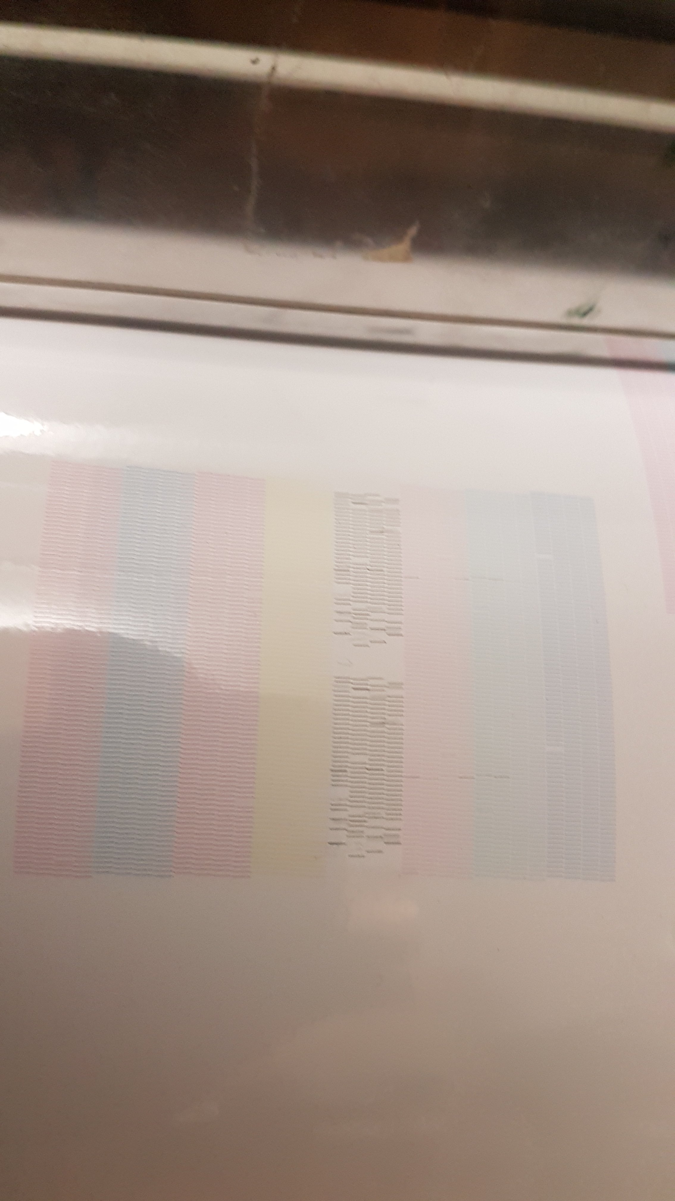

Hi Darryn. Thank you for replying!
Here is the result from after 2 medium cleans and a powerful. There seems to be no change ( or very little)
Any other suggestions?
Thank you again
MP Custom
If it doesn't change when you do a cleaning, it's most likely clogged and you'll need to replace the head.
