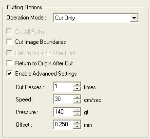

For us with IJ180/8518:
Make sure your blade point is just barely peeking out of the blade holder.

adjusted the blade physically just slightly peeking on the holder. Followed the specs. It shredded the vinyl IJ180. Although this one's not laminated. Would it make any difference? thanks

Not laminated would make a big difference, I'd try a test cut around 70 to start.
