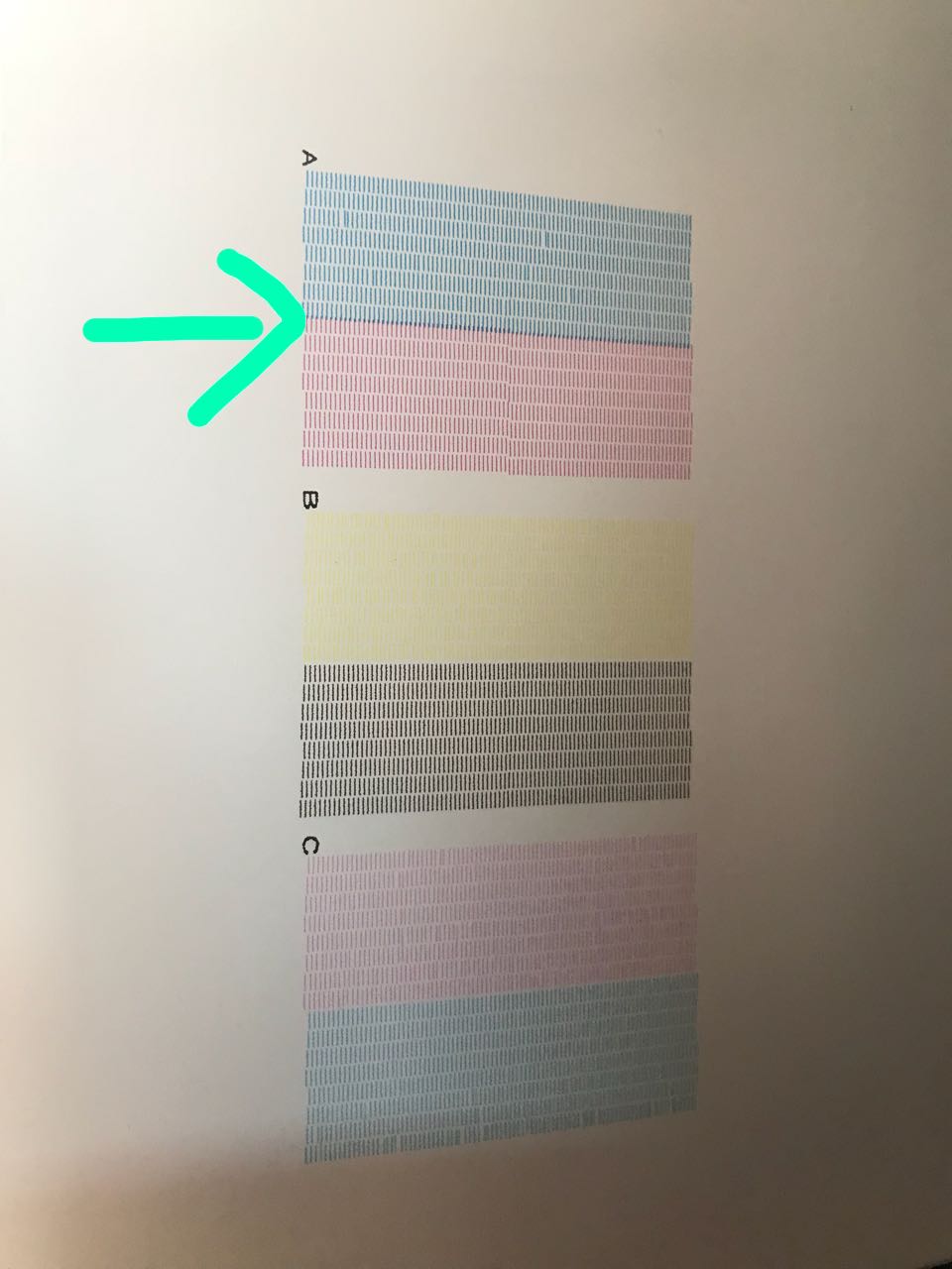

hello!i am new in this forum.i need hellp.my roland xc 540 has a problem.i change a head print (magenta) cap and damper.the problem is following in this pictures(overlap magenta to blue).how to fix it pleaseeeee

Did YOU change the print head? It appears to be placed too far to one side. Did you use the manual and make the timing adjustments for the head so it fires at the right times (and therefore the right position(s))?
asd
get your hands on a service manual and follow the instructions to align the head
Joe House
Sign Equipment Technician
You need to perform the bias, vertical and horizontal alignments as well as the bidirectional default calibration when you replace a head. These are all in the service menu
