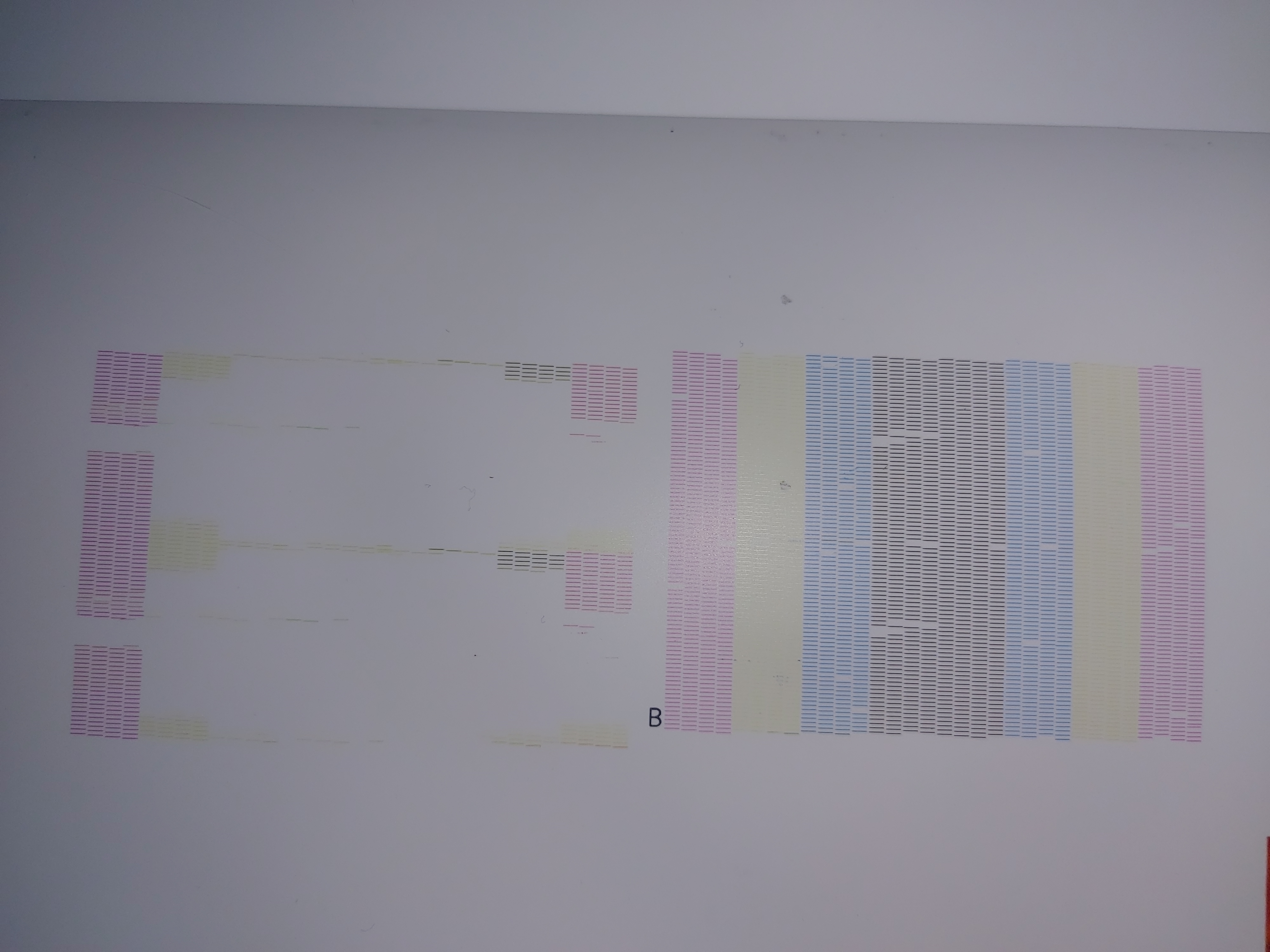

I purchased this machine used and upon viewing and before loading the machine it was doing two printsa and working pretty fine.
So loading it moving it and reinstalling it all mayhem broke loose.
1closer inspection showed a broken felt clip.
2.print head A has obvious indents on its print face.
3.replaced felt clips felt and wipers.
4.put new cleaning caps in the station and checked drains and pumps as well as flushed.
5.cleaned up everything and did a test print. A and B gave good nozzle results regardless of A's damage.
6.ran a sample print and came out pretty good.
Did 2 more prints and progressively got worse and worse and with terrible banding.
Did another test print and head A only has 8% of nozzles firing.
Cleaned choked and went as far as swapping over printer head positions and still does the same print head B position works good.
Swappedbout ribbons same thing.
Checked all fuses on head board are good.
Main board ribbons to print head PC look good too.
Ive determined its not the head or the dampers as ive interchanged them between the heads as well.
Any help please
