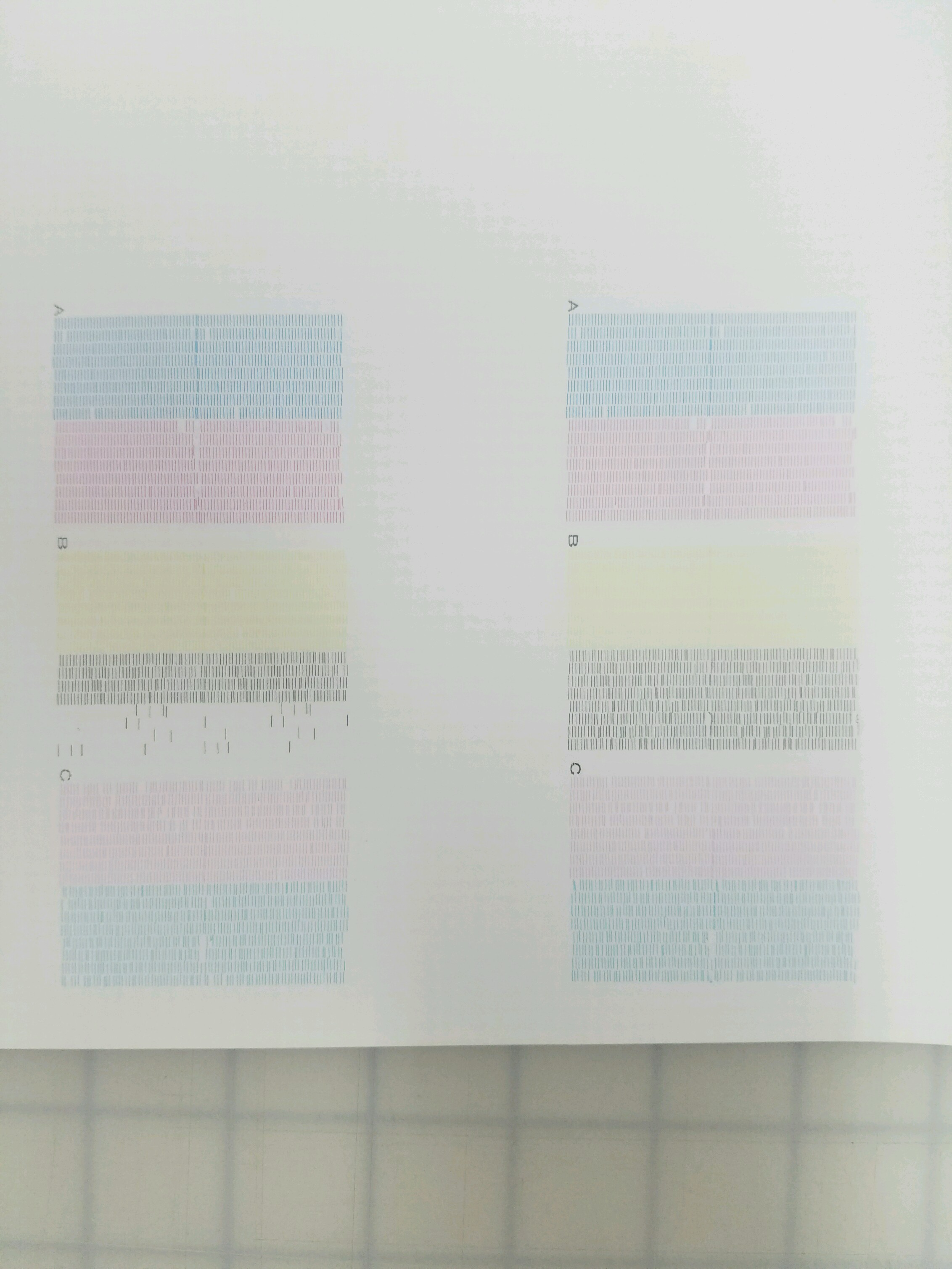

We are running continuous banners on our XJ-740. They are grouped in 5's then the next group of 5 will start without hesitation but it has lost some of the black (printing grey). The test print shows half of the black printing, then I run a cleaning and it will come back and print again great for a while.

Odds are you have either a bad damper or cracked print head manifold or both. When you go to replace the dampers on that machine make sure to charge them with ink. Install new damper, hold upside down and take a syringe and pull ink through the damper until most the air is out and is filled with ink.
