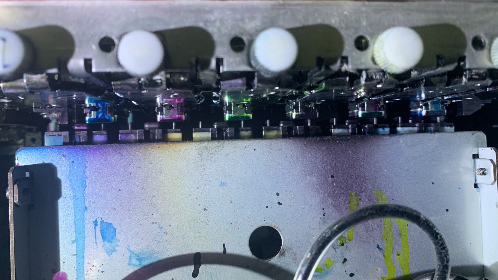

I have a Roland XJ 740 which I changed the carriage belt, scan motor, encoder scale and sensor. I did the limit initialization and the linear encoder test and both passed successfully.
The problem I’m faced with is whenever the carriage leaves the capping station and comes back to park on top of the cap top, the heads are off center (the carriage drifts more and more to the right each time) leaving the heads exposed and park on top of the black vertical plastic frame beside the cap top which eventually gonna cost me some heads .
I did a sensor check test and all seem well. I even cleaned the sensor that the carriage plating goes through.
I’m not sure what I’m over looking. Any help will be greatly appreciated.

Clean the encoder strip more above the capping station, do another limit initialization and make sure you set it on the lock correctly.
I’ll do that when I get in tomorrow. Cleaning with isopropyl alcohol would do? When you say lock correctly, you are referring to having the cap tops lock onto the heads fully when doing the limit initialization?

This sounds like a dirty linear encoder or the the reader. I second Terry01’s comment about cleaning it properly, but then go through all the relevant steps for having replace encoders parts and also reset the counters for those parts for good measure and usage tracking.

It’s a possibility that the encoder scale by the capping station may have finger prints on it from the installation process which was a little tight to work around.

The only other thing I can think of, is the capping station height hasn't been set and the two locators aren't positioning the head carriage properly.

I think I made a break through. The problem seem to be with the encoder sensor. After comparing the old and the new one, the old one was made in Japan and the new one was made in China.
I cleaned the old one with a cleaning cloth and alcohol and reinstalled it and did the setups all over and everything worked. I’m not sure if the new one had a factory fault or something.
After doing several scan aging and recapping, the head comes back to the correct position to be capped with the cap top.
