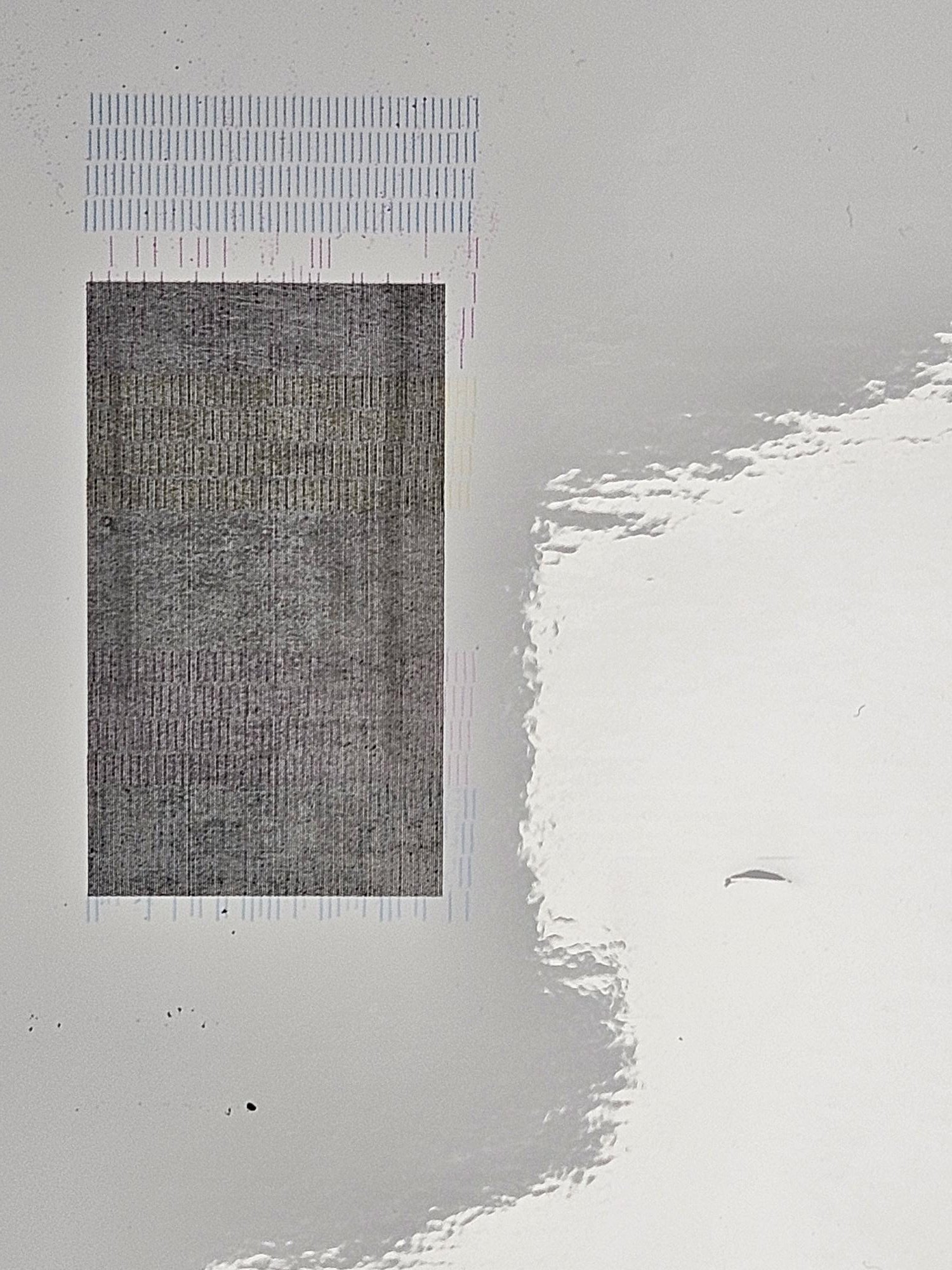

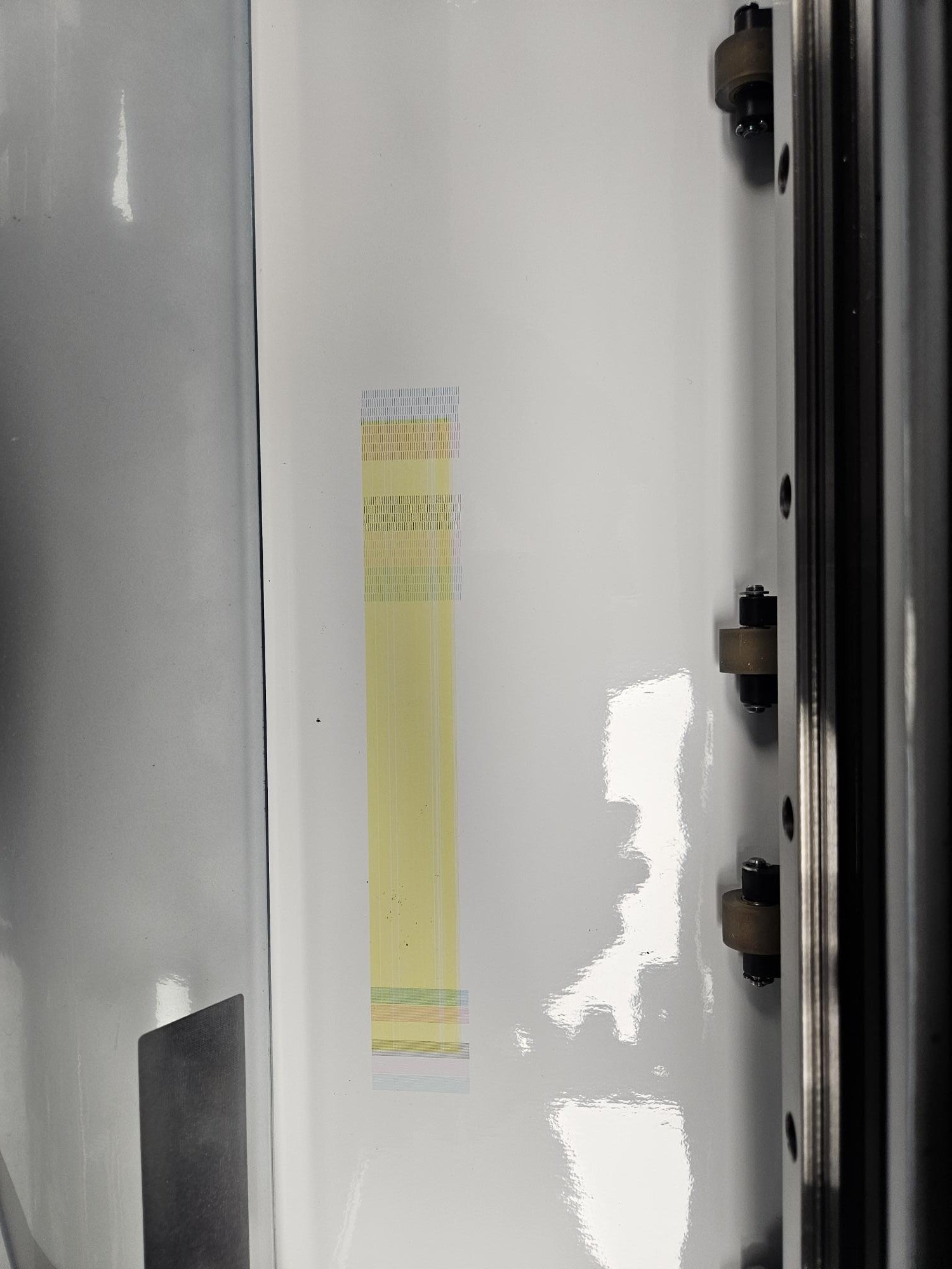

after all that . Print head A prints a good tested print. Head B A yellow band the size of head over top of test print .
Then I print again. Then its faults after it prints like this . service call 0250

the yellow band going across means that head is bad, or the cable (or of course that board)
over the years 3 of my black heads have gone bad that way
IT'S ALWAYS POSSIBLE one of the capacitors is leaky, or one of the small transistors further back is bad.
if you actually removed the transistors to test, it is possible that one of the insulators is installed incorrectly
