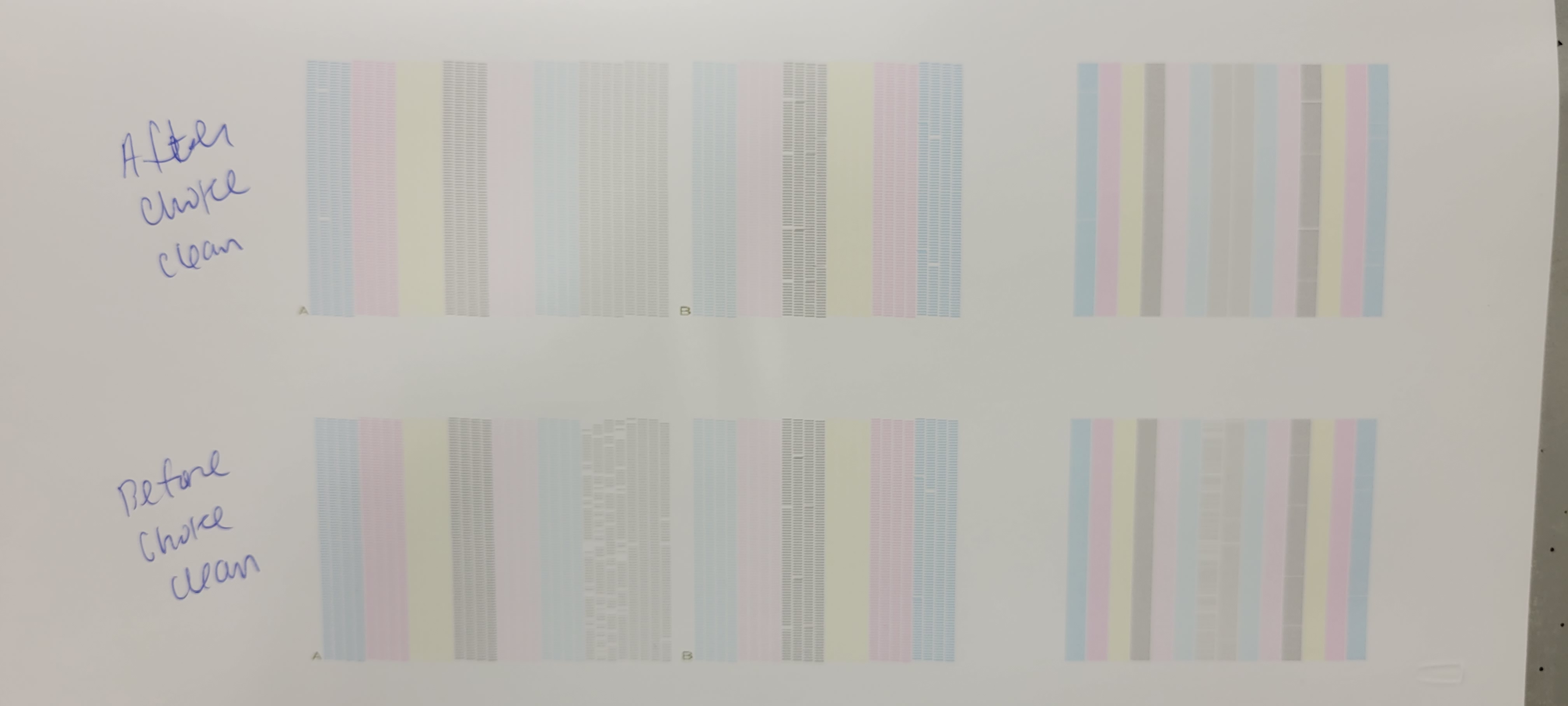

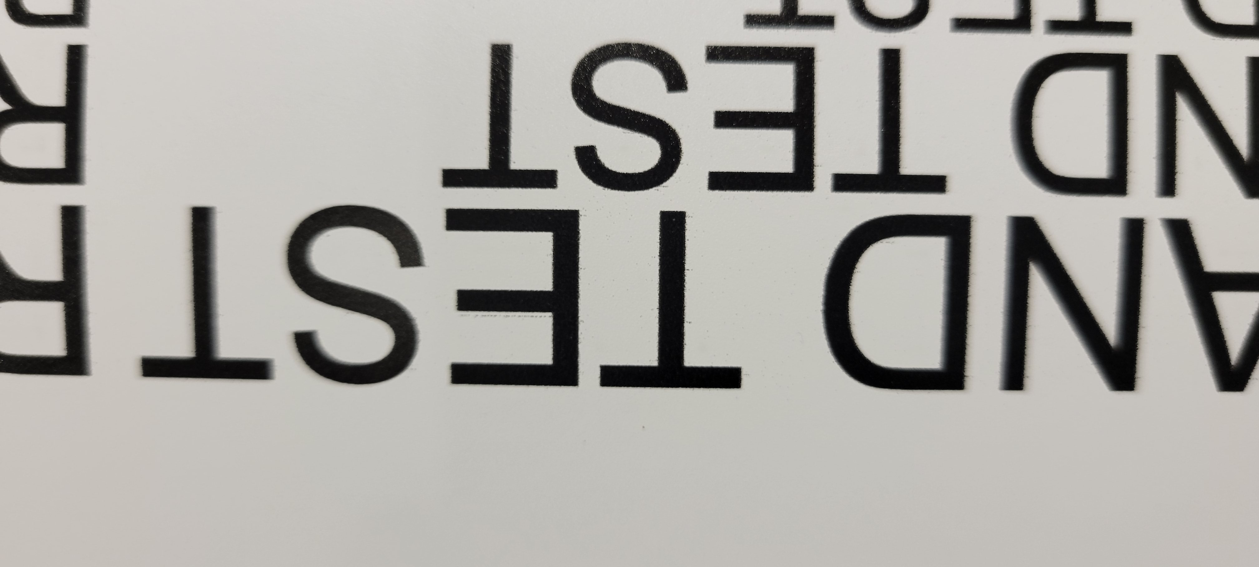

I've attached some pictures of the current test print (before and after a choke clean - not all nozzles were firing right away after head was installed) as well as a close up of the overspray and streaking.

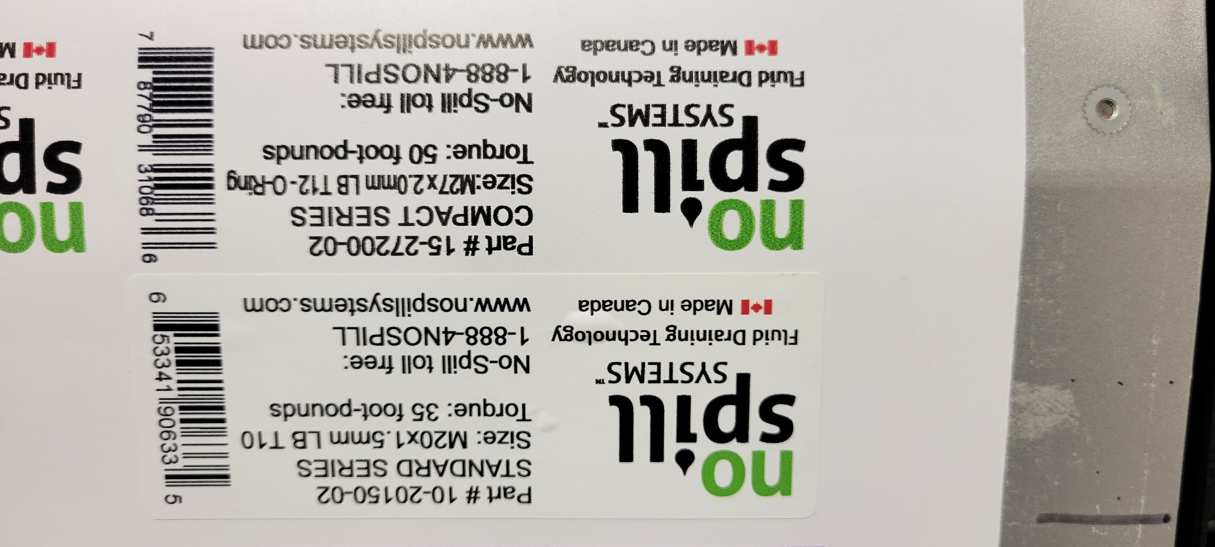

I've also attached a picture of a label that we've printed thousands of times before for comparison. New current version on top, old good version below.
Overspray seems to only be happening with black - if you run other colors it isn't really present but overall print quality is just crap.

On the label example you shared it sort of looks like the difference between a low and high head height print. I've had similar results (blurry/overspray) after I've forgotten to lower the head height after printing a banner and then printing on a vinyl sticker afterwards. Just checking to see if maybe the head height has been changed?
It does indeed look like head height is set to high, but it's not. Thanks for the suggestion though!

It looks like the black is over spraying and the black nozzle check is deflecting so that's probably the answer. The tech can try to clean and recover those deflecting nozzles but if they can't, you'll probably need a new head if you can't live with the over spray.
