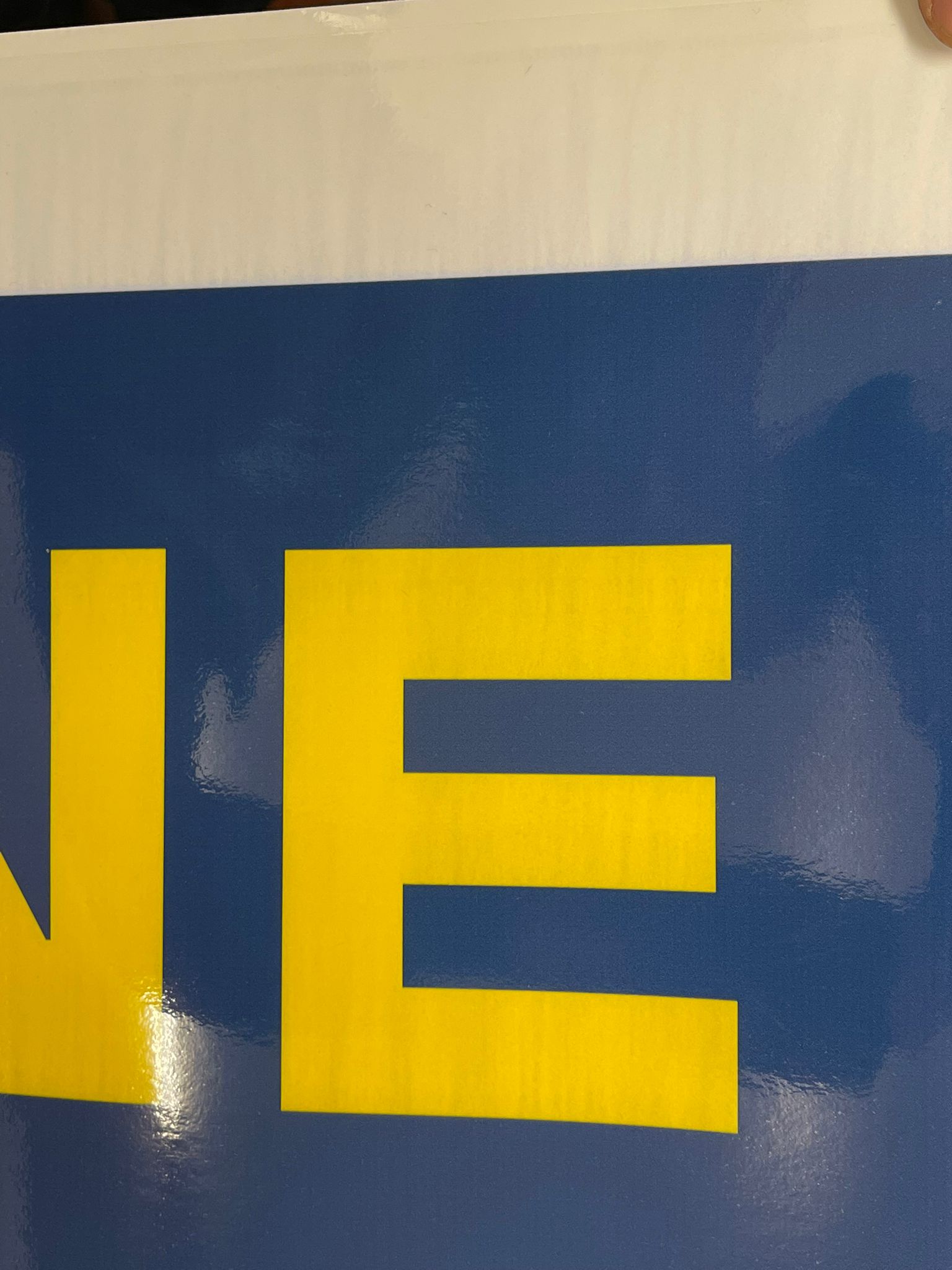

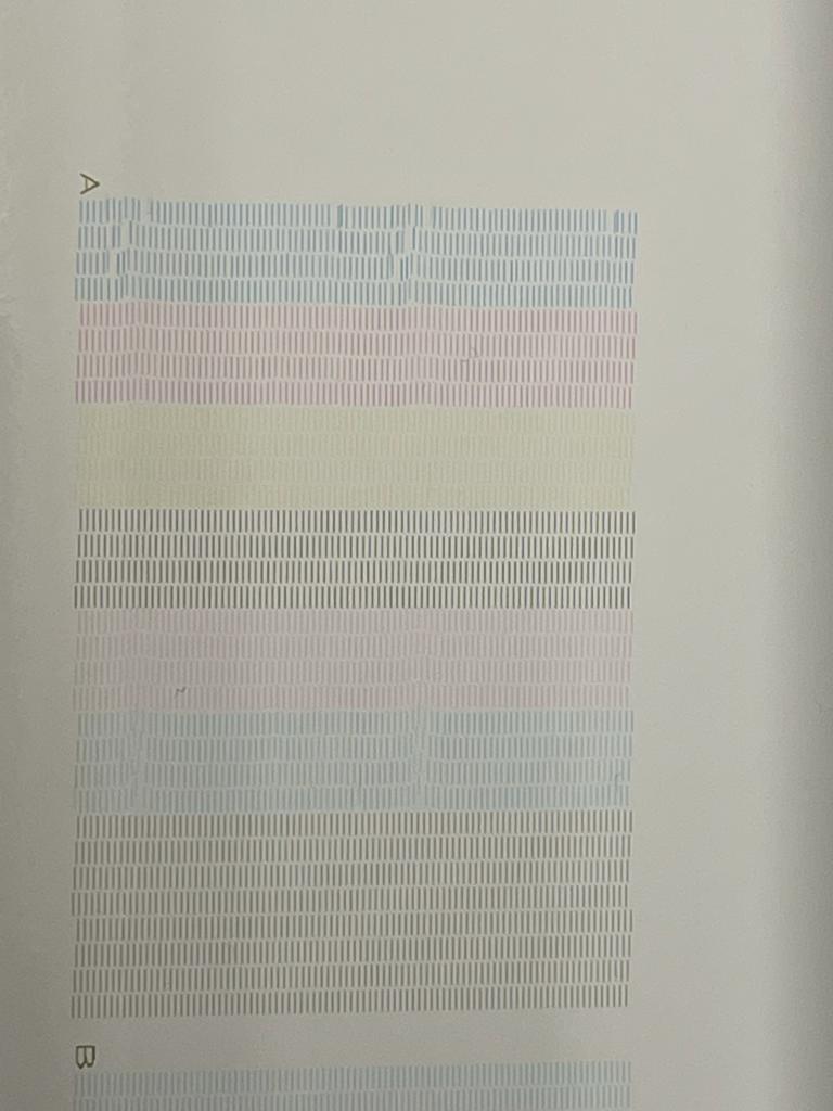

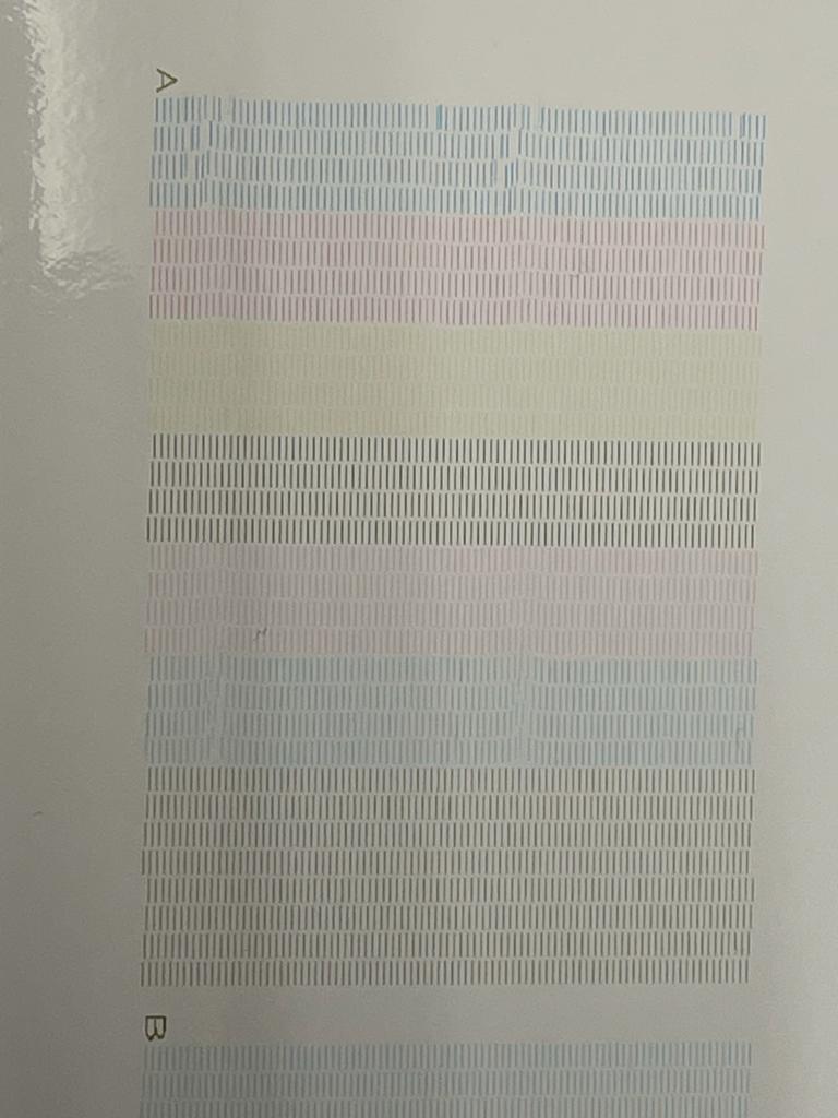

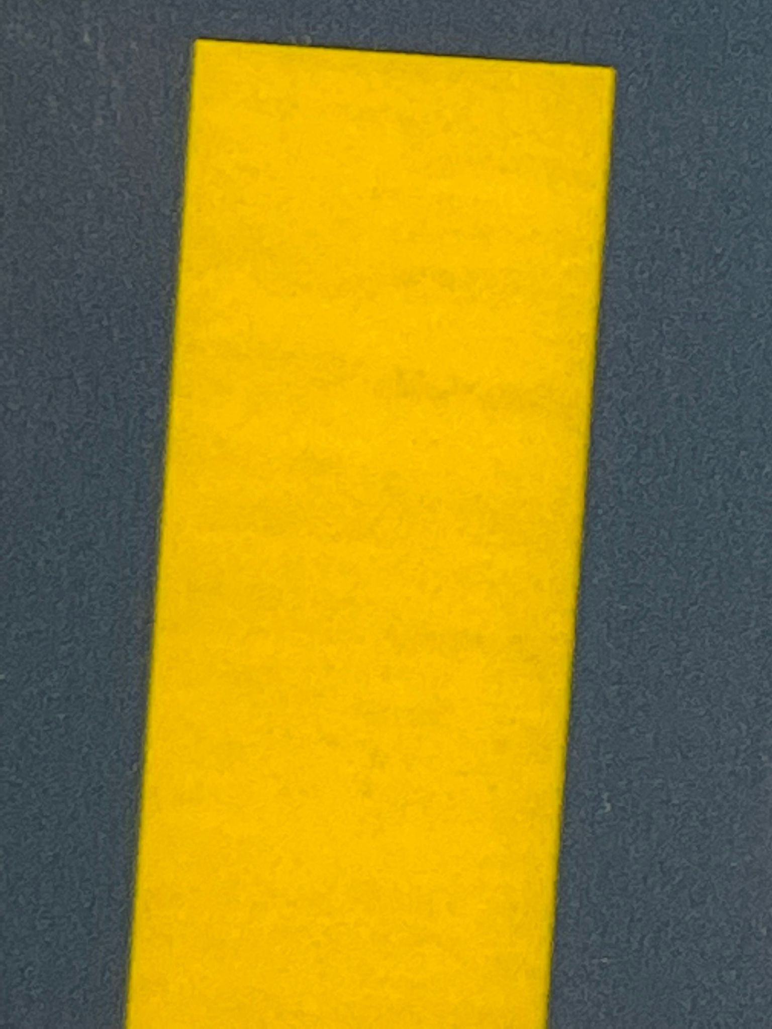

I'm working with an Soljet Pro 4 XR 640 setup CMYK Lc Lm Lk Wh. I just notice that the printer has a problem, is printing with a shadow or something like it. Please see the attached photos, dose anyone know what is the problem ? I've added some pictures of test print as well.

There is definitely some issues with your cyan head, looks like it had a head strike or something which is making deflections and warp. Your magenta and light cyan as well. Looks like you might be needing new heads.
