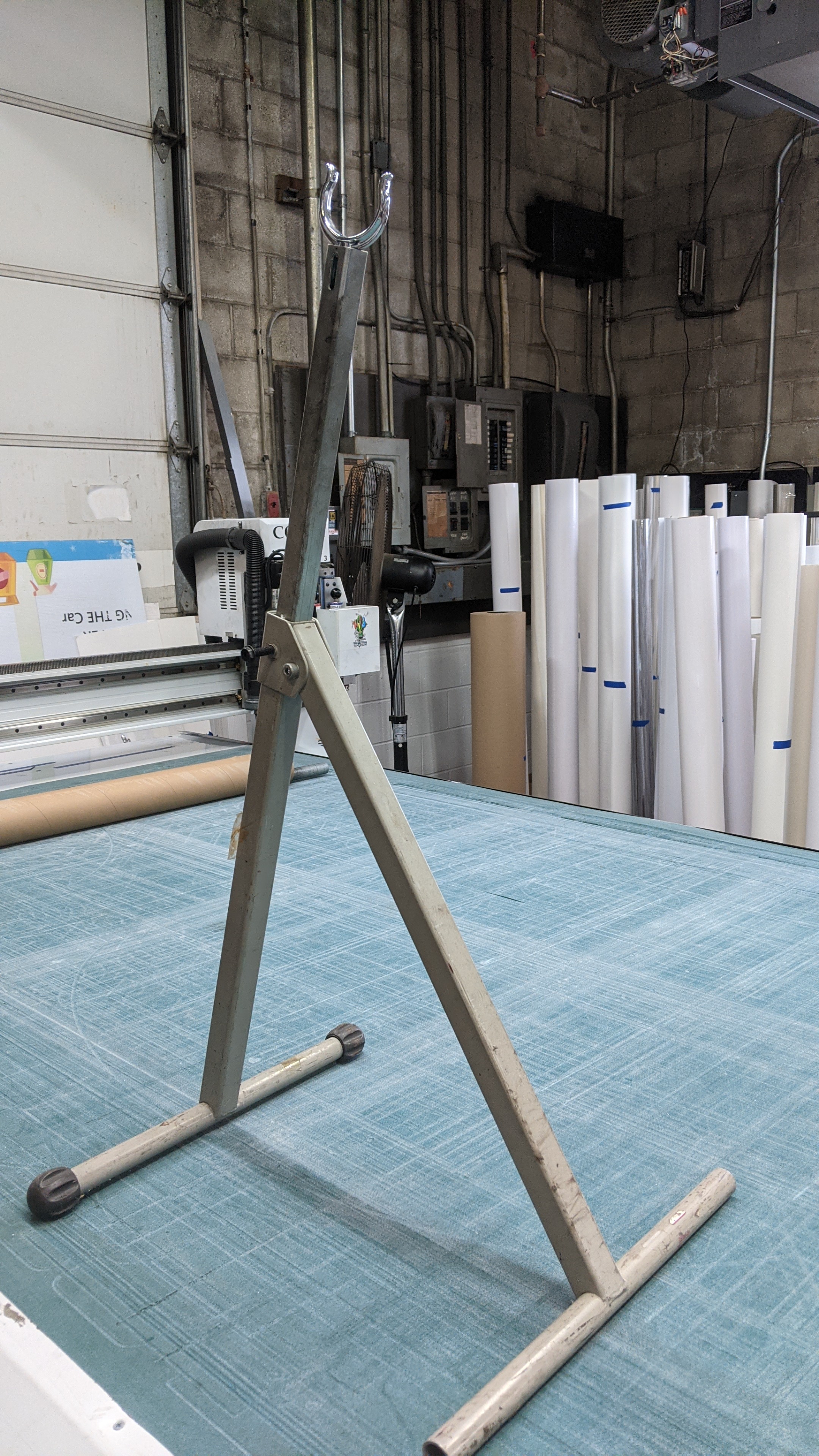

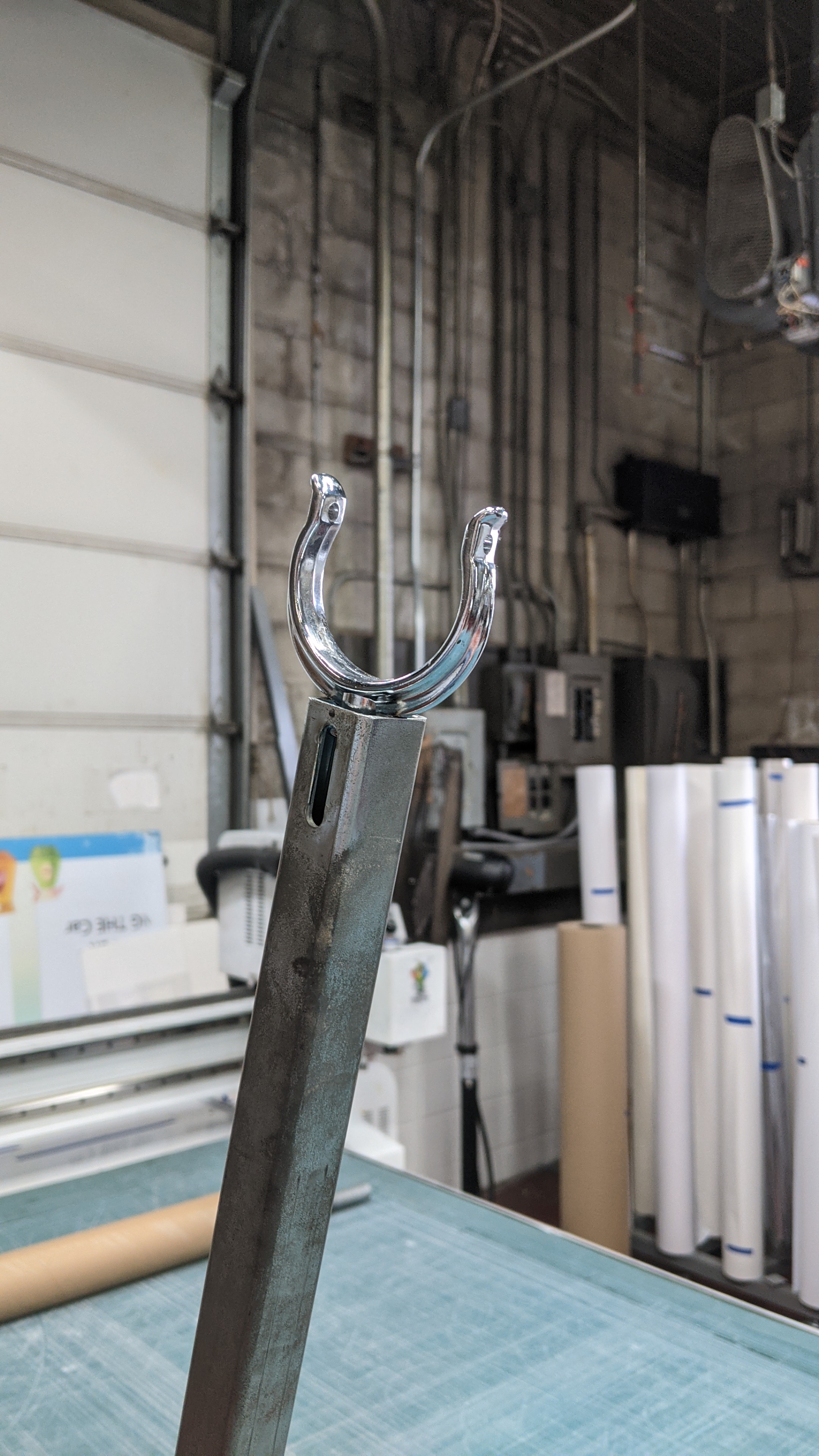

We made something using a couple stands, oar locks and a big pc of conduit. Put the roll on and pull across the table. Doesn't bunch up like can happen with that roller up there.
mind sharing an image?

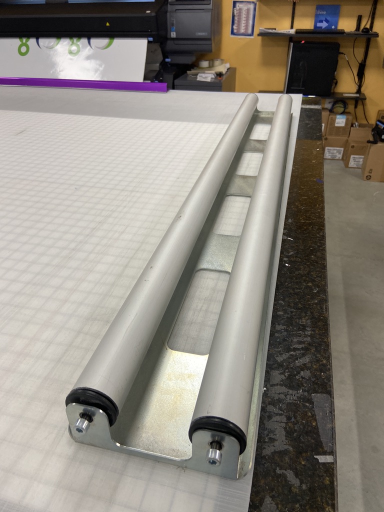

Made this with rollers from harbor freight many years ago. Made on for the house for large roll of tin foil in the kitchen.
