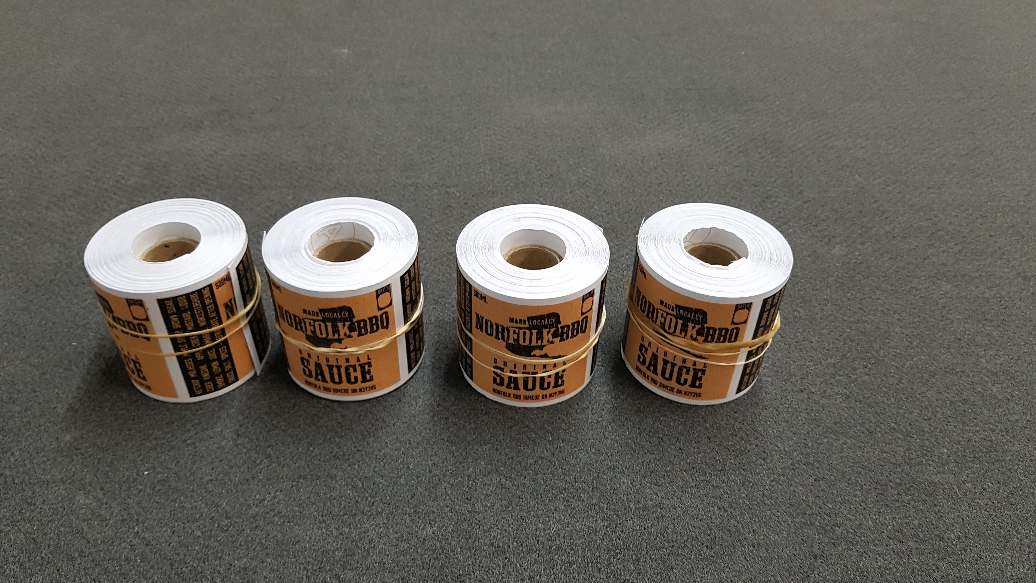

We are able to do short runs on our epson s80600, we use our summa f1612 to kiss cut the decals then cut them into long strips and splice them together and roll them up. You can make batches of 1000 or 2000 pretty easily.
Note if the client is going to be applying them by machine my method won't work, but if you are applying by machine you aren't ordering 1000 decals.

Yeah, they basically stated that if I was able to print in rolls that they'd invest in a machine but I can't justify the cost rn. Thanks!
