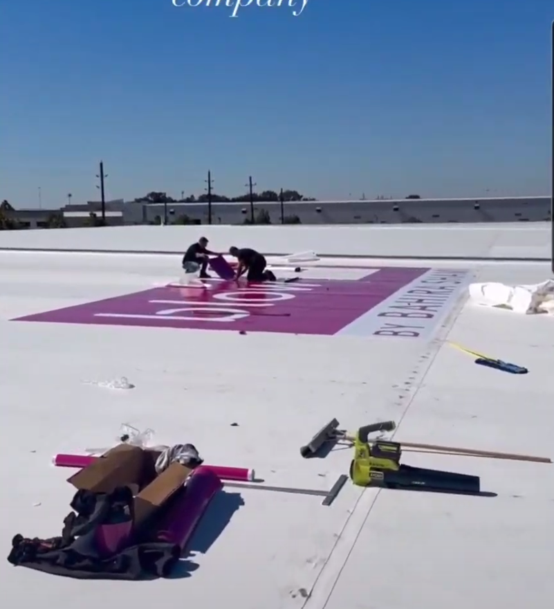

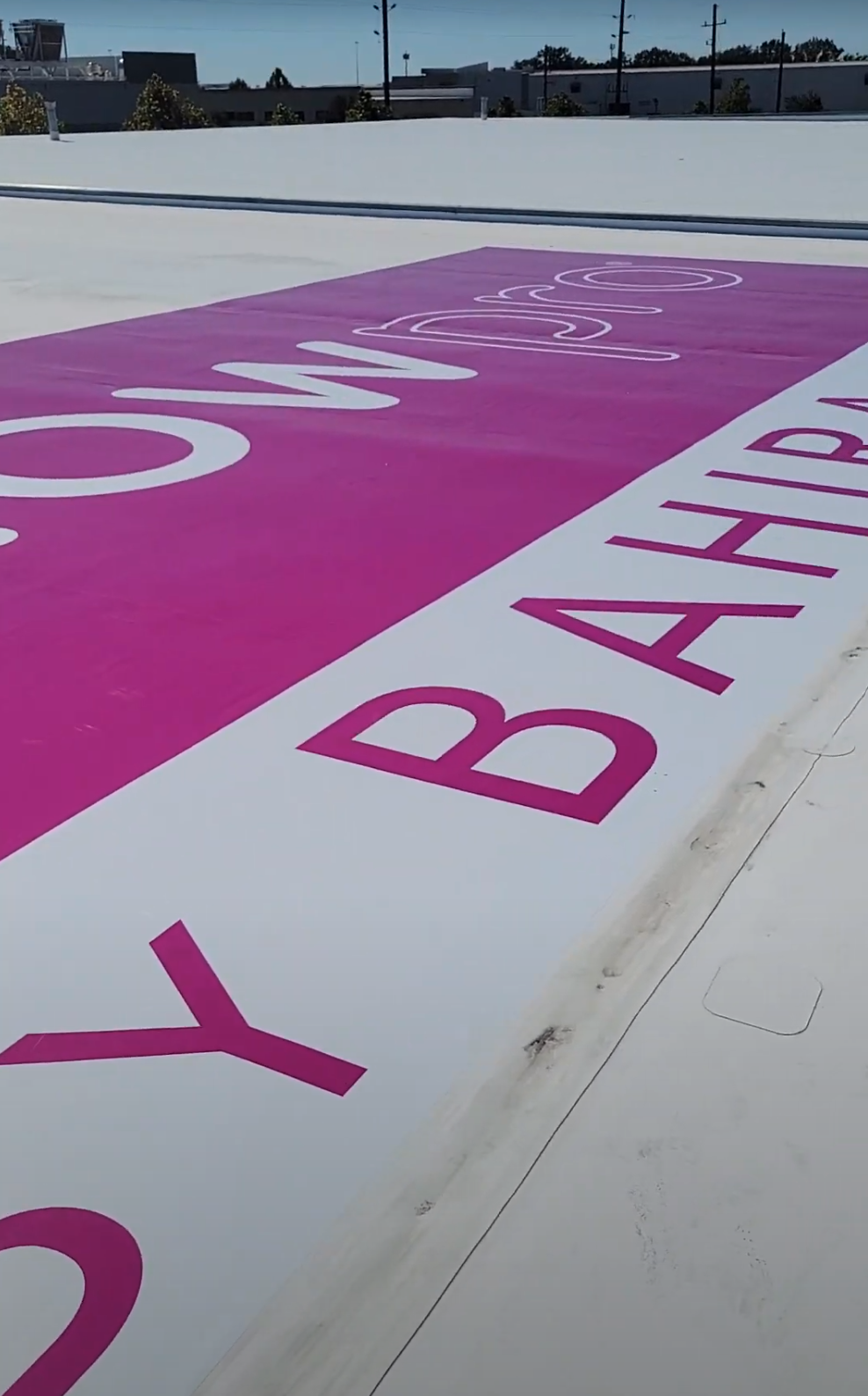

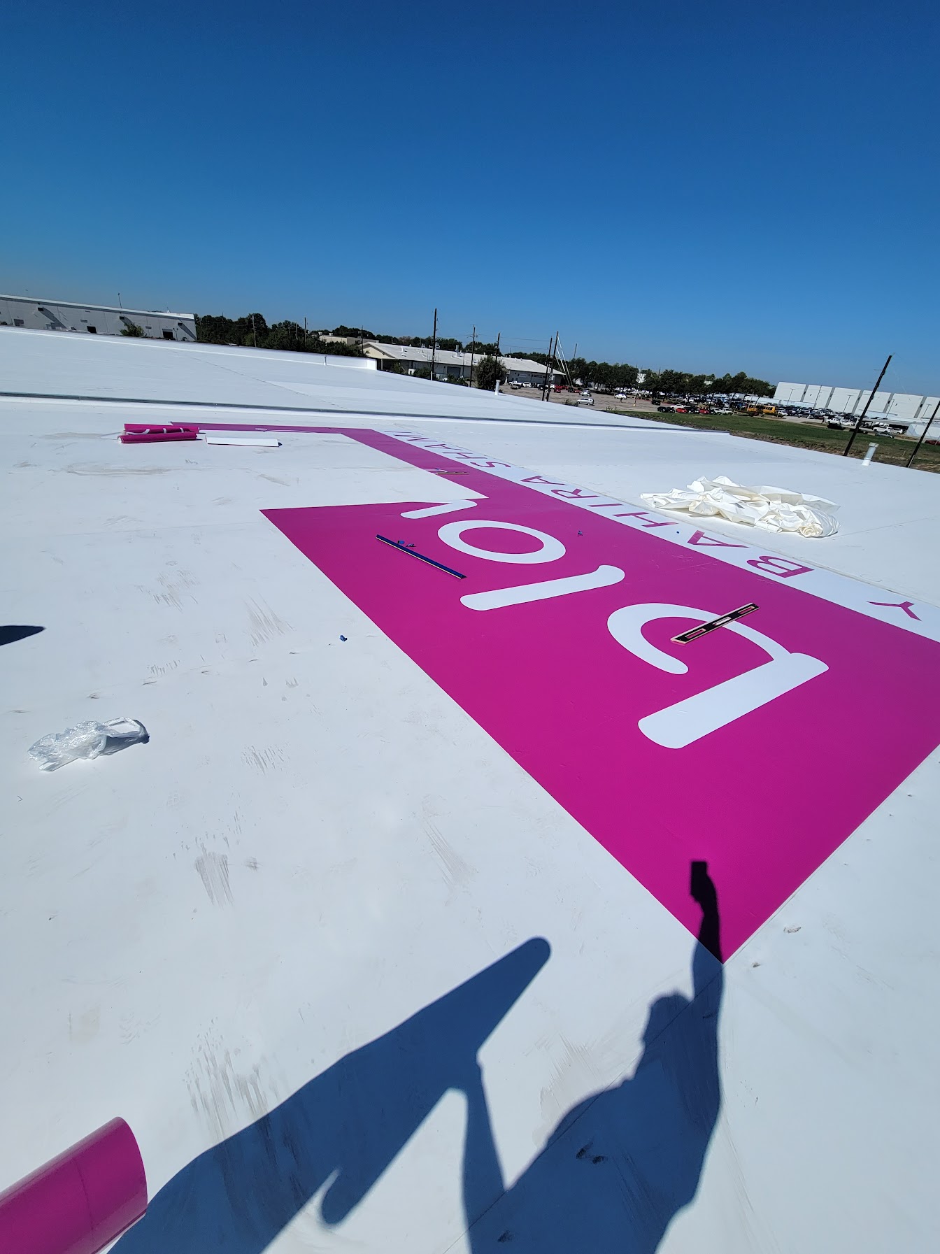

Update, got it done. Can't wait to see the drone shots
First 2 panels I did using 64" squeegee using the floor decal method. Did not work too well as the roof is not perfectly flat like a floor, lots of waves, dips, +-.5" everywhere.
Rest was done with hinge method with a 4" squeegee. Tried a 20" squeegee but still was too big for the surface variation
This is a little over 1000sq ft, little smaller than originally planned.
Install took 5 hrs start to finish, has to be the sorerest I have ever been crawling on my knees for 5 hrs, luckily the roof was soft like built in kneepads, I brough knee pads but did not use.
Planes flying by 200 yards away every 5 min. IAH airport.
couple of wind gusts almost ruined a few panels
Hoping to get some more work like this, was fun.
