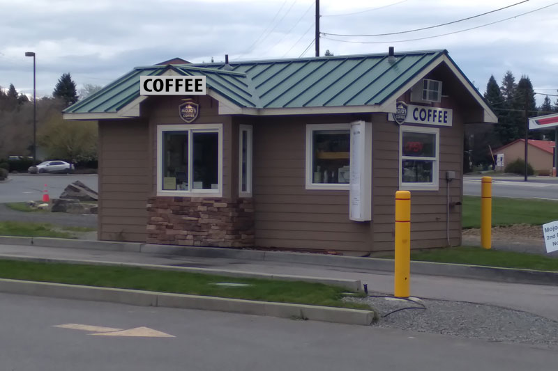

I have a customer wanting roof mounted dimensional letters for a small coffee stand, see pic. Just the word "COFFEE". What materials are good for this type of signage and how would it be installed? I know Gemini offers cut metal letters on a bottom rail mount, but I don't know if that would work on a pitched roof like this. The customer is handling the permit and install, they just want the letters (and maybe mounting hardware, if it's something I can supply).

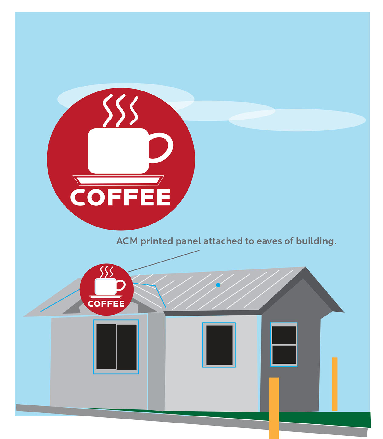

I might offer an alternative of a flat panel sign that can be fastened to angled brackets attached to the roof, might be easier and more cost effective for a small business starting out.
I generally steer away from these kind of jobs. Too many holes will be needed to make the sign secure and you can many times figure the owner will blame you for any leaks in the future.
and with the wind gusts we've had in these parts just in the past couple of weeks.... they will likely topple right over and could possibly kill someone.

Thanks for the replies. I told my customer I don't want to spend time quoting it until she checks with the Planning dept of that city, to see if it's even permitted. The business is an hour away from me in another county. Now I think I shall say "Pass".
Almost better directing the customer to the roofer's warranty.
Talk her into setting two poles and stretching a banner over the building if she wants letters above.
For individual letters Aluminum is best because it wont crack and break but your mountings and bolt mollies in the wall must be correct and really sure. Any letter blown off in a strong wind becomes a deadly weapon. That's why I prefer a one piece sign. You can mimic the wall for the background to make it look like is 3-d on the wall. but the advantage is all the bolts support the whole thing so its got a lot holding it on.
Ryze Signs
I would mount it with solar panel brackets. They are designed to be water tight. Put in two rows and build a frame between them to mount the letters to at the correct angle.
John Miller
First, if designed correctly the sign won't blow off the roof. Second, as someone has already stated, roof signs that project above the roof line are not permitted in most areas. Third,
a sign is a dynamic load, meaning wind will make it move, (even an 1/8") jiggling back and forth will eventually open up a leak in the roof so all attachment points need to be liberally sealed with something that doesn't get rock solid. Black Jack roofing calk over silicone is a good solution. If your client is installing, all you can do is educate them as well as you can and let them proceed. If they own the building, fine if they rent, the landlord may put the kabash on the whole idea. I wouldn't supply a mounting structure if others will be installing.
If something goes South you could be held accountable.
DL Signs
Never go against the family
I'd talk em' into keeping it off the actual roof, do something on the end of the overhang above the window like this. It would be about the same size as the "coffee" part on the end wall, nice solid end truss to mount to, and not stick out far enough where wind will do anything. Since it's an overhang soffit, no chance of leaks into the building, not on a roof slope, so no debris, ice or snow can dam up behind it. They could go plain old solid panel, channels on raceways, even lighted if they have the budget. Just a thought anyway.

There is no budget, as usual. This one has already gone back and forth in discussion to the point where I'm not getting a warm fuzzy anything. I told the customer her request probably won't be permitted by the city, and the response was "my agent said the city doesn't care about signs and we can do whatever we want". LOL, okay. NEVER TRUST THE AGENT.
