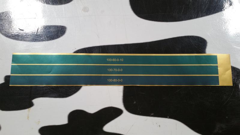

Because to get a rose gold color it would be easier to start with a gold base verses a silver base.... its actually a super simple process on a gold vinyl.
Here is an example of what we did for a aqua gold.

Just as easy, if not easier, to do on silver. Remember that white point? I've been printing gold leaf in all of it's variations and tints on silver for years. Try it some time, you might be surprised.

Either method works so its up to the person printing.
We just start with a base that is most like the finished look and tweak from there. With the NIX sensor we just got it make the process much faster since we can measure the base make up.
