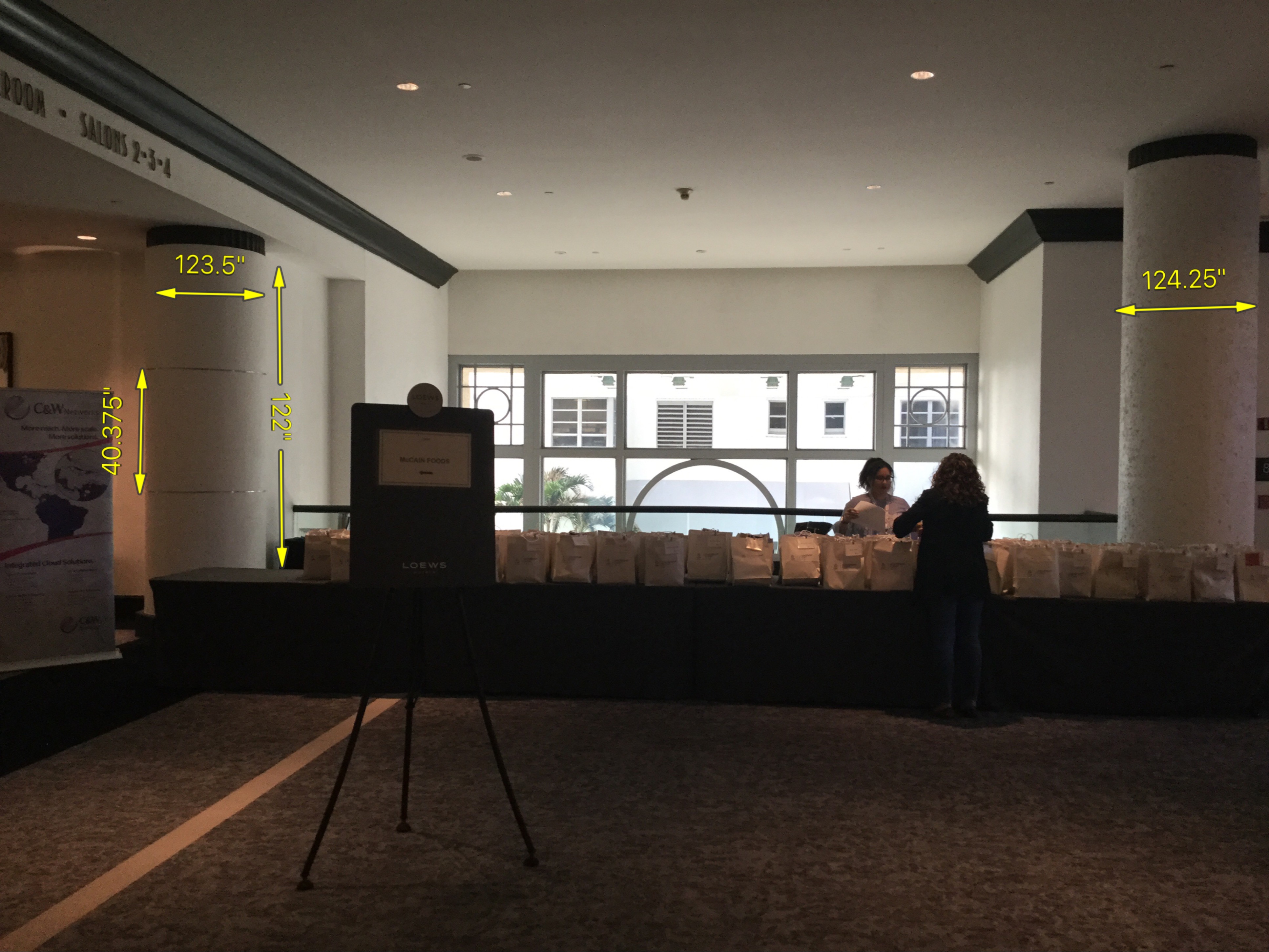

We need to produce some graphics for some round columns. Circumference is 123.5". This is for a 2 day event and ideally we would prefer using double sided tape over velcro. Should we make the banner slightly smaller in order to be able to stretch thought? or keep at exact size?

You need to either go an inch shorter (tie wraps) or two or three inches longer(double sided tape). I'd trust the tie wraps more than the tape, not to mention an easier take down. Just have to be careful and not over tighten as it will cause wrinkles. Which is why hook and loop would be best. Adhesive backed hook and loop isn't that expense. I think we charge like $1.50 a foot to install.
