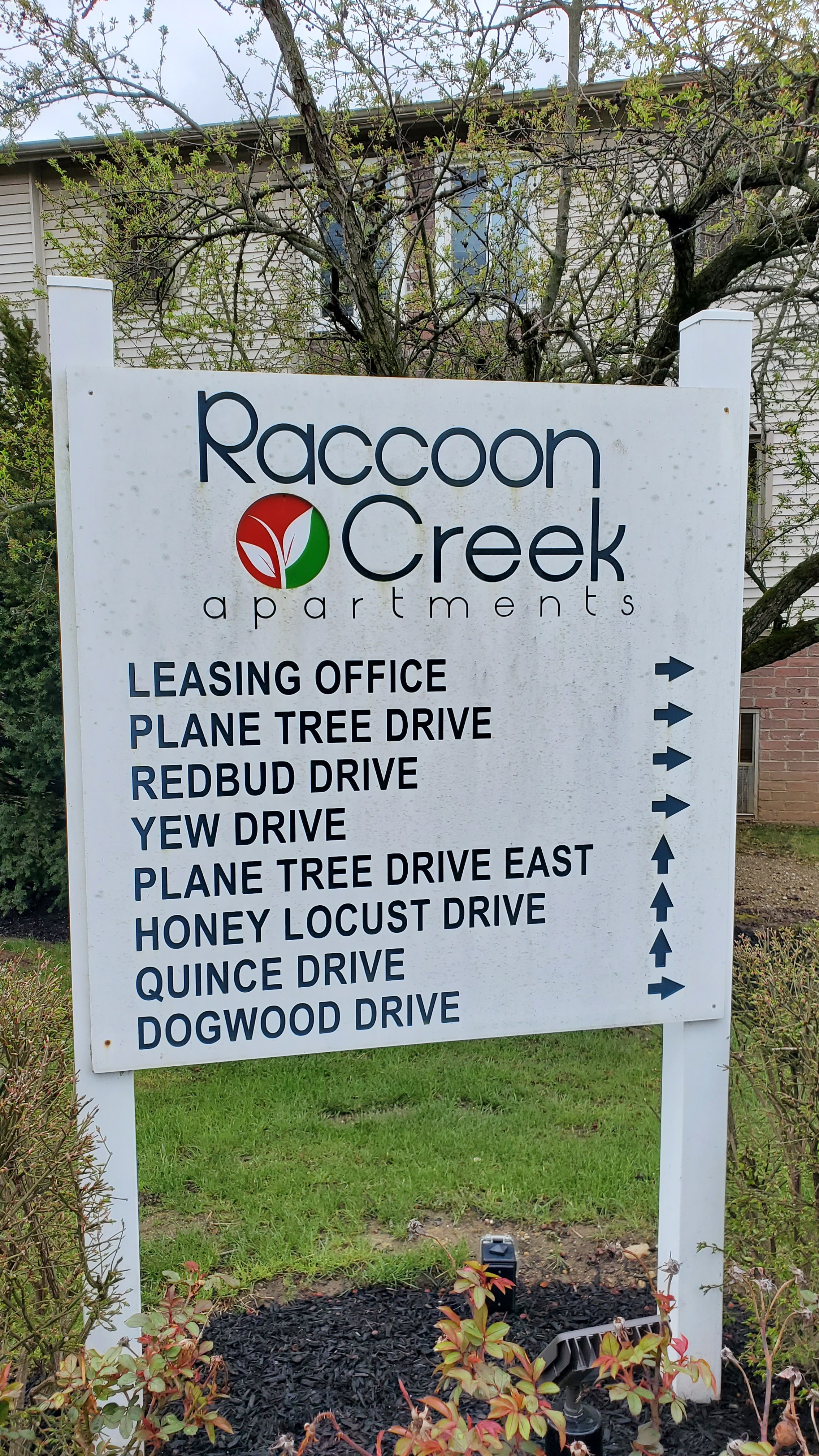

I know it is not an optimal solution, but I am trying to match some existing signs that are made from 3/4" PVC, with text that has been routed and then painted. Does anyone know of a supplier that can do something like this?
rossmosh
Anyone that does dimensional sign work will be able to do it. It's a pretty straight forward job. You just need to talk to them to make sure they're going to use a small bit. My guess is you'll need to use a 1/8" or 3/16" bit to do that work. Some shops won't have bits that small.
