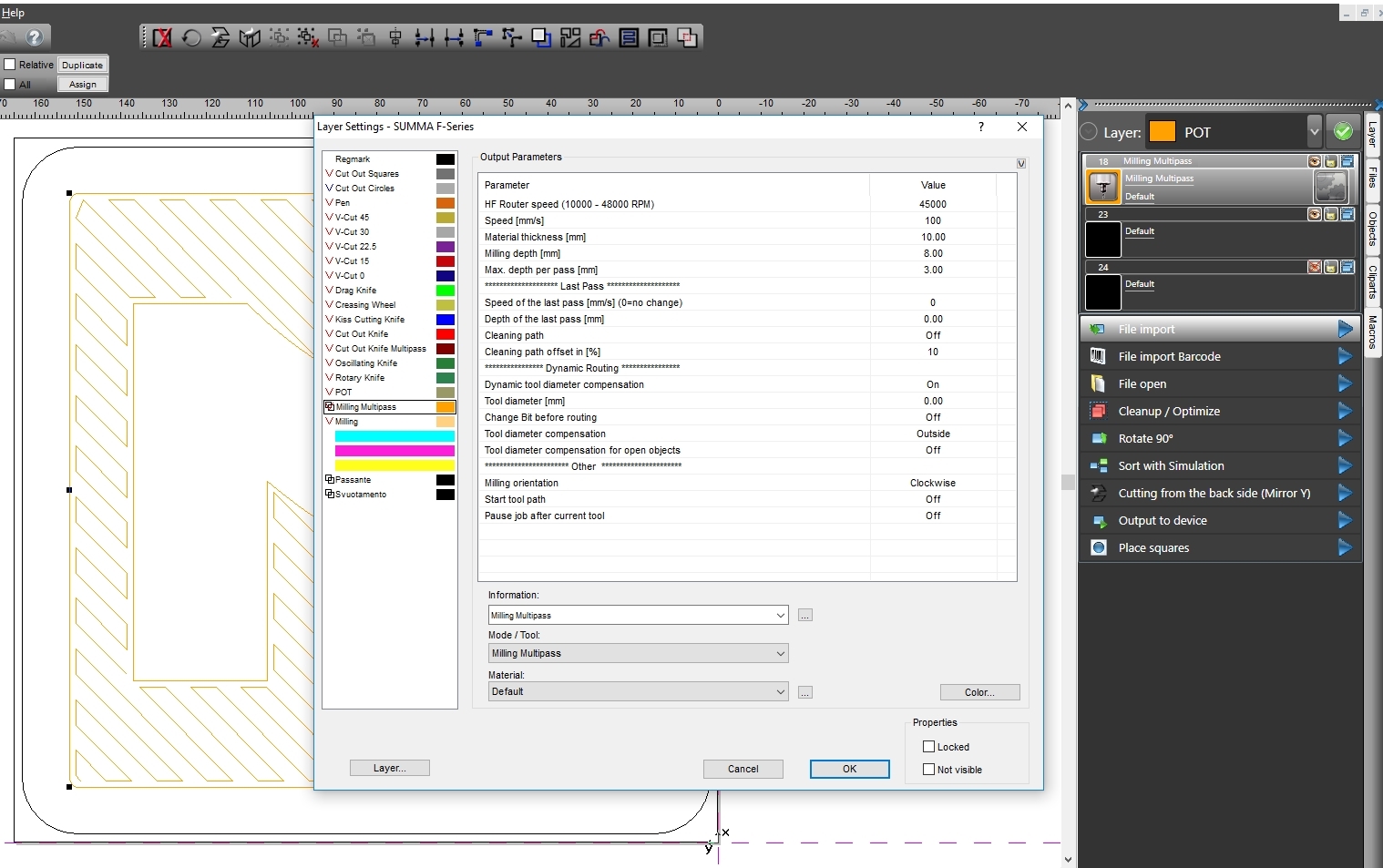

For those with a Summa F, how do you adjust the routing depth in SummaFlex Pro when setting up fills to do doing embossing? I know how to do it for just cutting, but can’t find it when doing a fill.
jerry369
In the Milling Multipass parameters set the right "Material Thickness" and the desired "Milling Depth" option as shows in the attached image
