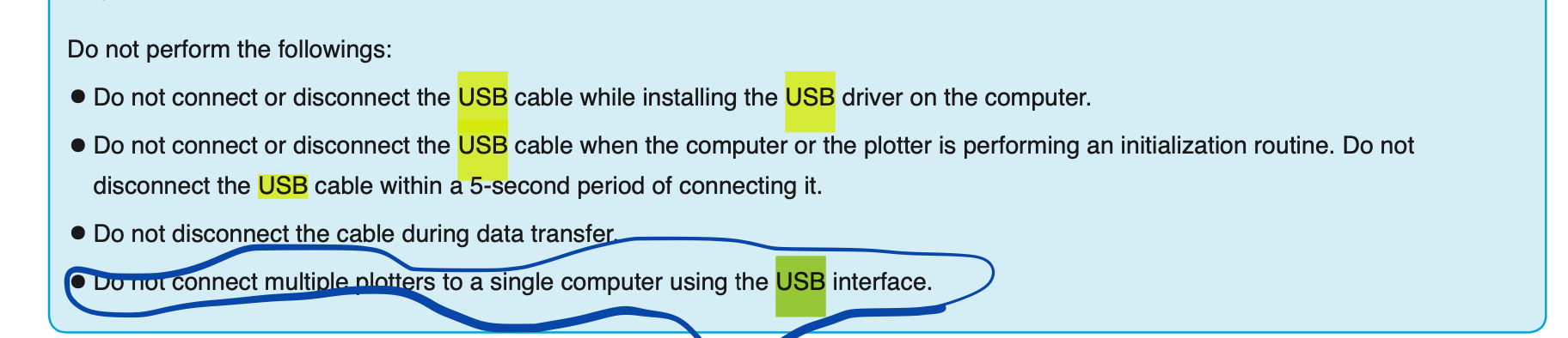

I'm running three machines (FC9000, two FCX2000) on CM4 from one machine. Not having any problems that aren't self inflicted (picking the wrong machine from the dropdown). I do run them on a network though, which I understand to be much more reliable than via USB. You might try switching to ethernet.

What you might have are 3 different printers set up.. Two with the same name and one with the same usb com port settings as the first printer. It often happens if the USB cable has been removed at some point and the pc has allocated it a different com port.
Check the port settings in all the printers connected. They should all be different.
