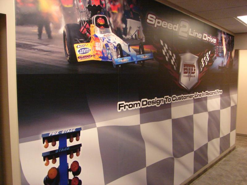

the material is Oracal 3268, removable wall vinyl. the demension is 104"x223" it was installed an a basically smooth painted sheetrock wall. It is on both walls of a hallway. we left about 2" all around from edge of wall and ceilling/floor. We printed full color on mimaki jv3, gassed out for 3 days. adn laminated with oracal 210 matte lam. we go to do the install and goes good. after a few panels we notice the tops and bottom are curling off the wall. but not the vertical edges. when we applyed we center hinged and worked center up then center down. It was wierd that only top and bottom were a problem. we installed all the graphics then came back with a 1" strip of 210m lam and went half on graphic and half on wall, seened to fix the problem. Question is has this happened to others? My only thought would have been to leave 1" or so of white around the print? Would this help any other steps you do to do wall graphics.
I don't have any pics of the curling, we fixed problem then came back with a camera.

Your install looks great except for those wicked wrinkles you got in the bottom...couldn't you have fixed that??
