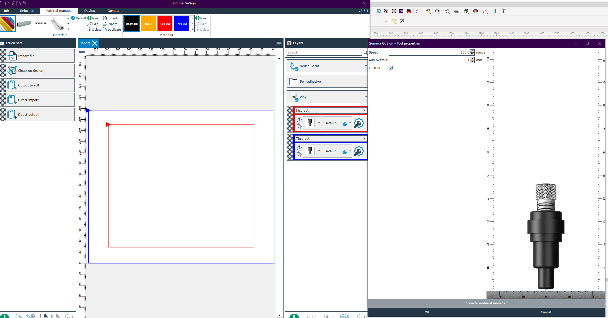

Is there a way to use different blade strengths with GoSign in one pass, for example 50g kiss cut and then directly a 150g die cut 10mm offset? Unfortunately, I have not found a function for this.

Need to setup a kiss cut and thru cut path separately or you can skip the kiss cut and use the cut line as a thru cut. You do it in gosign
SLShop
Is there no way to adjust the cutting depth in gosign?

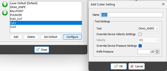

that is not true. can setup different pressure and speed for each kind of cuts in GoSign in one single job.
How about Selecting FlexCut for the for the Thru Cut. and on summa Cutter Control changing both Full and Flex pressure to high
