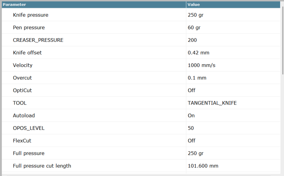

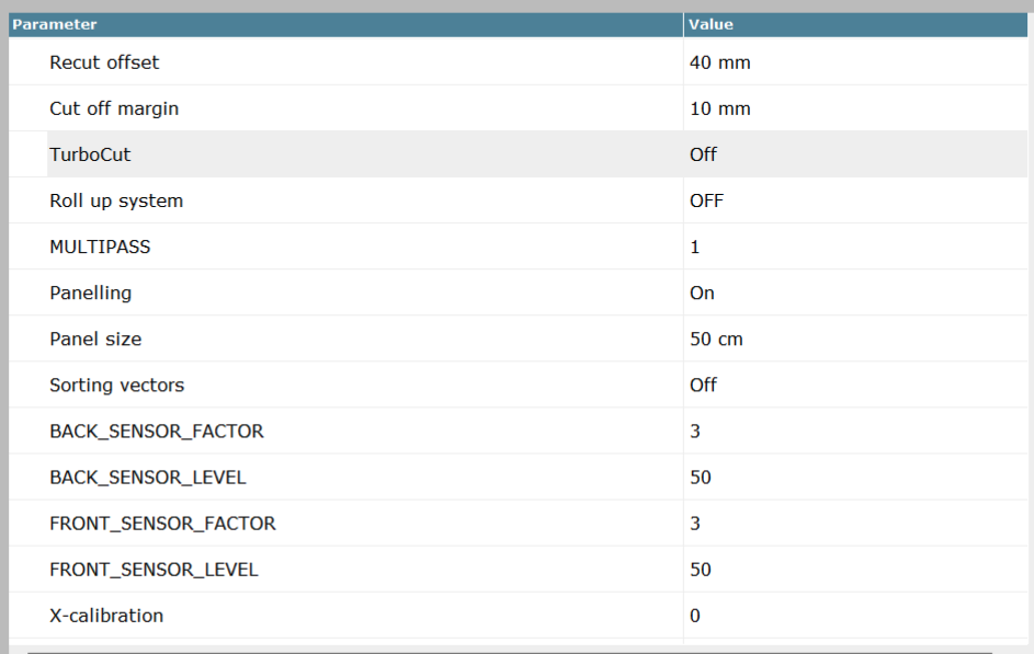

The Cutter Control module has
Paneling: OFF
Panel Size: 50cm
Sorting Vectors: Off
(Options for Sorting is Off, Directional, Start Point)
I tried all 3, with no change to completing the shape.

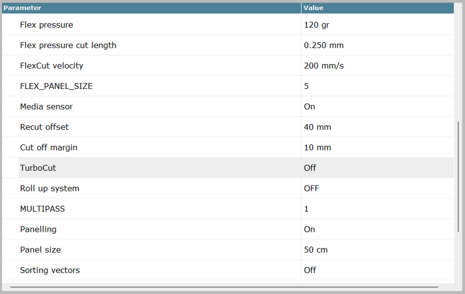

You can increase FlexCut panel size
GoSign automatically turns on FlexCut panelling. S3 firmware uses 2 different panelling sizes, one for Flexcut and one for all the rest.
Flexcut panelling size can be set in FlexCut panel on the plotter
