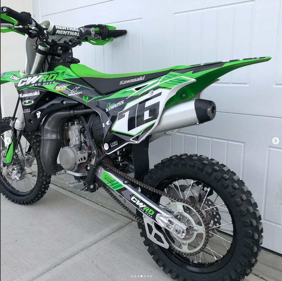

Thank you very much for the info. That's great to hear. The Kawi's I've been able to get really close with the Roland so I'm sure I'll have no issue there on the Epson but I've always hated doing Honda's as I could never match it close enough for my own satisfaction. Customers have been happy but I wasn't.

I have an order waiting to be confirmed to print K green in the next week or so. I'll take a photo if I remember so you can see what we're outputting.

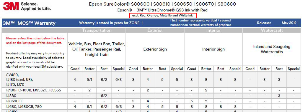

YES. The additional inks fade a whole lot faster. Different pigments used and are NOT warranted against fading by anyone.
The 3M MCS (Matched Component System) expressly excludes GS3 Red, Orange, White, and Metallic inks from any warranty (see attached).

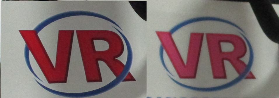

This fade was after a year using an Epson 70670 with all inks in the profile. We started noticing fading and Epson just said "sorry our inks are not warranted for any certain period" and left us high and dry.
I believe the newer 80600 inks are "better" but I sure as heck am not going to trust them any time soon.
We adhere to (and are certified through) the 3M MCS system for our printers/inks/vinyl now.

Hi, there are profiles available from 3M for Onyx for the 80600 that deliver MCS warranty. They do not use red or orange.
