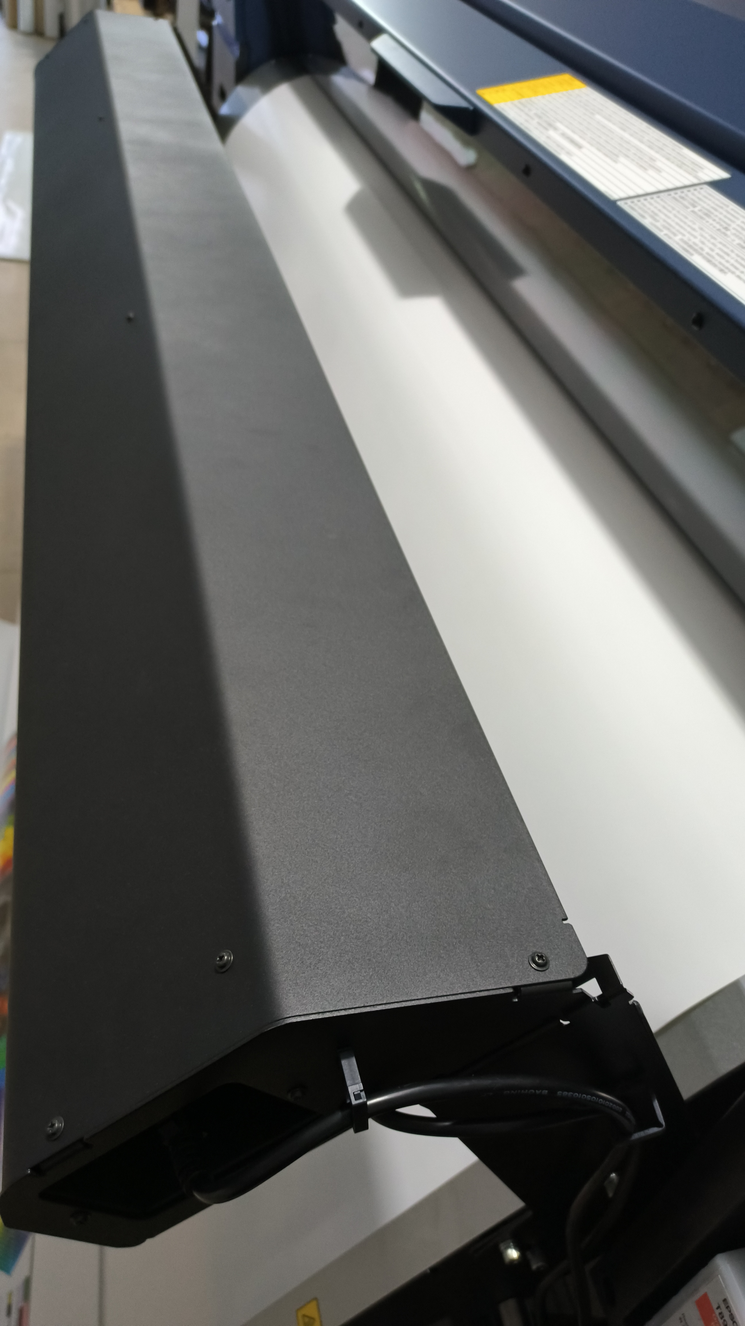

s80600 My dryer can start automatically, but it keeps spinning and won't stop when the print job is done , how do I get the dryer to turn off automatically when it's done printing?

Huh? The s80600 is pretty much auto everything... Even cleaning until it asks you to manually clean it. The "dryer" is what exactly? The heat on the platen? Are you saying that it never shuts off?

It's this one.
Try to enter the "Media Setup" menu and go to "Customize Settings". In the "Advanced Settings" -> "Heating & Drying" -> "Additional Dryer" section you can decide if the additional dryer should be turned on or off for that specific media. So please repeteat the procedure for all your other medias where you would like this to be used.
I think the unit should be called "fan", as it provides no additional heat at all :) (But it does increase the general air flow on the media, causing the eco solvents to evaporate faster)
