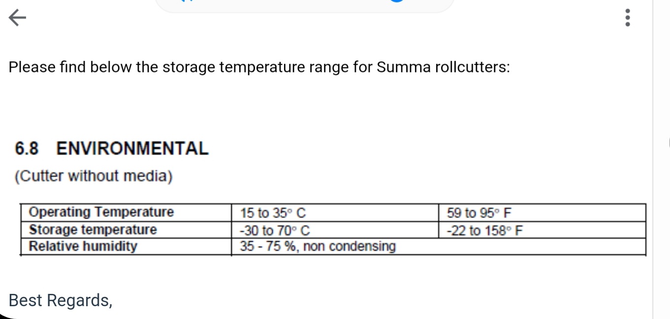

I'm interested to find out safe temps for storing business related sign equipment such as.....vinyl, mask, plotters, lap tops, printers, etc.
We got a heat wave going on out west right now, as you know.
Triple digits here in Arizona land.
I suspect that paper mask is the most sensitive to heat. It's my guess, that vinyl is much more resilient.
I contacted Summa about plotter storage. I was pleasantly surprised to learn that my 30 Inch d75 and all other Summa plotters are practically temperature proof. It's safe up to 158 f. See attachment
