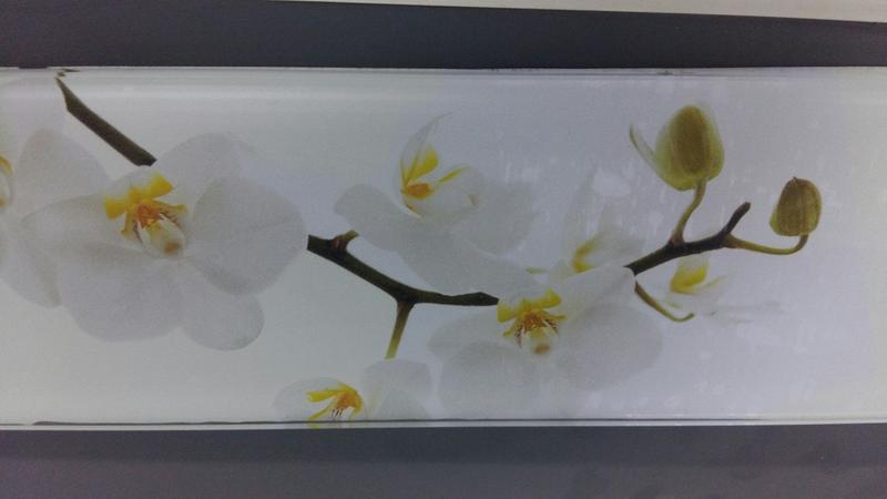

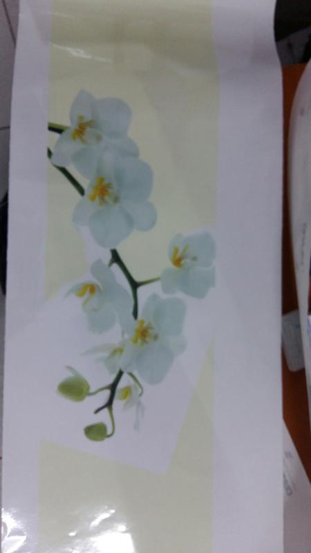

Hey guys, i have this roland sp-540i that i print on and friday i had this sample to print but on monday i wanted to print a sample from final artwork to see how it goes. After the print has finished i noticed that there is a color difference between the sample from friday and the sample from monday so i printed again the same sample from friday and here it comes. The print job from friday ( no modifications to settings or anything) i've printed it on monday and the color output wasn't the same. I changed all the settings again and again samples over samples but without luck.
For the final artwork i can say that i did some color changes or something like that but what about the job printed on frinday and monday same job reprinted and different colors... ? :D

I'm kind of lost how it can be exactly the same job when the image is flopped.
From the looks of it to me, something somewhere has been altered. That is not the kind of change you're going to see from humidity, or temperature, or ink settling over a weekend, or from using non-OEM ink (unless you changed ink over the weekend.) Something pretty significant has been altered from one of those prints to the other. If I had to hazard a guess, I'd say the portrait length example has a wrong incoming color space assigned to it... but it could be just about anything.

Dunno what to say .. i only hit print. and the image was the same but one is already on a glass and the other one still on support.
