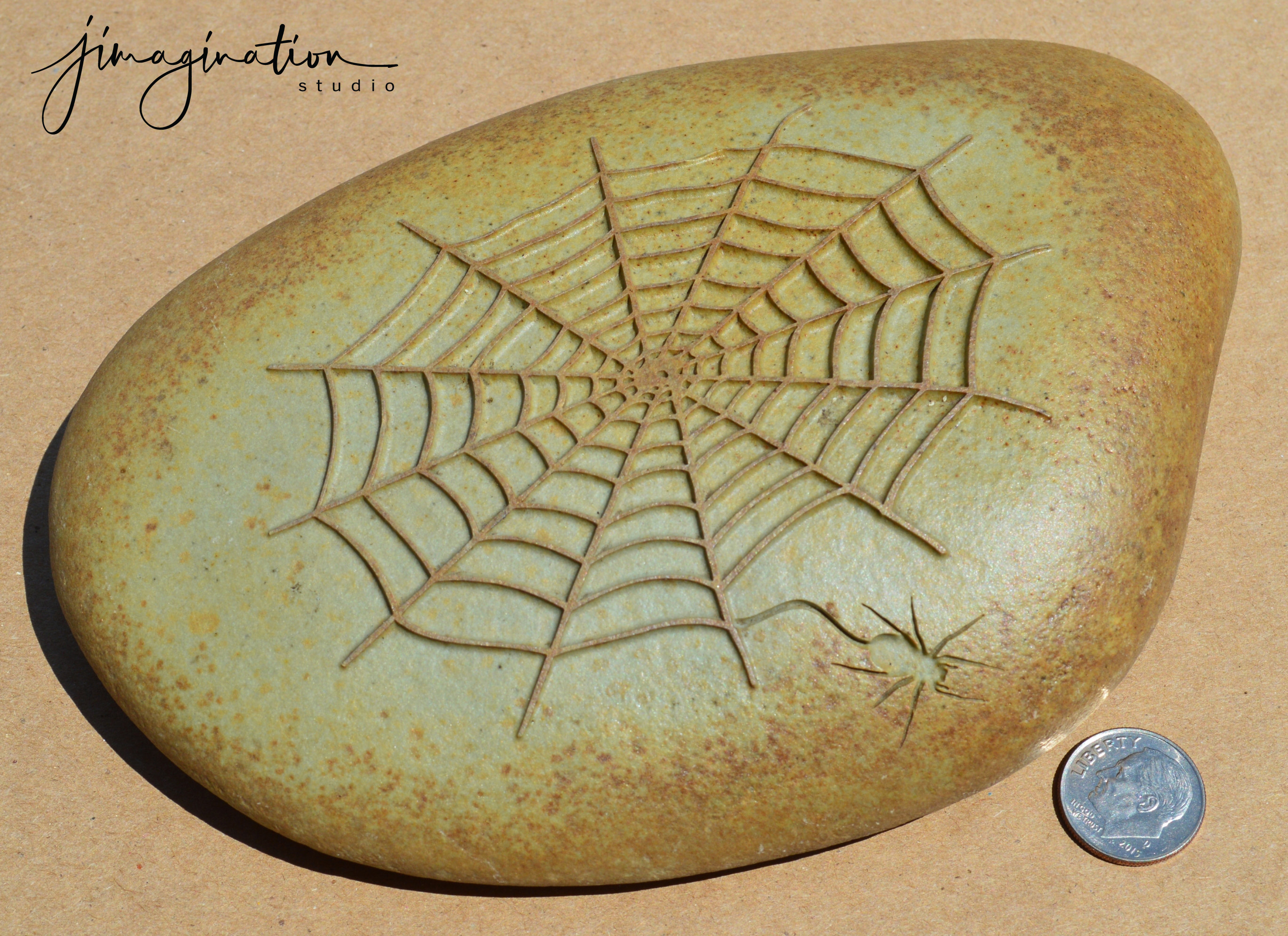

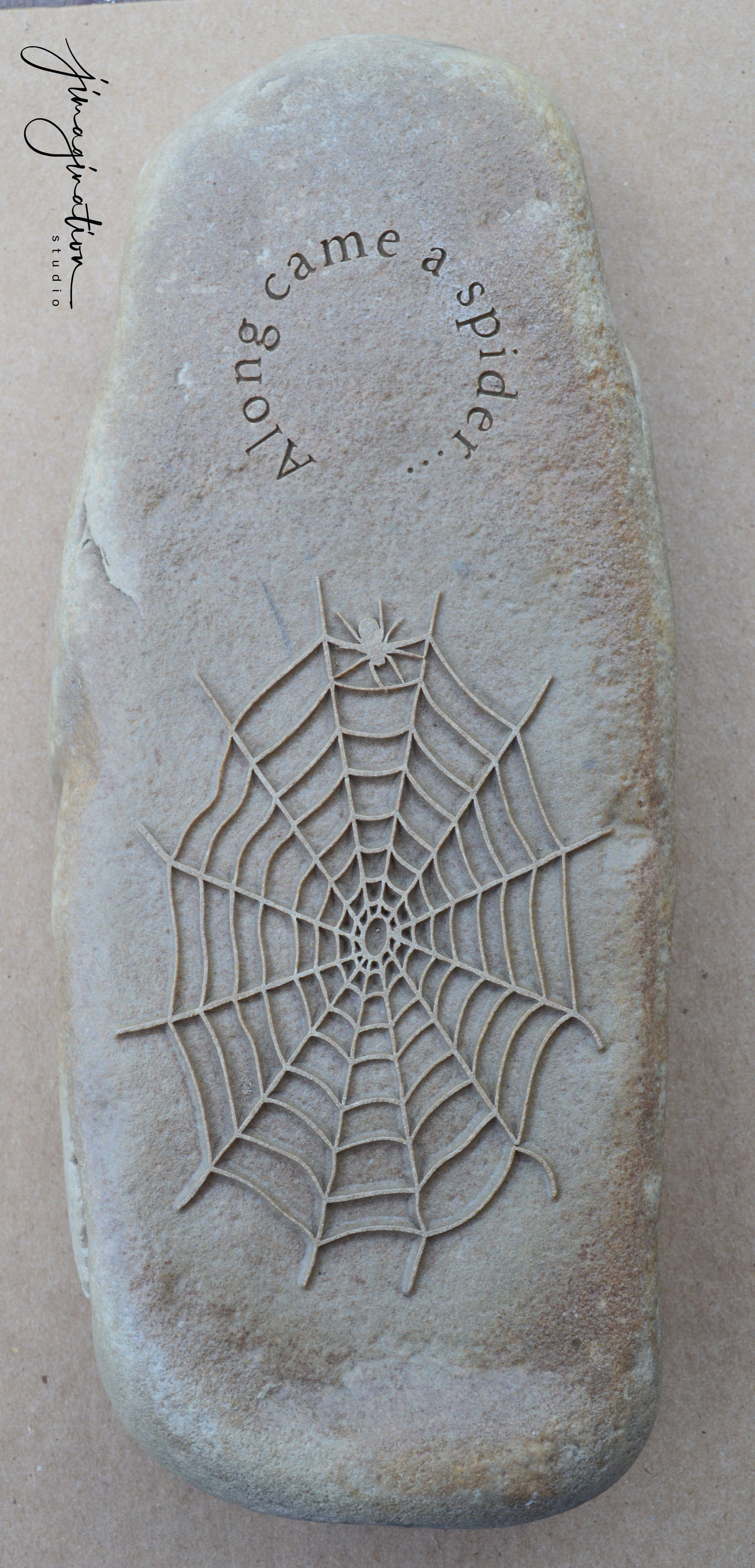

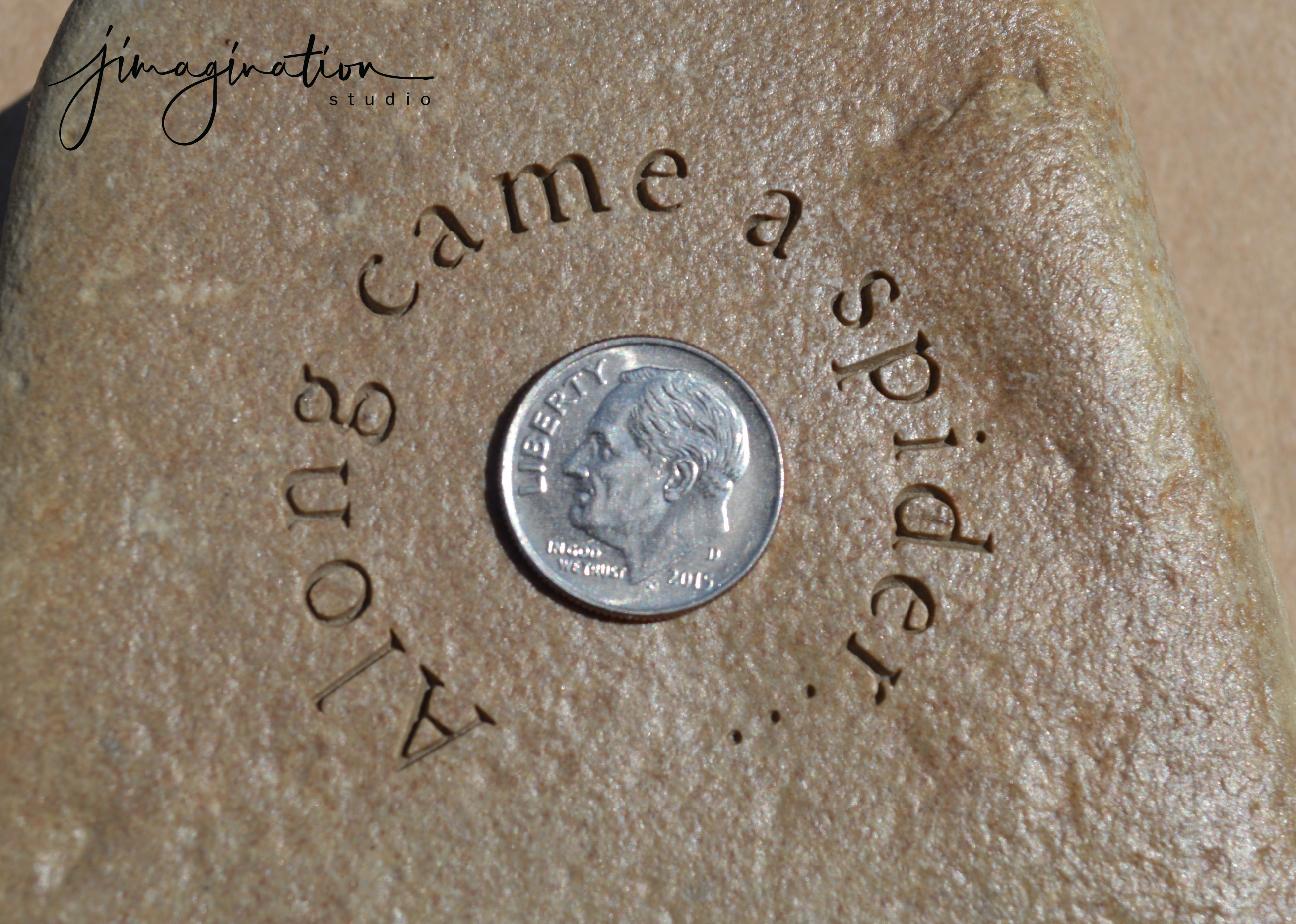

I've posted the attached photos before, and they have nothing to do with the subject at hand. But they're are an example of how sandcarving can be used to create a fine reverse etch (raised image).
These were done using sign vinyl for sand mask. And while sign vinyl might work well for your lettering, you're going to have a difficult time keeping the braille dots from moving while weeding the vinyl.
