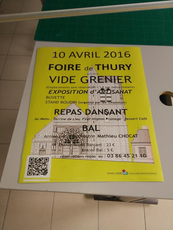

original print :
attachment.php

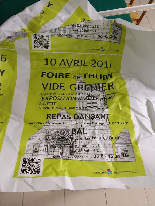

after one day try to reprint the same file :
attachment.php

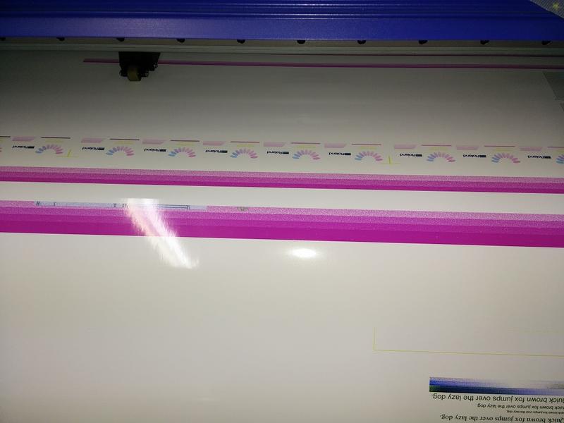

After clean head and pump up (yellow is full magenta):
attachment.php

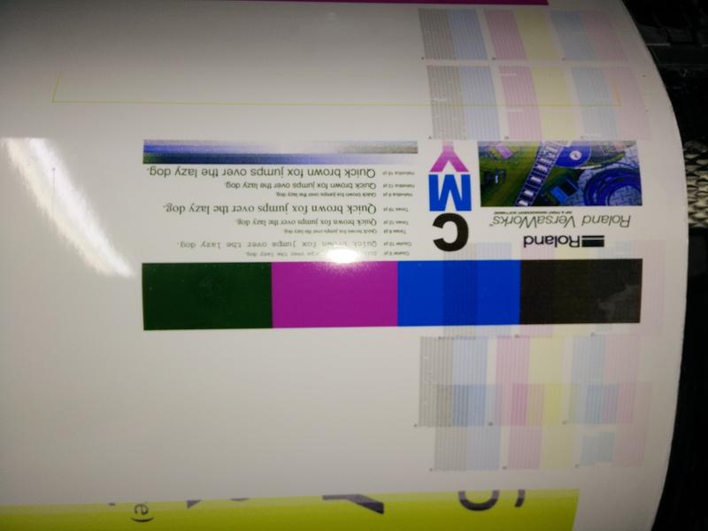

original file from roland :
attachment.php
We can see C is black instead of Cyan,M is Cyan instead of magenta Y is magenta instead of Yellow etc..

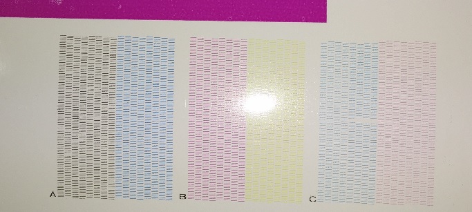

Test print :
attachment.php
the place of color hasn't switch after problem.

I am confused. What was changed to make the colors change order? So your nozzle check is identical to how it was before the problem appeared?
