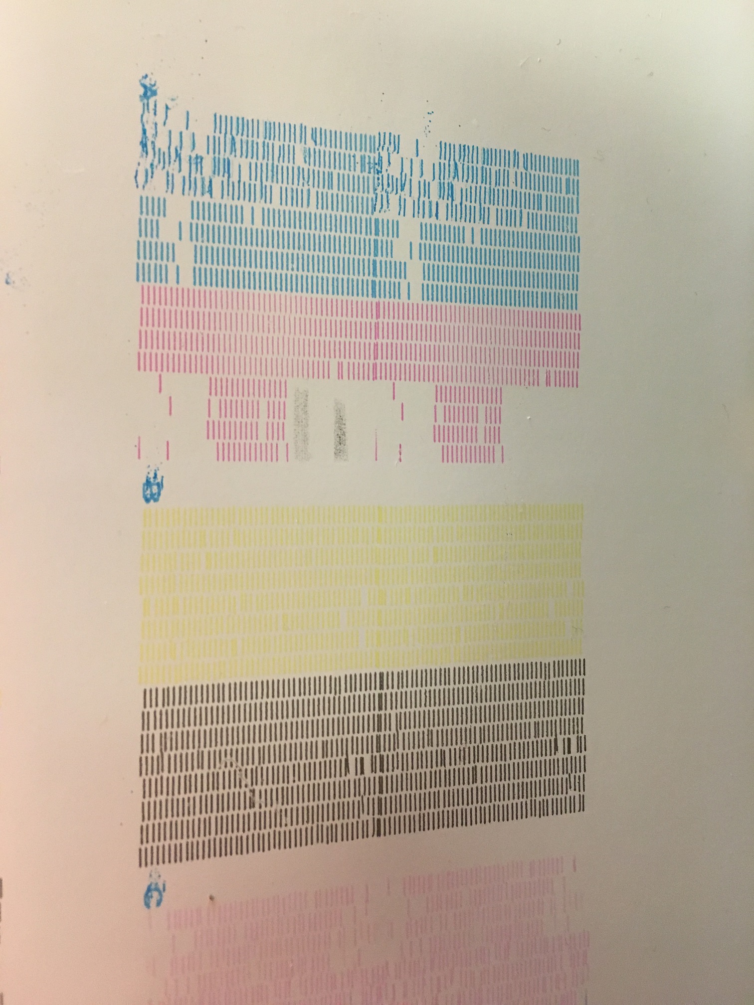

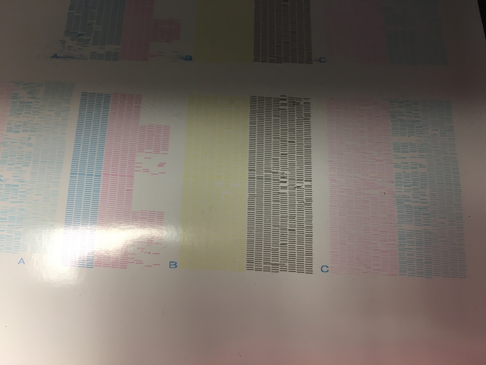

I have also posted pictures of test prints that show serious drop outs. however, my group c issues have been like this since I've owned this business in July of last year, yet not having these print problems.
I've cleaned both automatically within the printer and manually. I'm very careful to only dab the print heads with roland cleaning solution. Any thoughts would be appreciated.

Thats some serious overspray. Nozzle patterns look like ink supply issues, since it's moving around i'd guess the caps not sealing, either from cap failure, or cap misalignment.
Overspray is hard to see from the pic, but looks more static than deflection given how long the trails run off. I've never been a fan of printing on magnetic, i'd rather print on vinyl then apply it to magnetic than drag that heavy stuff through a printer.
Hey Hogwild16,
Ragnabrok is on the right track, the problem could be caused by static (environmental and/or media buildup), the caps not sealing the heads well (creating deflection with dried ink), etc. All of the symptoms justify contacting an authorized Roland dealership to have them help and repair the printer. Please contact your dealer and they'll take care of you.
