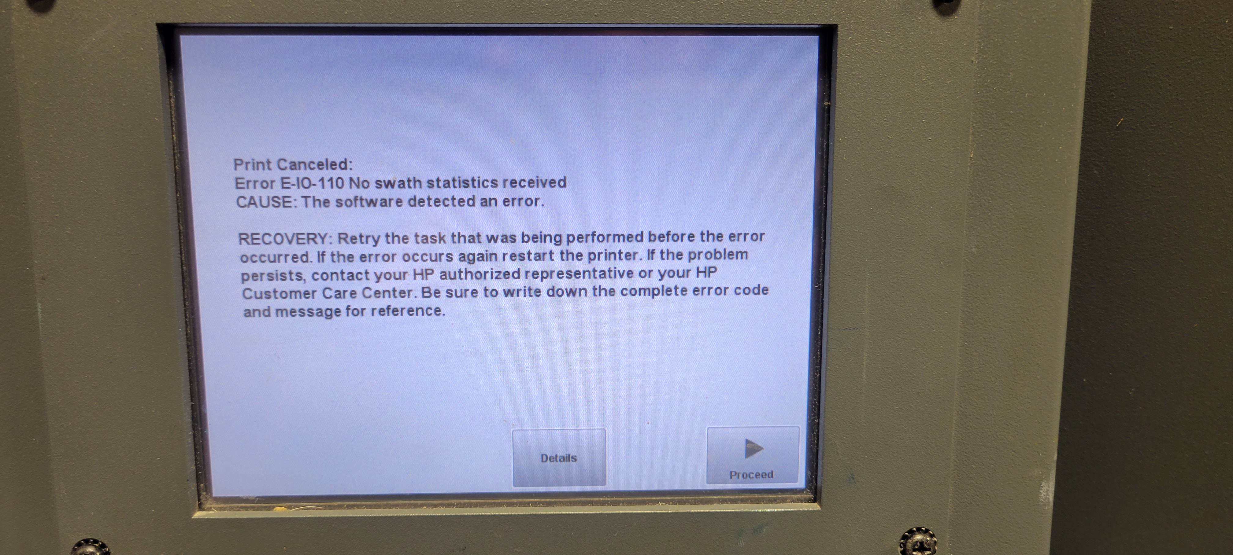

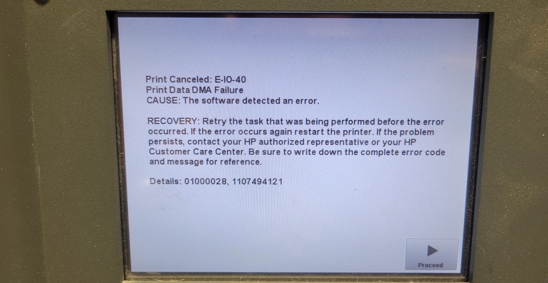

The exact error code would be interesting. A DMA-Error is an internal communication error, for example between mainboard and head board.
Here is an image of both the DMA and Swatch Errors I have gotten.

E-IO-40 is an encoder error. Check the linear encoder for dirt oder damage. If anything is ok with the encoder, it could be the cabling to the I/O-board or the board itself.
E-IO-110 regards to faulty data from the encoder too. Suggestions are - in addition to clean the encoder - replacing the encoder reader, headboard, I/O board.
At first I would really check if the encoder is ok or not.

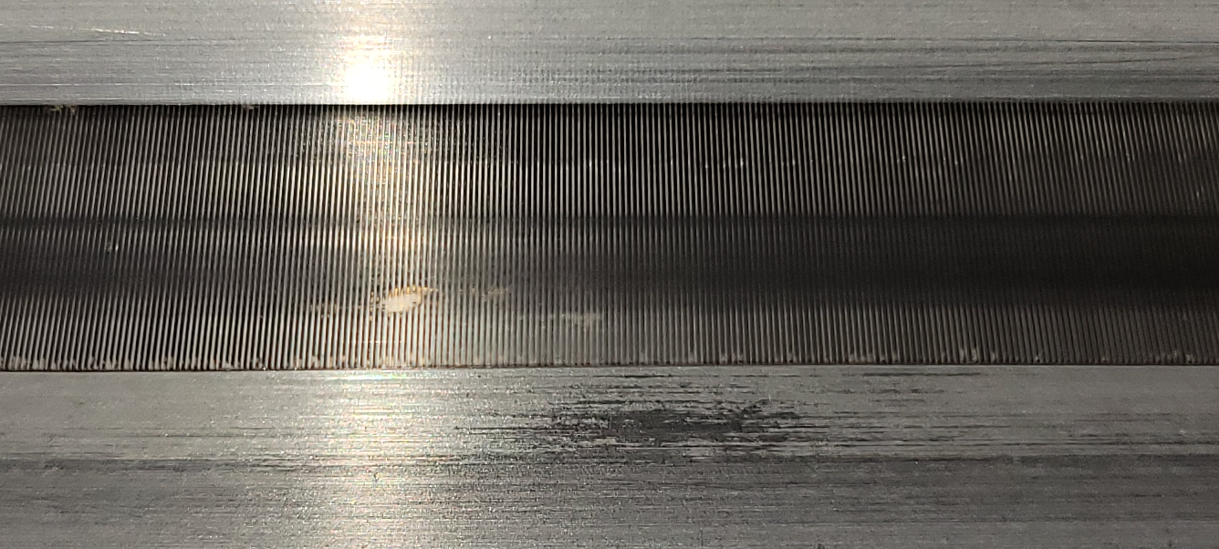

Check the encoder with light. there are little lines printed on it in a high frequence: perhaps to much "cleaning" can rub that lines from the plastic.
This is the only spot I see on the encoder strip and it isn't very large. There are no bends or tears in it at all.

I am a tech and 9times out of 10 it is a damage encoder strip or dirty encoder sensor this is the first two things that needs to be done. If you start with motors and boards it will be very expensive and you will be very desappointed.
